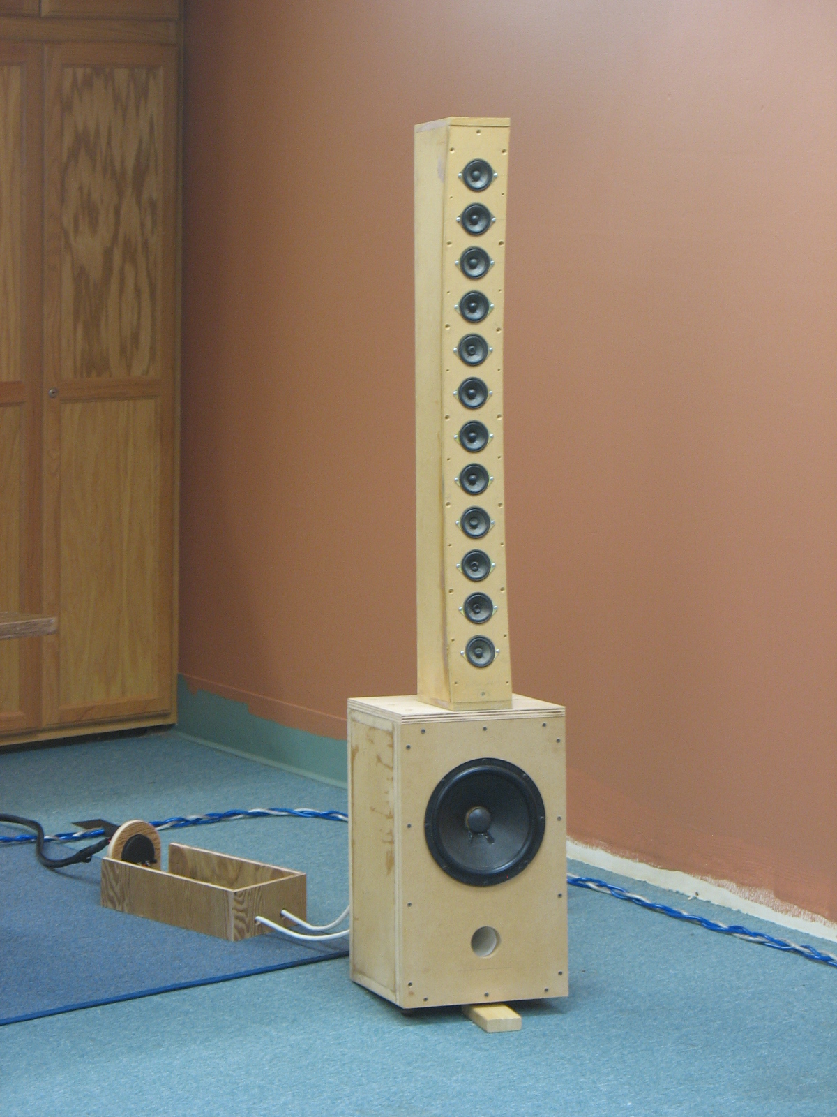

With the talk of power tapering, bessel arrays, etc., being too difficult for me to understand I simply went the other way with a focused array. Actually, I built the array itself about 13 or 14 years ago and finally built a bass module earlier this spring. Very flat in-room frequency response from 33 Hz to about 17+ kHz or so.

Interesting, what drivers did you use?
/Forsman
The small (approx. 1.5 inch) shielded fullrange drivers were a Radio Shack close out and the woofer is an Adire AV8 woofer (also shielded). They use a series crossover @ 450 Hz.
BTW: I have around $81.00 invested altogether.
It took 1st place in the 2-way class at "The Puget Sound! DIY Speaker Contest" which has a thread in the "Multiway" forum, as well as several mentions in the latest Vancouver Island DIY Fest in the "events" forum of diyAudio.

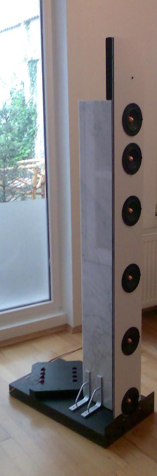

Hello David,
i use a combination of weighting by distance and
power tapering (frequency dependent) in this
project. The lower three drivers are rolled off
towards higher frequencies.
