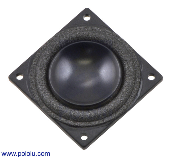

Pololu - 18mm Speaker: 4 Ohm, 2.0 W
Aurasound also lists a model NDW1425-827-4B
Buy a case, or 2. They come in quantity 2000.
Drivers like that have a great packing factor when mounted end to end. That helps push off the lobing frequency.
