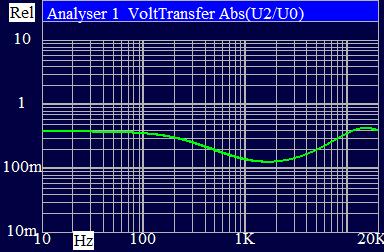

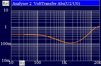

In my line array i use a combination of weighting by
driver distance and frequency dependent power tapering
for the vertical control of radiation angle.
The horizontal angle is controled by the witdh of the
open baffle relative to the drivers.
pics show the input voltage of the lower and the upper
driver trio.
Tweeters on the rear are used to compensate
falling back radiation with rising frequency
of the fullrage drivers, they move in antiphase
to maintain dipole operation >3Khz.
All compensation is done passively with very low
phase shift and smooth slope.
lower frequency limit 60-70 Hz depending on
room and position, dipole subwoofer needed.
cutoff to subwoofer -6db /octave at 80 Hz using
PLLXO.
