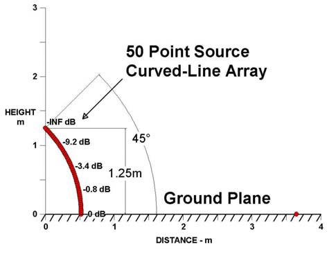

Late to the discussion here, but I just wanted to check something Audiopioneer said back in post 51:
the top drivers are at -12dB, the shading occurs in steps of 0, -3, -6, -9, -12dB with a net loss of just under 3dB for the array.
Is this in fact how DBK's demonstration array is shaded? Because that seems quite different from the model in his paper, which has labels of -0 dB, -0.8 dB, -3.4 dB and -9.2dB and -Inf dB.

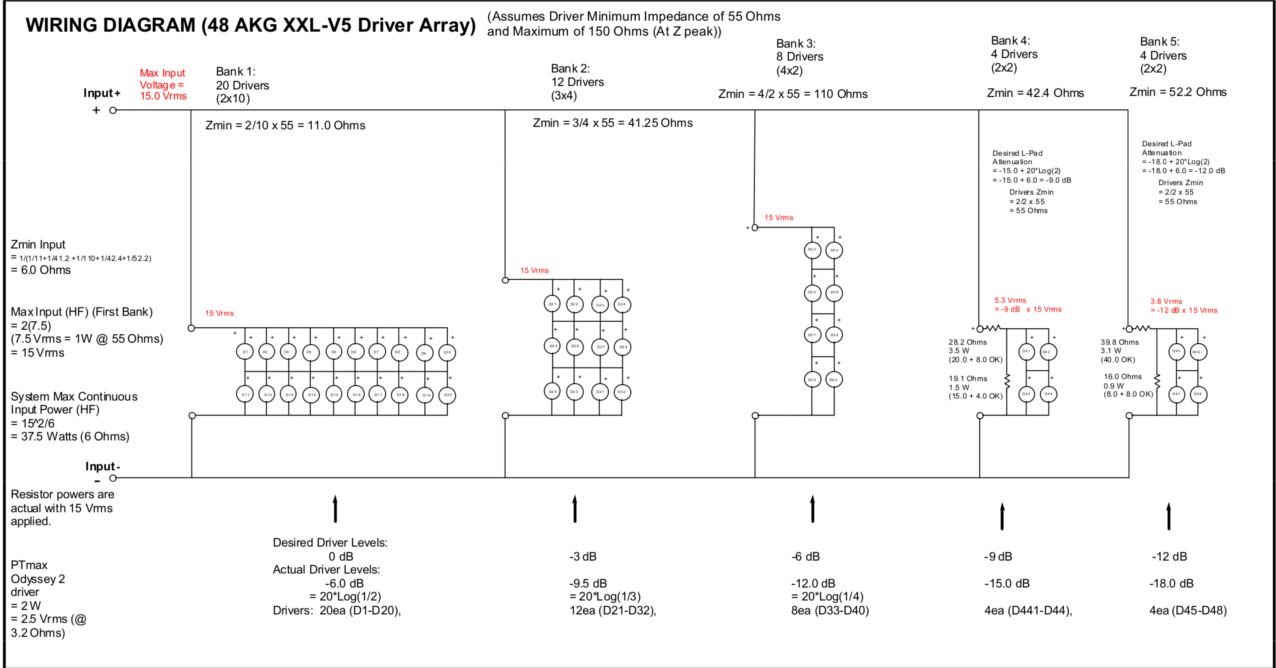

Can anyone describe exactly how the shading is accomplished in the real-life demonstration model? I didn't see any nuts-n-bolts discussion in a quick survey of this thread and accompanying links... Are groups of multiple drivers operated at the same level, for a stair-step power tapering effect, or is each driver individually padded?
Thanks Thune.
Hmm. So 5 driver groups with stepped shading. In Keele's paper, my take was that he was using an idealized simulation with individual driver shading. (Please correct me if I'm wrong.) If so, I'd like to see a simulation of the real-world stepped shading to see how results diverge from the idealized version.
Or maybe, as with so much else in audio, the ear really isn't as sensitive to measured differences as our pride would have us believe?
Edit:
I just remembered he has actual measurements of a prototype toward the end of the paper. I assume that's the step-shaded implementation?
