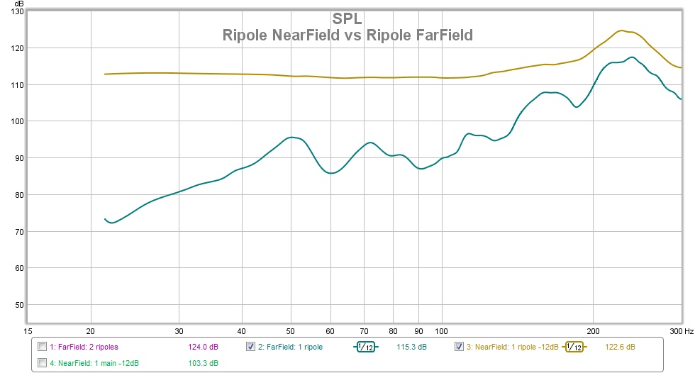

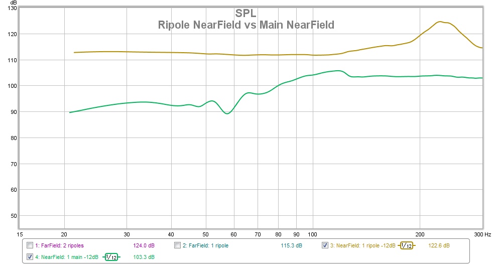

1/12 octave smoothed response: Ripole NearField (signal reduced by -12dB to prevent mic clipping) vs Ripole FarField . The emergence of room modes are clearly visible
On the 2nd curve, I've compared the nearfield bass response of the ripole to the rear-ported bass reflex minimonitor. Not a perfectly valid test since they are driven by different amps (with potentially different input sensitivity), but here it is anyway.

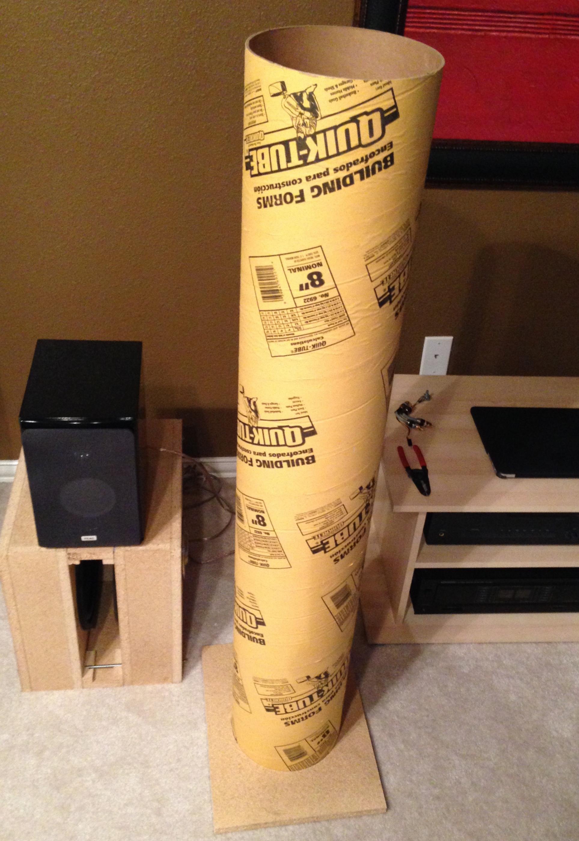

The tube will be good. Maybe a bit one-notish with your high Q speakers,
but will alter the impedance of one end such they don't sum to a cancel.
Also extending the nearfield loop to include more of the listening room.
closer to quasi -aperiodic when stuffed with a shallow roll-off. Should be an interesting comparison. News to build an adapter plate to mount the sonotube first

On to the stuffed sonotube extension experiment, for better or worse - since I plan to somehow retrofit this to the ripole

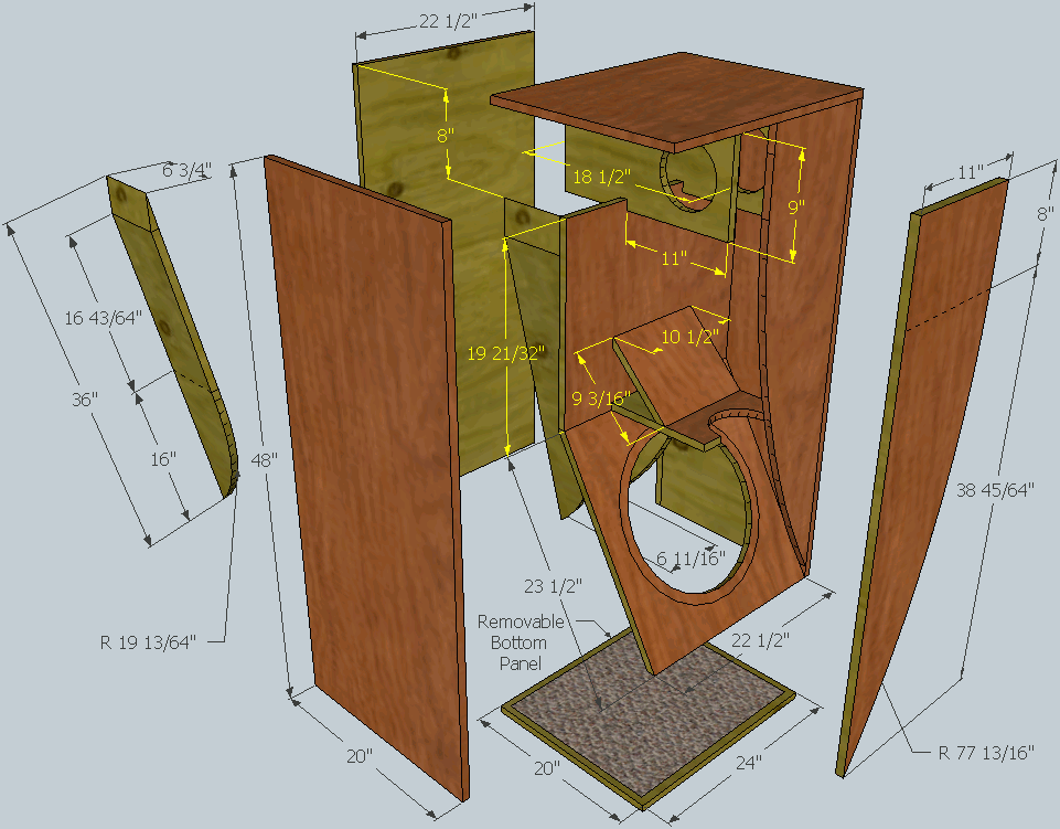

The OP wants to do something with his existing pro 18's.
Rather than wing an un-recommended driver with ripole
and fail, or spend 999euro per side for recommended
plans and drivers (according to popular legend, the only
way ripole is assured to work)
Let me give you some free plans of mine. For a pro 18".
An untried hybrid of Karlson and tapped horn. If it fails,
at least you didn't pay some snake oil salesman a dime.
I can waste your time on improbable nonsense for free!

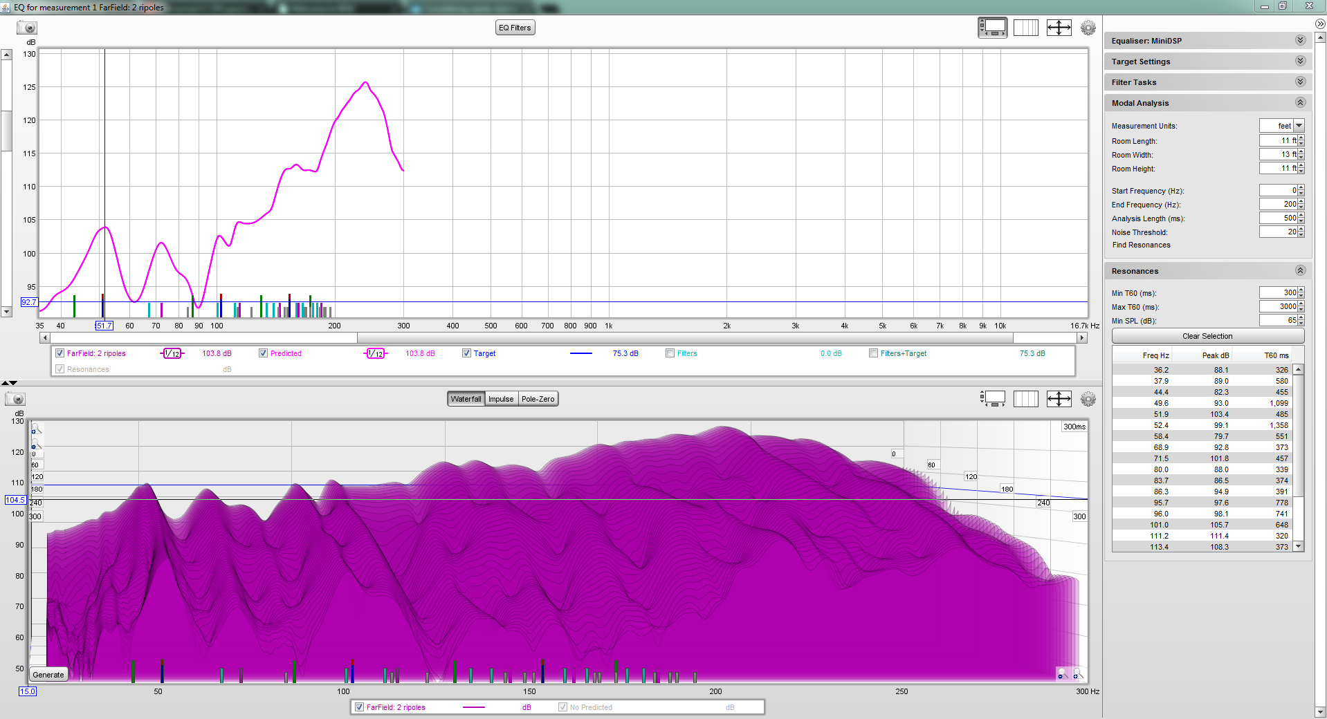

Don't know about that, .. All I can hear is whooshing air below 30 Hz when I was testing with since waves yesterday.

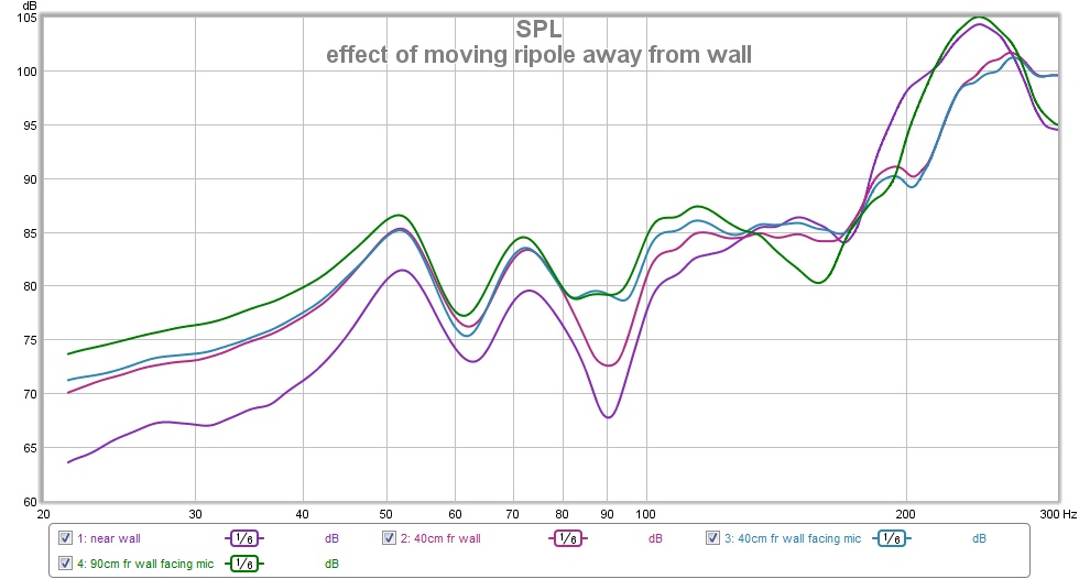

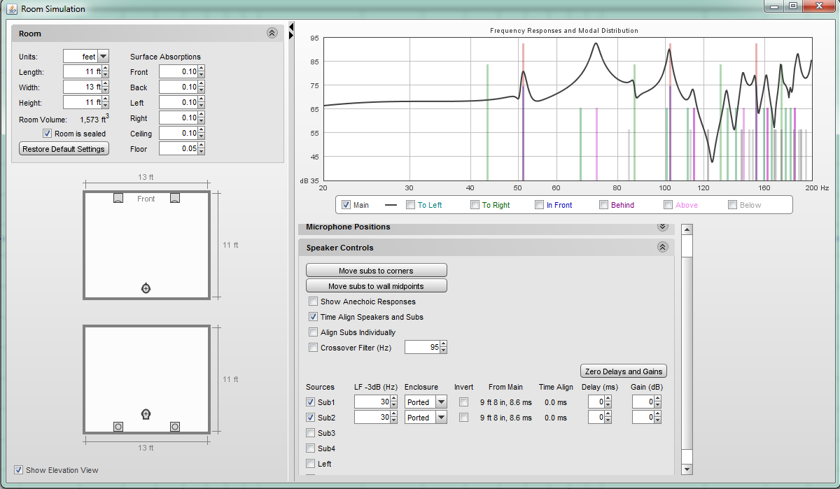

Played with moving the ripole away from the rear wall towards the mic.
  • As the ripole is moved away from the rear wall towards the mic, the SPL goes up. This could be due to a combination of enhanced dipole sub action (rear wave delay) and also physically reducing the distance between the device close to the mic in a rather small room
  • Pointing the slot directly at the mic removed a rather large null around 90 Hz . This was interesting to note (compare curves 2 and 3, for example).
