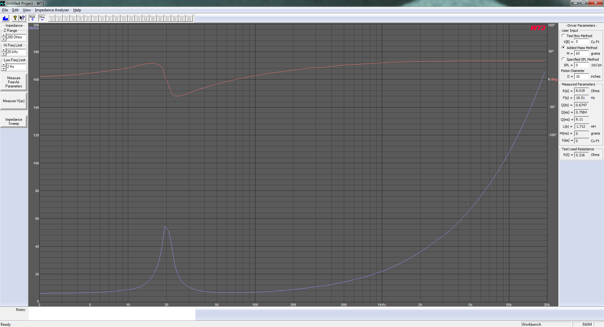

I am having a little trouble understanding Pic3.
Looks to me at 20V, the cone moves 10meters.
Bad as excursion can be, I don't think its quite
that bad...
If it was supposed to mean 10mm, the last one
I saw (zob's #3, not the latest incarnation #4)
did not exhibit even that much cone control.
In your other screenshots, 1m appears to mean
unambiguously 1 meter. What does 1m mean in
the excursion graph?

Ken, Your Q regrding Pic#3:
10mm is the right value.
I know this buggy behaviour of Akabak

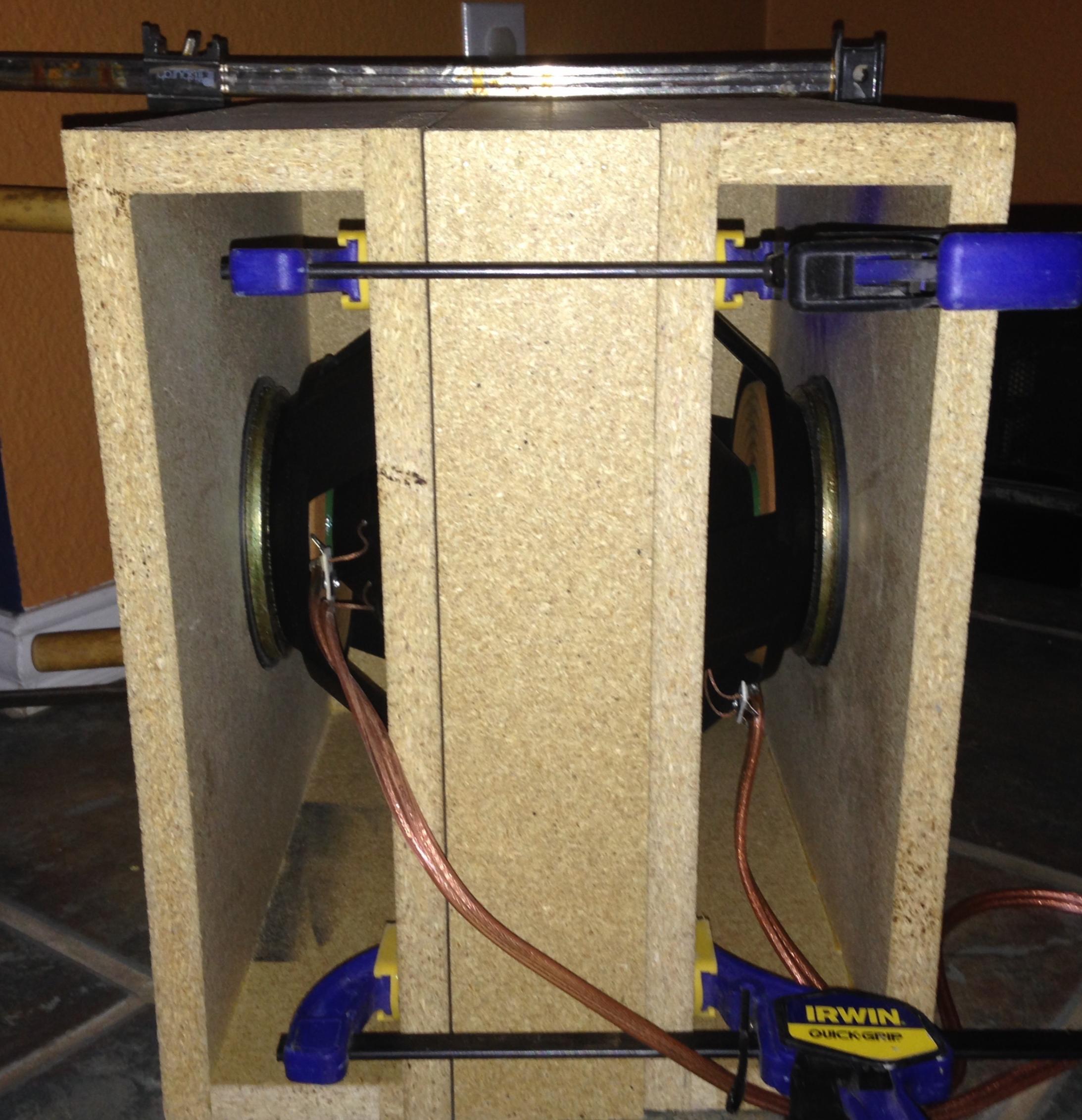

My table saw switch started malfunctioning, just as I finished the last cuts for this project, .. always stuck in the ON position, so we may not be able to implement the alternatives till I have a chance to repair / replace it, unless you want to risk amputation to go along with the proposed viking funeral
I verified the phasing with a 9V battery. The woofers push towards each other with their terminals in parallel (4 ohm load total) and connected to the positive pole of the battery.
I dragged the ripole to a corner of the room and pointed it out at the diagonal and walked about the room. Better than last night but still not pretty. When I have some more time, maybe on the weekend, I promise some more rigorous tests and tests in different rooms. One of my test tracks tonight was Bela Fleck's Flight of the Cosmic Hippo. https://www.youtube.com/watch?v=1iYgf6PWYK8 .
Any other ripole owners care to subject their drivers to this at slightly above normal listening levels ?To summarize, it wasn't pretty when the bass overloaded the enclosure . The mains were some DIY low efficiency econowave speakers and the ripoles were crossed over at about 80 Hz . Amplification was a NAD C720BEE and source was a raspberry pi with an outboard USB DAC

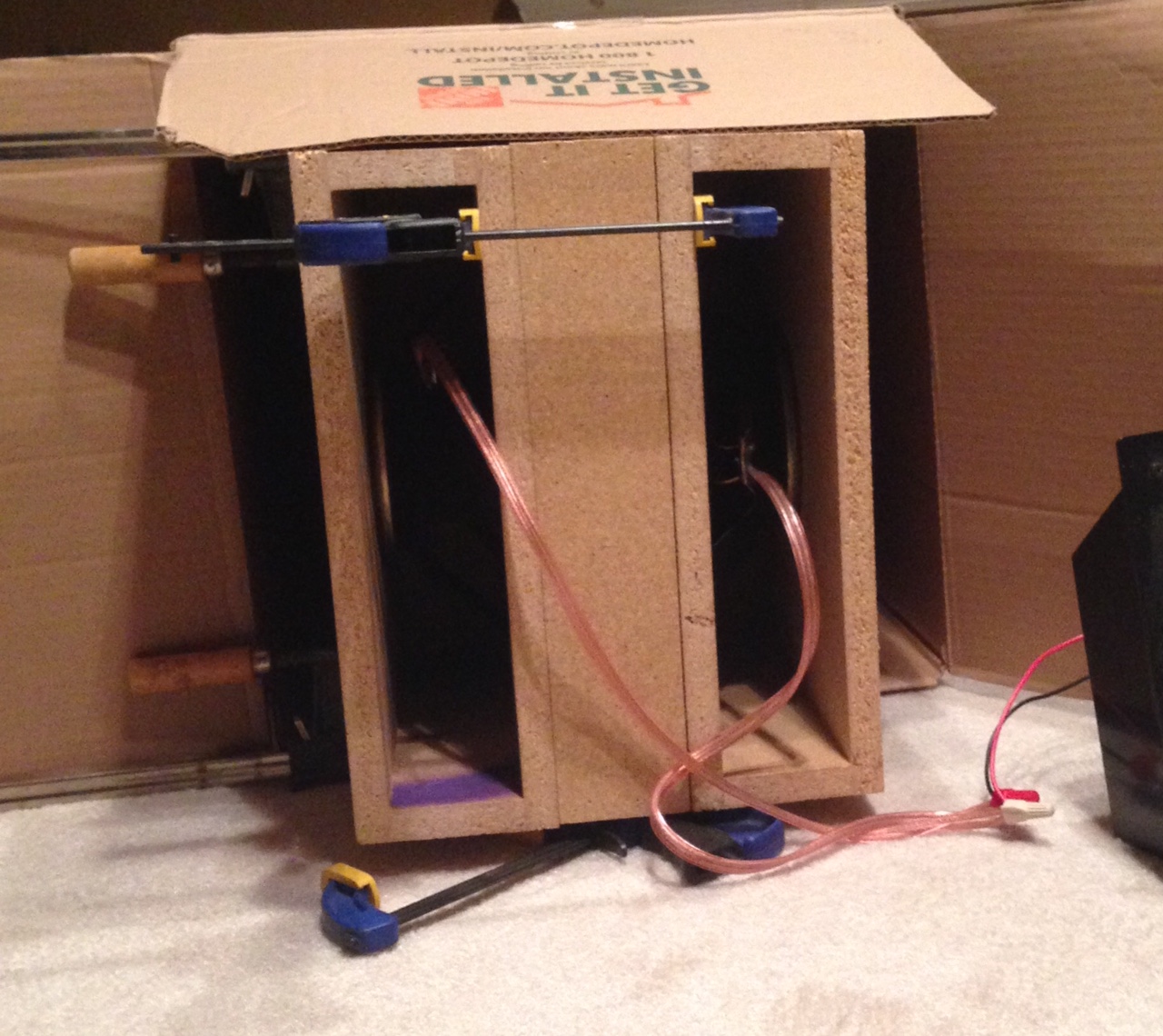

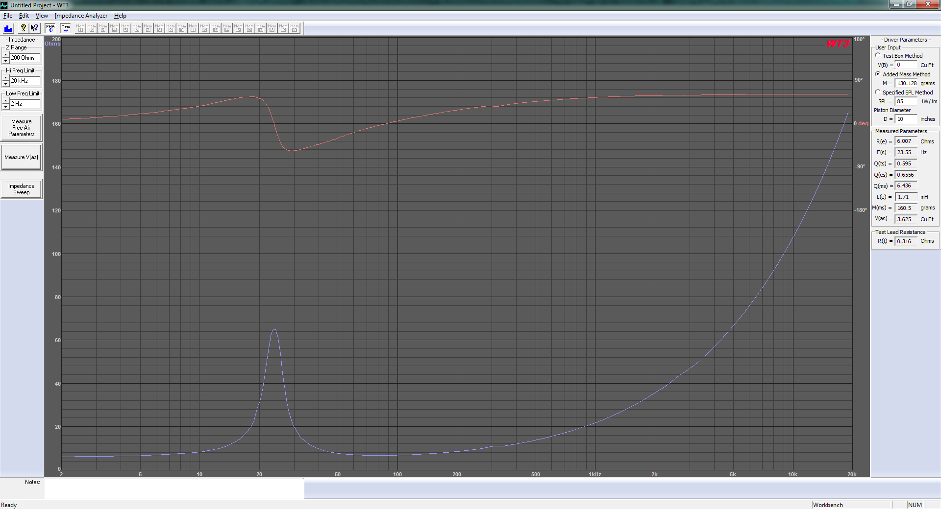

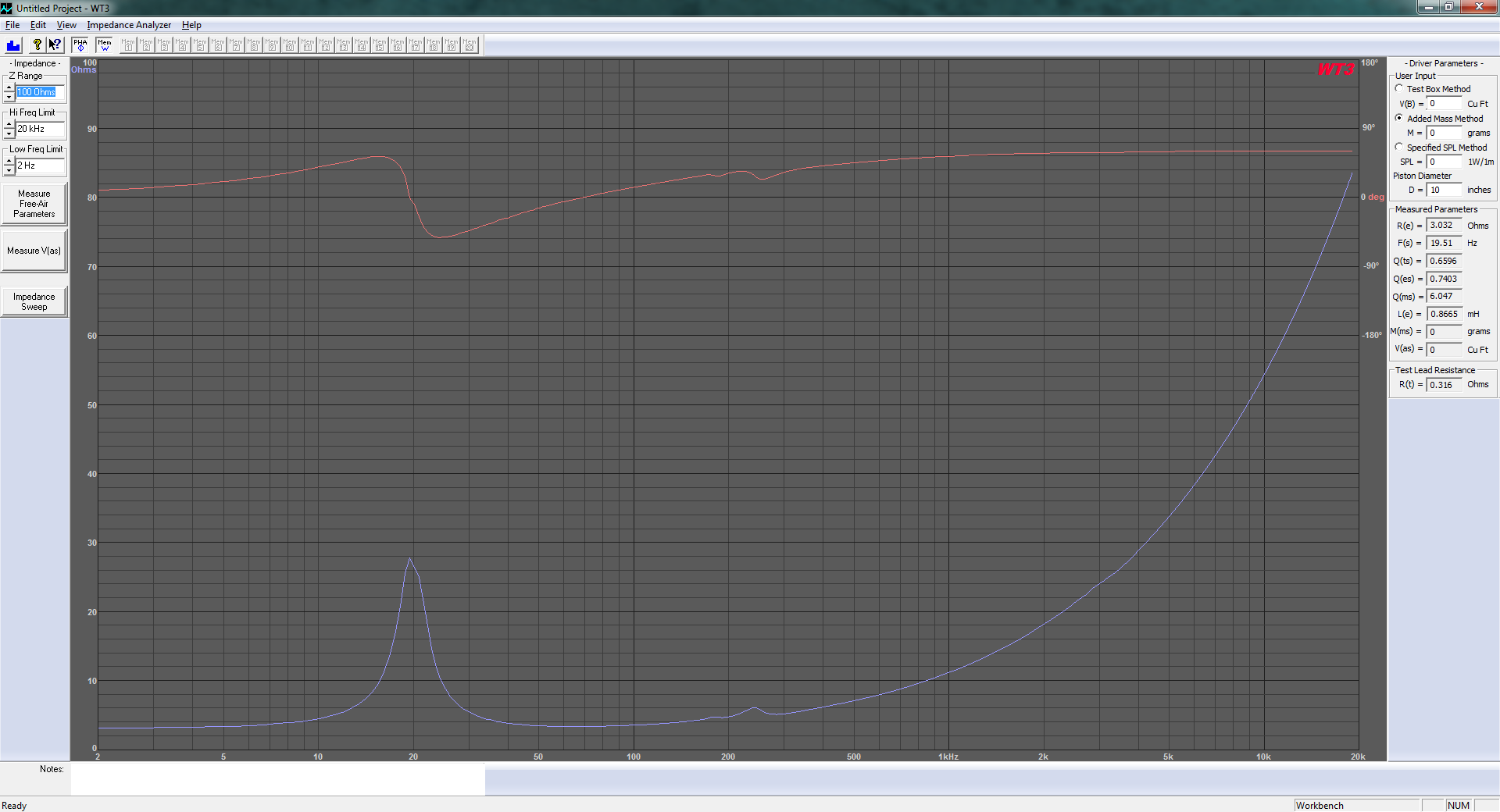

This evening, we ran impedance sweeps on the raw driver (zalytron 1201PL), the 2 driver ripole, and estimated the extra effective mass needed to drop the raw driver resonant frequency by the same amount as the ripole (65 g per driver).
The ripole dropped the resonant frequency of the raw driver about 4 Hz to 19.5 Hz
Observations:
1. Listening in a much smaller ENCLOSED room (maybe 10 x 12 ft with a high 12 ft ceiling), the ripole performed better than in my previous experiments in larger, more open spaces. I used an inexpensive pair sony bookshelf speakers (normally my home theater rears) for mains sound. I brought the ripoles in about 60 Hz in this test.
2. The ripole was basically done at 30 Hz, with woofers flapping about like a fish out of water, with little sound to show for it. Above 30 Hz, the bass was clean and even with maybe a few room modes. When I run the measurement tests, I'll use an actual amplifier - as opposed to a plate amp, to be sure I'm not dealing with any plate amp boosts / high pass bass cut etc . I can use my minidspor a PC equalizer later on to smooth out the room modes.
3. We rigged a crude 6th order bandpass by placing the ripole in a cardboard box. This brought up the bass about 50 - 60 Hz but was more uneven overall
4. We rigged up a crude 4th order bandpass by sealing the rear section of the ripole against the carpet. This had roughly the same effect as 3, but at different frequencies.
5. Based on our experiments, I feel that to have a successful ripole system, a good amount of swept displacement and / or a small room is needed. This 2 driver ripole with modest subwoofers performed halfway respectable in a small room but would be hopeless in our main living area.
6. At this point, I might build another identical ripole after I fix my saw, .. A pair of 2 driver ripoles with these drivers should work "OK" in a small room . Ripole "merits" apart, I would not have considered this approach if I didn't have so many of these woofers lying about (literally, at this point).
Measurements, and DSP correction to follow, in subsequent posts.
Here's a pic of the 6th order Frankenstein
