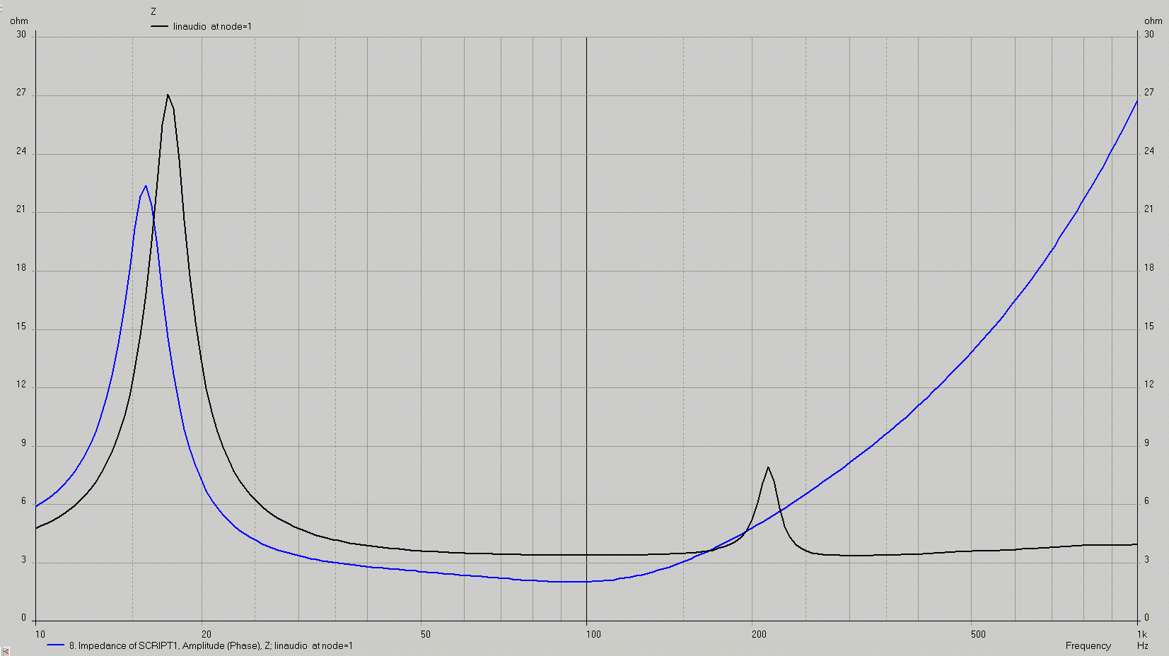

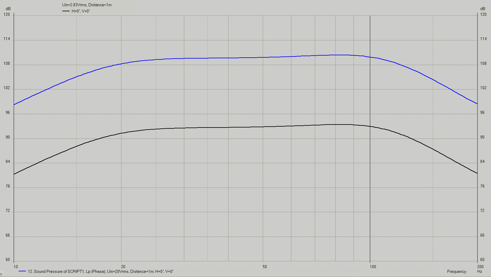

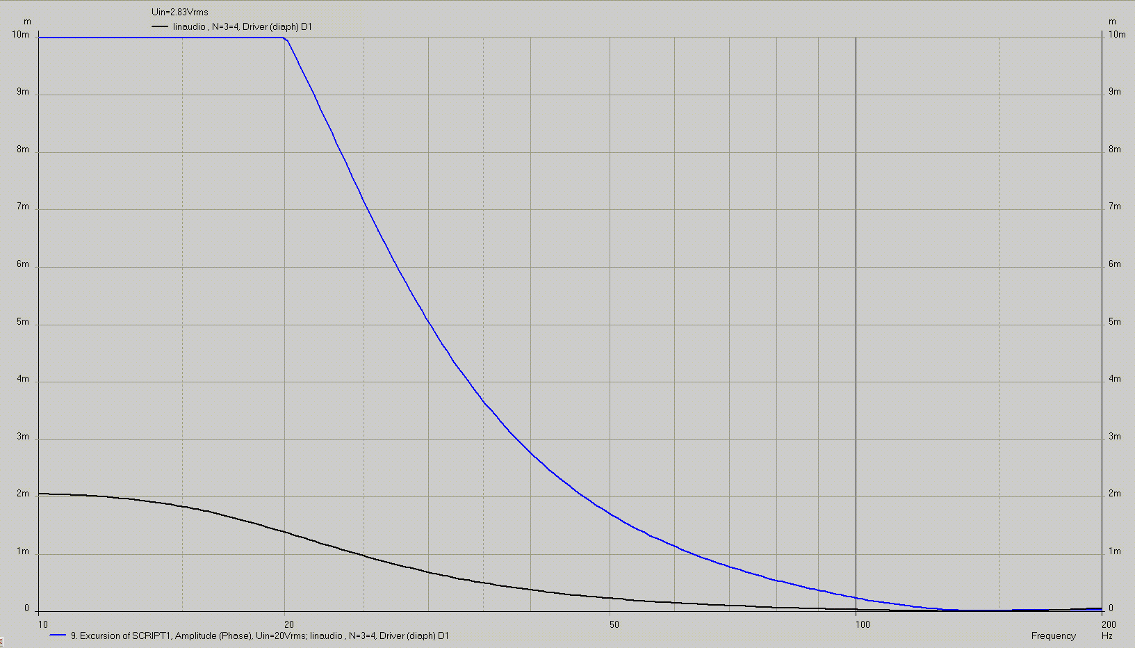

I sim with the same Akabak script Axel uses for himself.
The script has proven to correlate well with real life.
Iirc Axel as well as Mr. Linkwitz use the term folded open Baffle for their constructs.
Efficiency is certainly reduced by acoustic phase cancellation, but used as a singular numeral, without taking the circumstances into the relation doesn't show reallife behaviour.
One should at least state under which conditions the claim may apply, otherwise it's just spilling hot air. 🙄
If You compare the small folded dipoles, it'd be sensible to compare to other principles when built into similarly small sized cabinets and similar amplitude response.
Just to give You an idea: The dimensions of Axel's BMC400 Attac woofer was smaller than the two shipping cartons of the raw drivers.
Apart from the fact that some principles -think of a horn- in such small cabinets would be a ridicule, most other principles required considerably smaller drivers and/or so much electronic equalization to reach a similarly low lower bandwidth limit, that efficiency figures would be comparably and awful.
If ones sizes a ripole up to the same cabinet volume of say a BR instead, the dipole could make use of much more membrane area, typically 3-4 times.
Also real room conditions must be taken into account, as the dipoles loose quite a bit on their dipolar character placed in proximity to a reflecting wall.
All this put together and it shows that the dipoles aren't at all 'awfully' inefficient, but can compare quite well with other principles.
Where the folded dipole is indeed 'inferior' is not efficiency, but effort.
More membrane area means multiple drivers or larger drivers and associated higher building complexity.

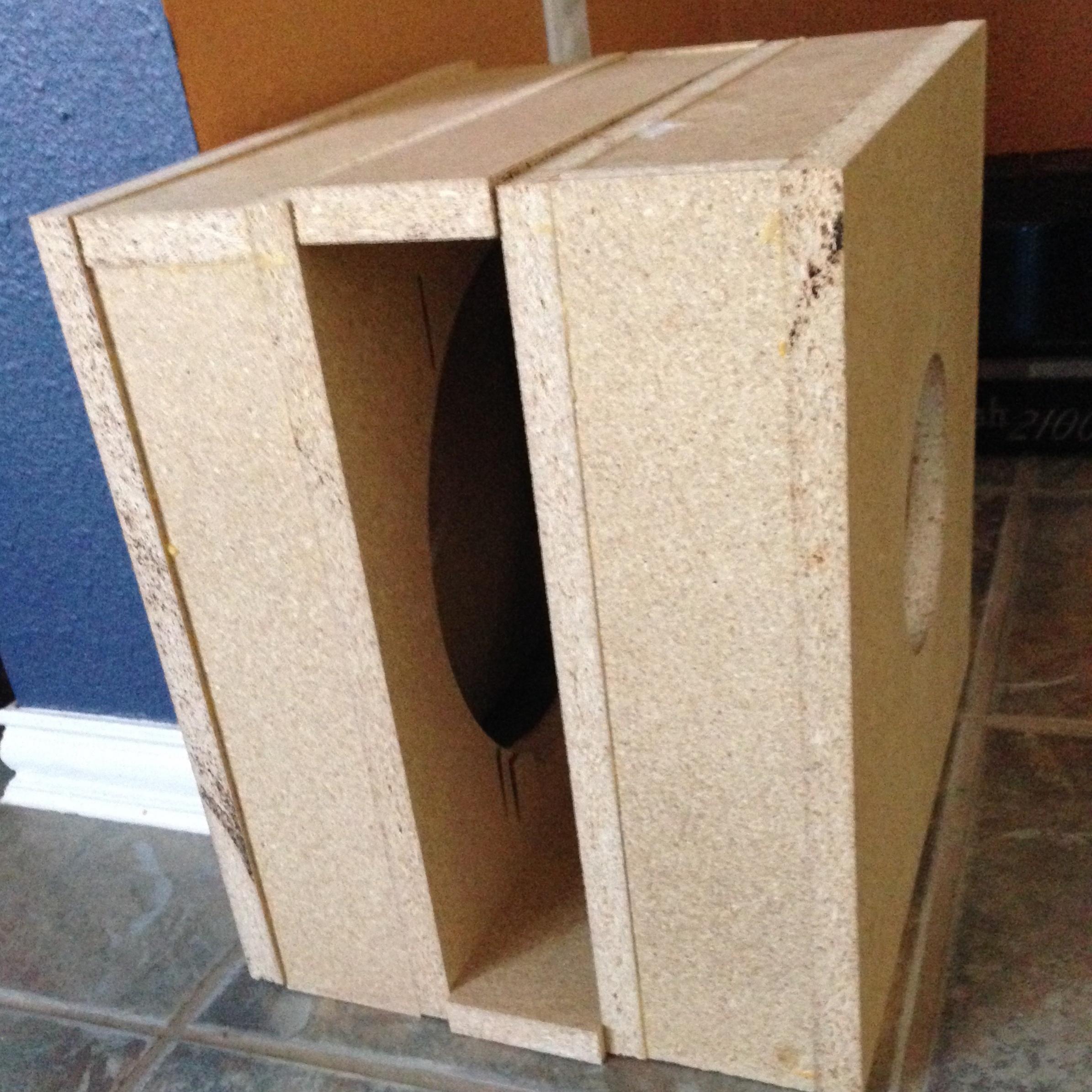

Lets talk Ripole awful for a sec...
Bass is there if you stick your head or microphone into the vent.
Little further away on-axis, if you are lucky: Bass might drown
out the port noise. Off axis, port noise (which disperses well to
the sides from the slot) is hearable over the bass (with a deeply
notched figure 8 pattern due to cancellation).
What else is awful: Unloaded drivers flopping beyond linear XMAX.
We can pretend 2nd order cancellation of push pull, but 3rd order
due to excessive excursion gets you. And maybe some of those
harmonics contribute to the port noises I noticed. As the noise I
heard off-axis didn't sound quite like whooshing or wheezing.
Ports are plenty big enough that sort of thing shouldn't happen.
But slot loading! Well, the change of acoustic impedance in the
slot is not really loading into a space with an equal and opposite
suck-out nearby. Might as well put a dead weight of putty on the
cone and call it "loading". If a cone flops uselessly, its not loaded.
Compare Ripole to an ELF sealed box operating below Fs:
-6db per octave vs -12dB per octave equalizations required.
On-axis, sealed box below resonance requires more power.
Off-axis, sealed box could win vs Ripole's figure 8 pattern.
Yet even Ripole's winningest scenario, on-axis: Runs out of
linear XMAX way before the sealed box or any reasonable
amount of equalized power.
I have nothing against open baffles. Add a baffle to Ripole
totally fixes it, if you have space for that sort of thing...
Or load Ripole's back with a corner or wall to make the
impedance and phase shifts dissimilar, you might hear
or feel something. Perhaps horizontally behind the couch,
so near field of the port is directly behind your head, and
the back dissimilarly loaded by the floor.
It seems silly to purposely put yourself into a situation
where positional loading compromises are even necessary.
Ripole compares well with other snake oil and hearsay.
Build you one, I really think you should, everyone should.
If you have any doubts at all, wasted effort will remove them.
I don't mind if you dislike me today for writing the truth.
Only trying to save you some time and money.
Been there, done that...

Since he's set on it, I think he needs to build one and report back. It's a pretty easy and inexpensive build. The point of contention, as you've noted, is "performance" compared to the same driver in another alignment .
FWIW, I have a pair of scavenged 15" realistic mach one drivers ( http://www.parts-express.com/replacement-woofer-for-15-realistic-mach-one-8-ohm--290-184 ). If I can find some cheap scrap wood, I'll try and rig up something comparing a ripole to a SLOB, with measurements
FYI, To the original author, this might be helpful
http://www.hifizine.com/2012/12/subwoofer-origami/
http://lautsprechershop.de/pdf/ripol/ridtahler.pdf
Port noise with a Ripole? Sounds like someone's poor experience has something to do with poor build quality.
I've built a few Ripoles and never had an issue with port noise, only running out of steam a bit early.
Definitely not build quality.
It's been a while but I think the noise he mentioned might have been originating from the vented pole piece with the driver stressed near xmax
I'm going to give this design one more shot
1. The first ripples I built were with a pair of 15" pro drivers - Pyle ppa15 , Qts of 0.7 but low xmax
2. The 2nd was with a single adire shiva 12, plenty of excursion and borderline low qts of about .4
3. Last year, I built a pair of SLOB array with 4 12" drivers which worked well, part from being too big
4. We'll see what happens with these realistic drivers , highish q and moderate excursion. I found a 4x8 piece of blemished particleboard at the hardware store for very cheap so I'll makw some sawdust this weekend and report back

Particleboard has been sacrificed at the alter of "r-insanity" and a ripole has been produced.
A free air test with my 15" woofers resulted in too much motor noise and not much to show for it. I have some 8 ohm 12" subwoofers that fared much better in this test and also have a q of .5xx and an Fs on the mid to higher 20 Hz so I decided to build for them instead. Somewhat similar to the jazzman ripole mentioned earlier to this thread . 15" square with about 3" high x 13.5" wide rear openings (2). Since I don't expect my zalytron 1201pl woofers to have more than 5mm xmax, I chose a front chamber opening between 1/3 to 1/4 of (Sd x 2), fortituously ending up with 3" x 13.5"too.
Here is the contraption, untrimmed and pending test.

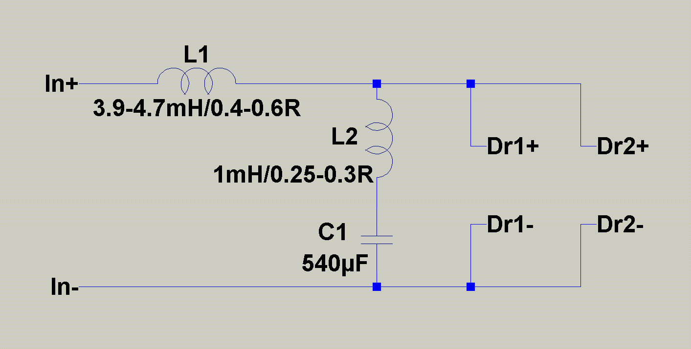

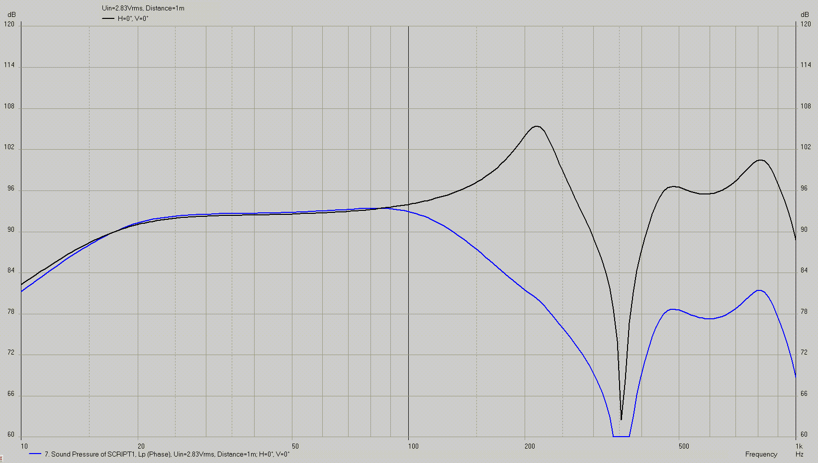

linaudio, the script contains 3 different Wd values.
Based on the 48x13cm port size for all three ports, the TSPs You gave and the sim data I gave earlier here are the diagrams:
Rem: Data for electrically parallel connected drivers
Pic1) amplitude plot at 2.83V @1m, wo filter (black) and with suggested filter (blue)
Pic2) Impedance plot wo (black) and with filter (blue)
Pic3) Membrane axcursion over frequency w. filter @2,83V (black) and 20V (blue)
Pic4) schematic of filter ciruit.
Pic5) amplitude response plots for 2.83V@1m w. filter(black) and 20V @1m w. filter (blue)
jauu
Calvin
notice the general similarity of the curves of the sim and Face´s measurement.
So much about a thing that doesn´t work, yeah 😉
jauu
Calvin
Please share your results after testing, maybe fourth time is the charm. 🙂
Yes, my script was an attempt at a W-frame, not a ripole. Basically Linkwitz' original W-frame scaled up to fit the 18" drivers (but I have eperimented a bit more, and I don't think my attempt was quite right...).
jauu
Calvin
However, looking at your plots (thanks!) I'm tempted to just go ahead and build the ripole, it looks really promising in my eyes. I might try, with a bit of careful planning, to cut the parts so that I can try out both W-frame and ripole, I'm curious to compare both listening impressions and measurements. Thanks again! 🙂
