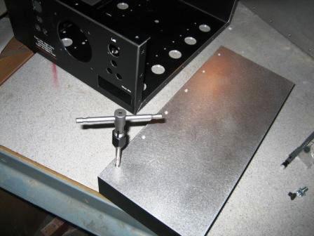

yes, this is what I was referring to a few posts back. 🙂
From my experience, much larger surface area is needed on the lip of the Heatsink for a bottom panel, due to the weight of the tranny and torsional flex of the chassis.
If a flat bottom panel is used, it needs to be 4mm thick. This is OK with me.
Another alternative is a bottom panel 2mm thick and bent up 3/8" to .5" inches to mount the heatsink. Bending provides a great deal of extra strength.
Attached is a picture of a version of this I've used a couple of times with great success. This particular design is a complete "U" channel made from 2mm aluminum. The box is ROCK solid and easily carries the full weight of a class-A amp.
The box was designed and made via Frontpanel Express and bent up at a local sheetmetal shop.
-David
