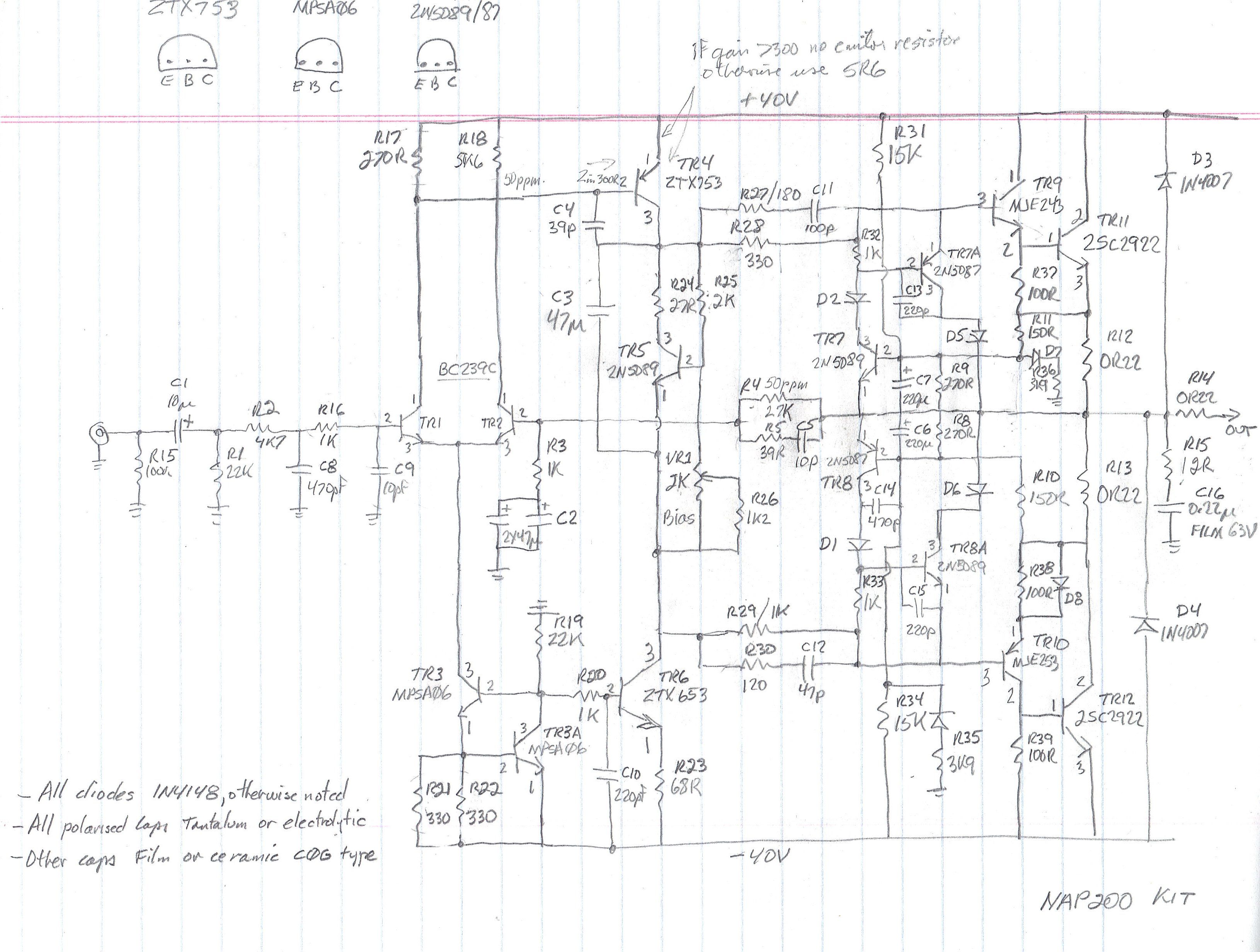

All Naim NAP models were Quasi-complementary but that doesn't mean you can't have balanced power supply rails for 0VDC at the output, like any other post-1970s commercial amplifier, whether it's EF, CFP or QC topology.
There is no schematic on the 'net for Naim models, apart from an early general schematic that was used for NAP250, which also had regulated power supplies. I attached (I hope) the hand drawn circuit of NAP200, reverse engineered by algar-emi in the long NAP140 kit on Ebay thread. For easier viewing and comparison, there is also the NAP 250 power amplifier board schematic.
Apart from the dual slope current limiter protection that was used in the NAP200 and other late models, the designs are essentially the same, just with more recent semis and component types.
