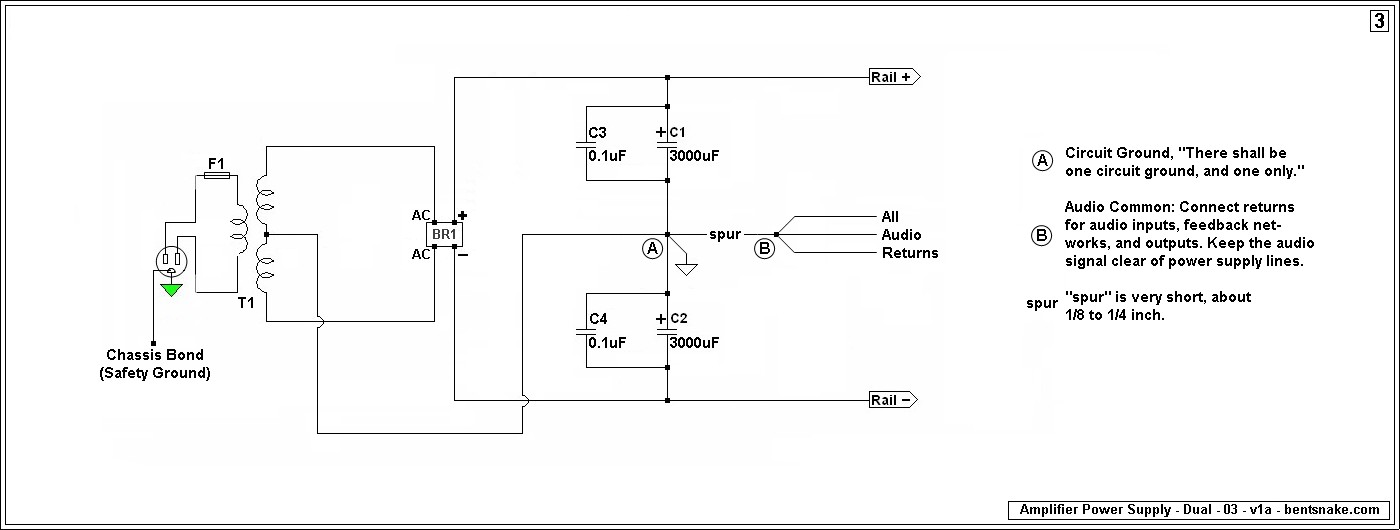

So here is my plan, and please tell me if I have something wrong here...
-Input jack and speaker jack and headphone jacks all have their ground separated from each other at the jack (no connection to faceplate metal) and each goes to their respective ground on the circuit board via shielded cables.
-Main amplifier board has everything star grounded just like any other chipamp, then rectified filtered DC running to to that and the positive connections.
-Preamp circuitry all having its own star ground, that then connects to the main amps star ground on the circuit board.
-Finally.. metal chassis itself connected to the ground on AC outlet, and a resistor/capacitor from chassis to the main amplifiers star ground.

Posted below is a succession of images, intended to progress from the basic principle to real-world application.
Figure 1 is simply the usual schematic for a power supply. You're supposed to look at it and admire the simplicity of the concept.
Figure 2 is the same (literally) schematic, but with notes added that I hope are self-explanatory.
Figure 3 is electrically identical to the first two, but mechanically different because real-world wiring connections are shown.
Figure 3 is where the various this-grounds and that-grounds come in. All these different "grounds" seem to--and do--violate the rule of "one ground point, and one only." I resolve this conflict by referring to everything except the shown Point A as "commons."
Figure 4 shows the chassis bond. This is also called chassis ground, safety ground, and probably a dozen other names.
Figure 5 brings everything together--I hope--showing how the audio circuit connects to the power supply.

I should connect ground between A and B, not at A.
There are current pulses where A is currently located.
If I ever used C3 and C4, 100 nF, I would never connect them across electrolytics C1 and C2
<< I should connect ground between A and B, not at A. >>
Then what, if anything, would you connect to point A? If you don't connect anything, then the new connection just becomes a new point A, and everything remains the same.
<< If I ever used C3 and C4, 100 nF, I would never connect them across electrolytics C1 and C2 >>
But instead you'd...? It would be ever so much more helpful if you'd say how you would connect them.
