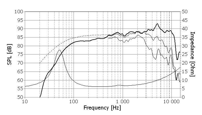

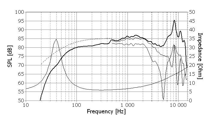

The L15 aluminium cone would probably start to 'breakup' at a much higher frequency. Have you got a frequency response, impedance curve & waterfall for this and its paper sister?

Yes, I'm aware you can't separate the two in terms of engineering: I'm simply pointing out that the root cause is the lack of rigidity at the edge of the cone rather than the surround itself. The latter attempts to control it, to greater or lesser success 😉 but isn't usually the culprit per se. We see the same thing in most 'soft' cone drivers relative to sister models with rigid aluminum / alloy cones.You can't separate the two. Matching the cone edge to the surround is the key. We were the first to look at this with FEA/BEA to confirm what we saw with the Laser juju in an attempt to formalise what we already knew from experience.
Oh, it does. Much, as you'd expect. That's simply the point I'm making: the cone, being rigid to a much higher frequency, doesn't have that edge resonance of the softer unit lurking around the [mean] 1KHz area, so it's not actually the surround that's the cause of the problem with softer cone materials: it's just trying its best to control the [relatively] flobbery periphery.The L15 aluminium cone would probably start to 'breakup' at a much higher frequency. Have you got a frequency response, impedance curve & waterfall for this and its paper sister?
FR & impedance plots are available on the Seas site:
https://seas.no/index.php?option=co...5rly&catid=44:utv-prestige-woofers&Itemid=461
https://seas.no/index.php?option=com_content&view=article&id=56:h1141-08-l15rlyp&catid=25&Itemid=347
It's a shame Seas discontinued the L15 & its larger L18 stablemate -stonkingly good drivers for the money when used properly. Not that the ER15 & ER18 are bad units -also excellent, & as semi-rigid units, they're a reasonable compromise.

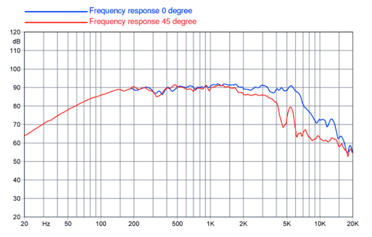

I am trying to design a passive, first order filtered, open baffle system for some time. The drivers should be a woofer, a mid bass and a tweeter with crossings at about 200 Hz and 2 kHz.
The biggest problem with this concept is finding a mid bass with fair behavior above the piston range, so it should have nice cone-breakup characteristics.
Right now I am looking at the 5FE125, a 5” mid bass from Faital.
Very important is a fair behavior up to about 10 kHz.
Who has other suggestions for such a mid bass ?

The Faital's good; depending on sensitivity requirements you might want to look at the Seas MCA15RCY, ER15RLY, CA15RLY, or Excel W15RLY001 if money isn't tight; they're all relatively well behaved out to 10KHz. From Scan, the Discovery 15/4424G00 is also well behaved, a pricer option being the Revelator 15w/8530K00. Some others of course, but those are ones that immediately come to mind.

If you look closely at the impedance curve of L15 you'll see the tiny impedance fluctuation just before the HUGE 8kHz resonance.I usually find it's the cone that's the culprit rather than the surround -it's never an exact comparison, but if you took, for example, a Seas ER15 (reed paper cone) & compare it to its (now sadly defunct) L15 aluminium cone sister model, the former shows a small but obvious fluctuation in the impedance curve around the anticipated 1KHz, whereas the latter's curve remains constant, suggesting it's the cone edge rather than the suspension itself that's the underlying cause, and the poor old surround is simply unable to damp it properly.
Here the poor old surround is certainly unable to damp the cone when it breaks up. 😊
The impedance blip isn't an indication of how bad the resonance. It just signals the start of the 'controlled' breakup on a 'good sounding' unit. Of course on a bad sounding unit ....
