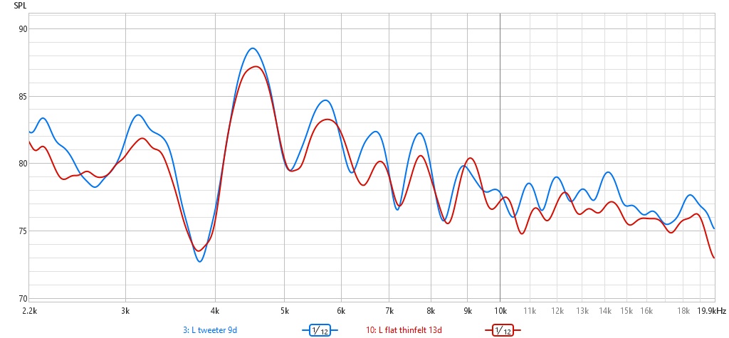

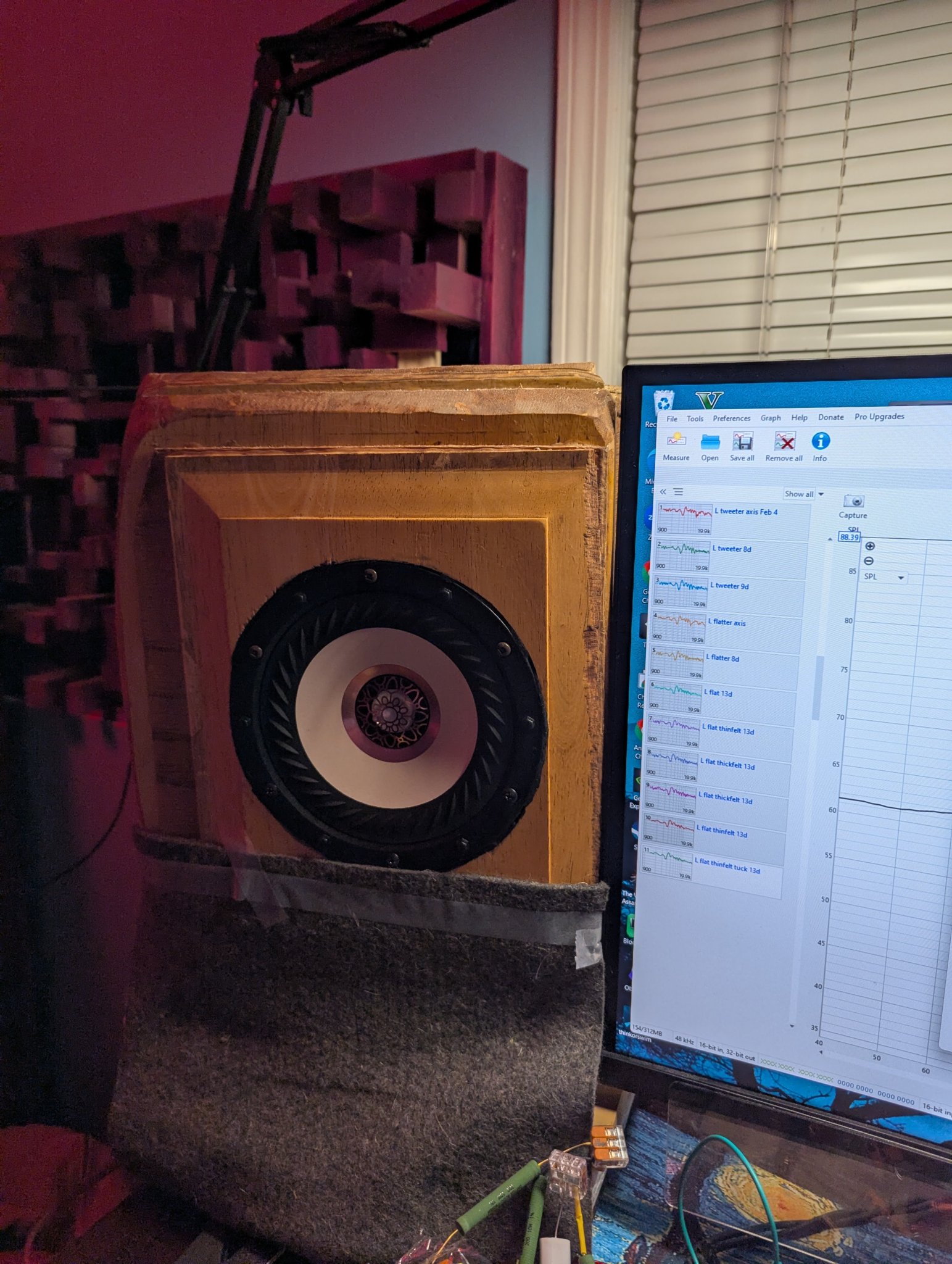

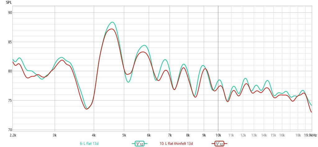

@Juhazi @wchang using a piece of felt as pictured. Naked tweeter only of coaxial TB W6 2313. 1/12 smoothing.I use small synthetic selfadhesive felt pads to tame cone resonances of SEAS MR18 woofer. I didn't save .mdat files.
Comparing the baffle not properly aligned with the monitor surface without felt vs. properly aligned with felt:
For some reason making the felt thicker by folding is worse.
The large peak 4.5 kHz is when the wave gets out of the waveguide and is jumping on the rubber suspension. This must be notch filtered, it's not really a distortion. The same frequency for the woofer also 7 cm length at the rubber band is a distortion and must be squashed.
... surprisingly, an immediate improvement of imaging after 1 hour of listening. So it's not about 2 Db smoothing but about small reflections confusing my brain from locating the source. That was really good.

I am surprised to see any kind of effect on tweeter response... by using felt that way.
May I suggest that you cover the monitor with felt, or with a thick pillow. Or even bettr caryy the monitor away and replace it with a pillow.
Seriously, if that is the setting that you measure, 95% of wiggles in the response come from the table, monitor etc.
@Juhazi indeed on the desktop the monitor dominates. In the past I already measured the optimal position, just a little wiggle makes a difference. But conveniently, the best position is when the baffle is the exact extension of the monitor aligned as accurate as possible. Also you can see my baffle is rugged, everything is asymmetrical, stepped and curved. I listen and measure 12 degrees off axis, the larger part of the baffle is beaming outward from me. So the measurements from the felt are consistent - just covering the small flat area below the speaker with 1/8 inch felt is audible. I think I came with a shape that is not too bad as a computer speaker.
