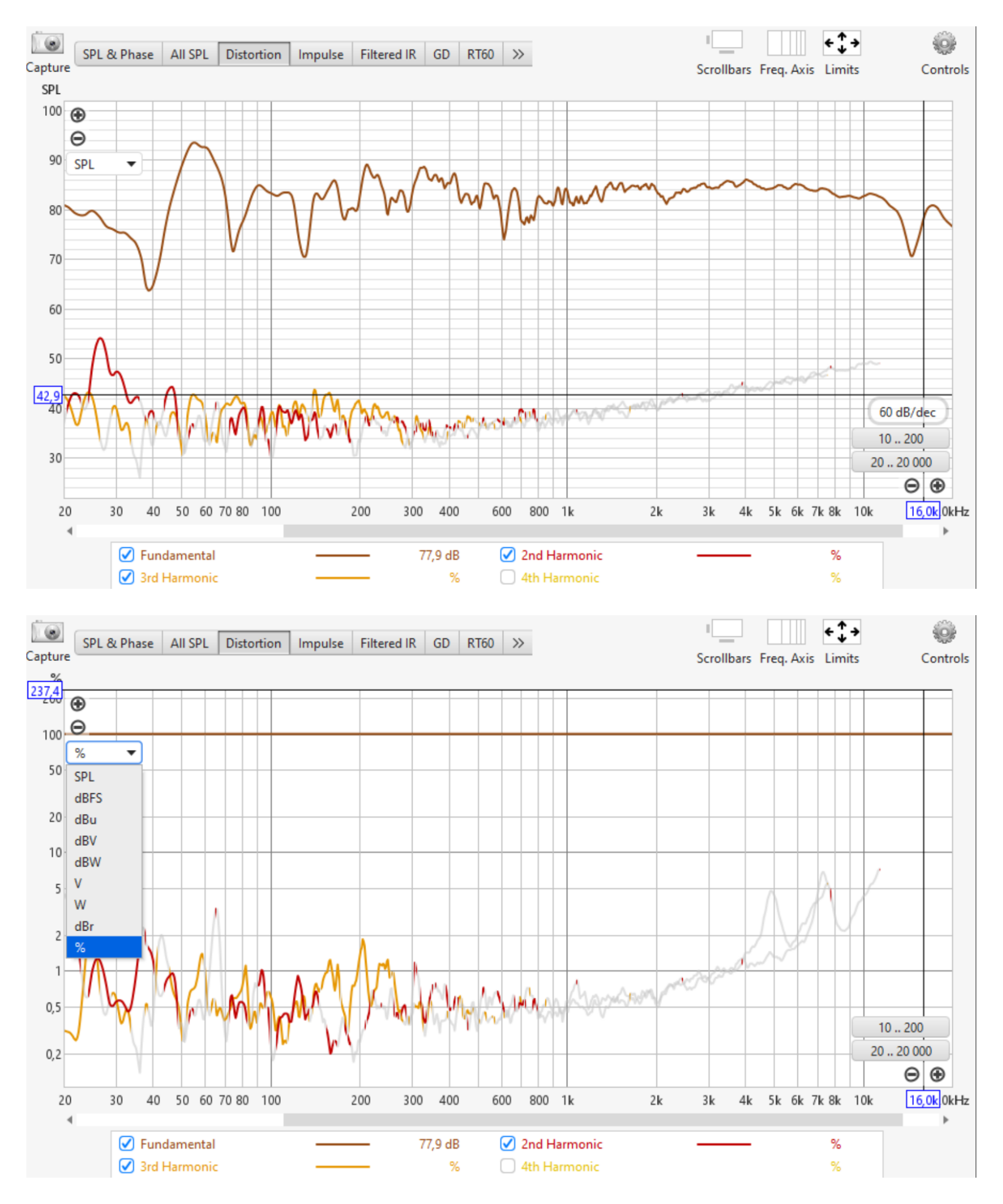

Would you like to explain that calculation?This peak is at 42 Db, with main signal at 84 Db, so it's 42 Db = 0.01% distortion measured as a harmonic one.
Calculating a voltage or sound pressure level to dBV or dB(SPL) is done with the 20*log(V/Vref) or 20*log(p/pref) formulas. As REW shows, -40dB equals 1% of the reference signal. And 1% HD is audible in certain conditions by most listeners. But not audible by default.
I want to clarify myself. IMD cannot be measured with REW sweep because by definition it requires playing multiple frequencies at once. So what I should say that if you already found that the cone breakup is causing major IMD with listening tests - because to listen is much easier than to run 500 tests permutating 5 different frequencies across the ranges - you can use the REW sweep to tune the crossover.

Fwiw IMD is easily measured in REW using the signal generator and RTA. Select "show distortion" in RTA and save the measurement, then look at the distortion tab to view IMD result with fundamental removed.
The catch with IMD is that the frequencies used and separation and number of tones provides very different results, so the analysis can be a fair bit more complex than just run a sweep and see the result.
Better option may be to try the new FSAF measurement in the REW beta. It allows a measurement using any audio at all, pick your favourite stress tracks and view a total distortion result that includes harmonics, intermodulation, energy storage, everything, and you can listen to the residual audio to easily correlate the distortion result with actual listening experience. Only downside is that this measurement requires a good competent mic that provides low self-noise and low distortion and a very quiet recording space. Think more along the lines of creating a recording booth for speaker testing as any background noise and room reverb will be present in the residual audio.

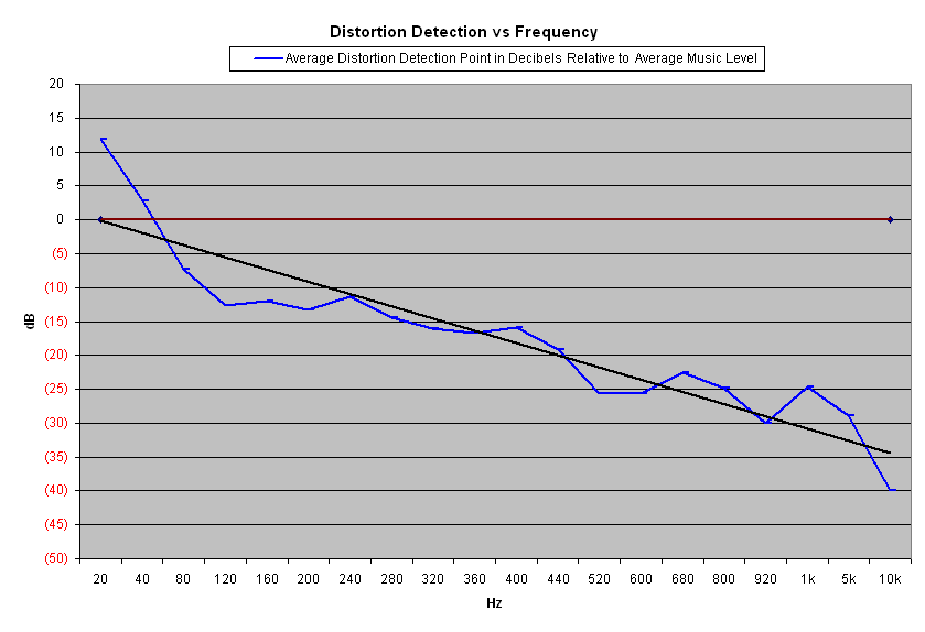

So far as I know there is no research for relevance of FSAF result/level versus audible distortion in music. It is just a way of making IMD separation residual audible, isolated from signal. Obviously this was just a sideline from his daytime job. https://www.researchgate.net/profile/Michael-Tsyrulnikov
As Geddes said, relevance of HD and IMD of loudspeakers is open too. Harmonic distortion audibility in music is verified to some extent but number of subjects (persons) tested are very small, not even near to scientific good practise. Sine wave distortion detection is easy to test, but speech or music...

ps. Linear distortion ie. deviation from flat (or desired) spl response is quite easy to hear (2dB commonly stated). Cone resonance is mostly linear distortion. In regard of M/T crossover typically cone resonance will be more or less masked by tweeter´s higher spl at same frequency. And this is sometimes the most challenging task when designing 2-way speakers, perhaps more important than directivity match IMO.
Harmonic distortions can be heard in sine sweeps or constant sine at specific problematic fundamental F. Like previously stated human hearing is most sensitive around 1-5kHz, so when distortion procuct matches that region it is easy to hear even in music as eg. different timbre of a trumpet or violin playing a long note. Just like in androxylo´s case, but you must have a reference then because different instruments and musicians have different timbre. But I still believe that in his case it is more about linear distortion, so 3-4kHz resonance peak attenuation and lower/steeper xo should help.
In 2013 I attened a presentation by Wolfgang Klippel, he demonstrated audibility of THD by playing music clips which had added distortion throughout the spectrum. If I remember right I noticed 10%, most of audience lifted hands at 5%... The loudspeaker was a small 2-way monitor.

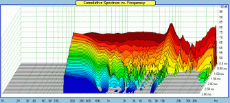

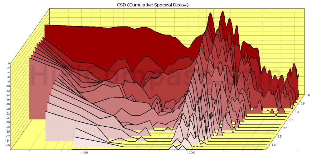

Another important aspect of (cone and other mechanical) resonances is decay of them, most often visualized as CSD. Differences in this are huge, but assessment and audibility tests are nonexistent.
HifiCompass is a wonderful resource for this info too.
https://hificompass.com/en/speakers/measurements/dayton-audio/dayton-audio-rs180-4

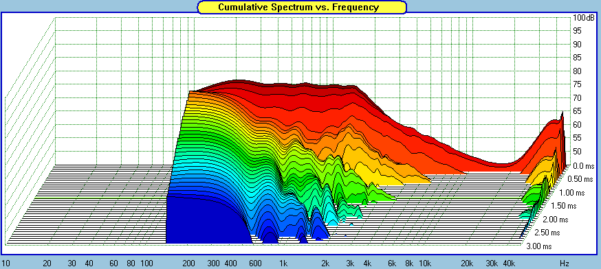

Probably because within reason, severe concentrated resonances like in the RS180-4 mentioned aren't very important because the driver will never be listened to (except by a handful of extremists) as-is, so it's the filtered performance that counts.Another important aspect of (cone and other mechanical) resonances is decay of them, most often visualized as CSD. Differences in this are huge, but assessment and audibility tests are nonexistent.
It's difficult to link properly to John's site when something is buried within a wider page, so quoting, with clear reference to John Krutke as the author (www.zaphaudio.com), without any selective editing, & using the examples he provided in order:

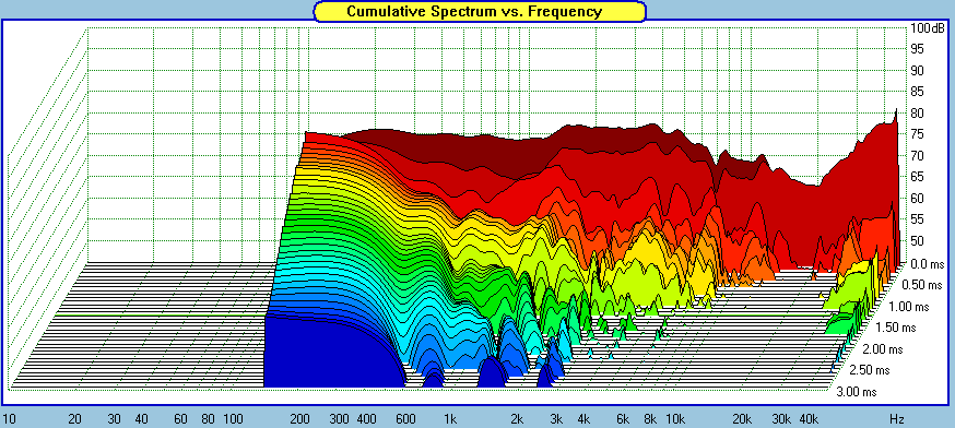

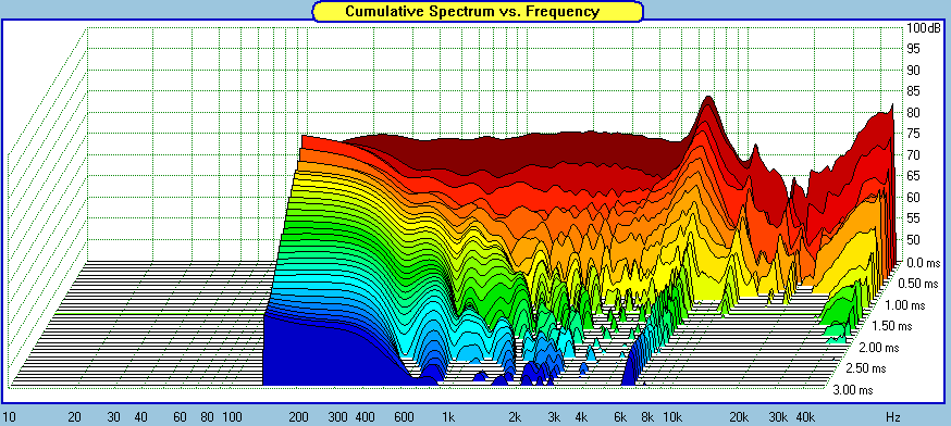

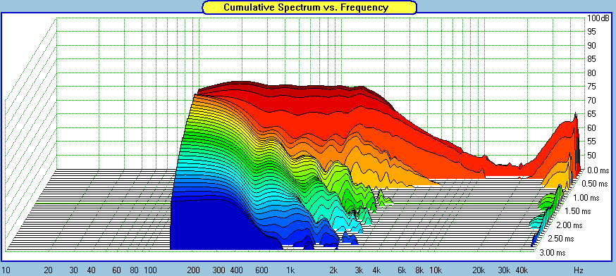

[These are the labelled 01 & 02 images attached]As I've said several times before, the cumulative spectrum decay (CSD) is a highly overrated form of measurement and is merely a different way of looking at the frequency response. It's all generated from the same impulse and it's all linear distortion. Yet, the CSD is often misread. To make a point, I'd like to present two CSD's done under the same conditions - one for a poly cone driver with a well damped breakup, and one for a metal cone driver having a harsh breakup 6.5kHz.
[These are the labelled 03 & 04 images attached]Which looks better to you? To the person who does not understand linear distortion, the metal cone driver looks horrible. The huge ridge of energy storage looks scary. To the person who does understand linear distortion, the metal cone driver is the slightly better one. This is because the metal driver is perfectly smooth within the operating range that it will be used, while the poly cone driver has a "shelf" of energy storage at about 1500Hz. The metal cone driver is operating closer to a pure piston below 2kHz.
