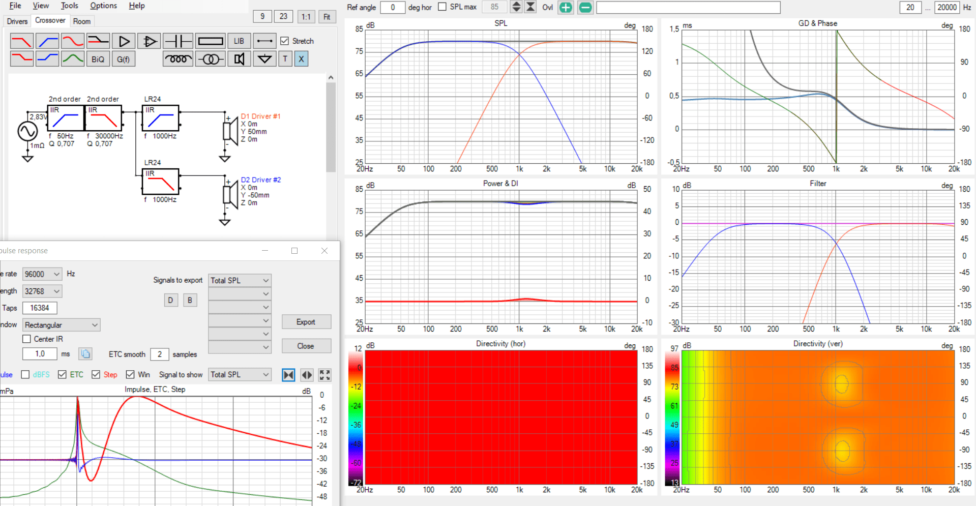

^Yeah, play with VituixCAD ideal drivers, realtime to see what the system response is 😉
Ideal driver, flat response DC - light to all directions
And as soon as its bandwidth is limited by physics, which I emulate here with simple filters, the perfect transient response goes away. View attachment 1107020
More deviation with increased group delay
So, define "response is DSP:d flat"?🙂 We can't have systems that would play DC. Also, our systems usually have varying response to any direction, so the impulse is as perfect as it can be to one direction only, or maybe...

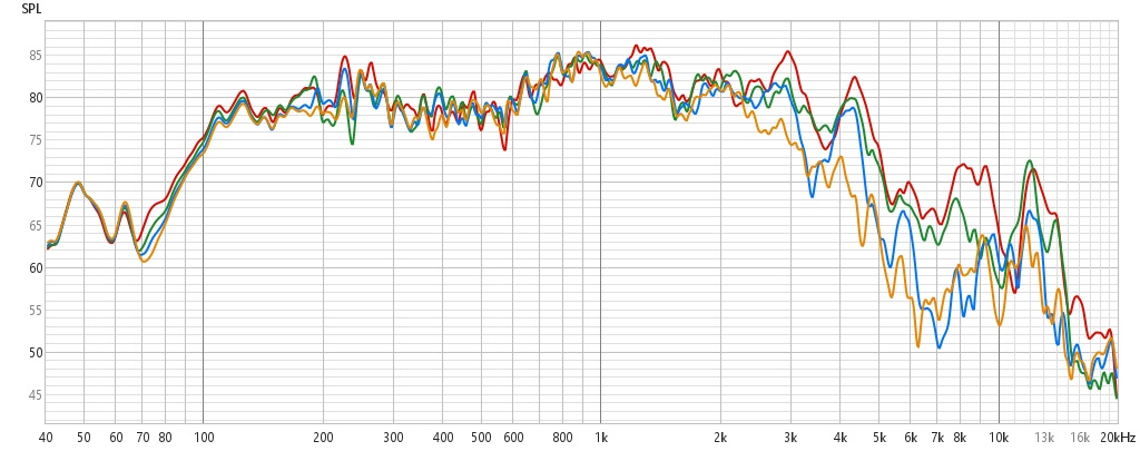

And I would like to point to my personal Tang Band W6 driver with a pic on topic of this thread (cone breakup):
This is FR taken on axis and at various angles up to 45+ degrees. I want to stress that I always measure not in the middle of the room at stand but at the computer desk 1 ft from the wall with table, walls and monitor reflections. This is the real listening position result. 600 Hz is the baffle step, not the driver. 250 Hz is the backwall.
My understanding is that as long as the driver movements are pistonic it radiates remarcably identical on wide ranges. And then the cone vibrations are becoming surface wave moving differently at different areas of the cone, which manifests with random fluctuations at different angles. It starts at 2,200 Hz, and that's where I need to cross. This woofer has the cone breakup frequency of 2,200 Hz.
I want to stress that those peaks at 3 and 4.5 are creating major, major audible distortions, this is not about measurement, I have 100s of hours of listening on this driver because I actually like it a lot.
The W6 tweeter has the resonance frequency of 1 kHz, so I need a very sharp tweeter rolloff to make it -30 Db from 2,500 to 1,000. And I want the woofer to be like -10 Db at 3,000.
Also, this woofer has a great punch and very clean pleasant bass, to keep it I want to keep only one single element at the signal path, and it will be 14 gauge 2 mF inductor, and do the rest with serial notch filters across the signal path, this doesn't affect the sound.

@wchang tb w6-2313 coaxial. I accept some 3 Db wiggles in the response as an inevitable price for having the perfect imaging and drilling only one hole in the small desktop setup. I don't feel any difference in sound when I move my chair or decide to sit deeper. With 60 cm distance from my ear to the cone it's a nice feature. You saw above 0 and 45 degrees are identical. I understand it's impossible to make it flat. I will play with wool, good idea, thanks, will take some time though. I want to put wool over perfect XO, and not making XO over wool 🙂

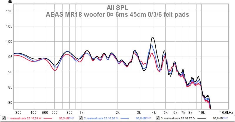

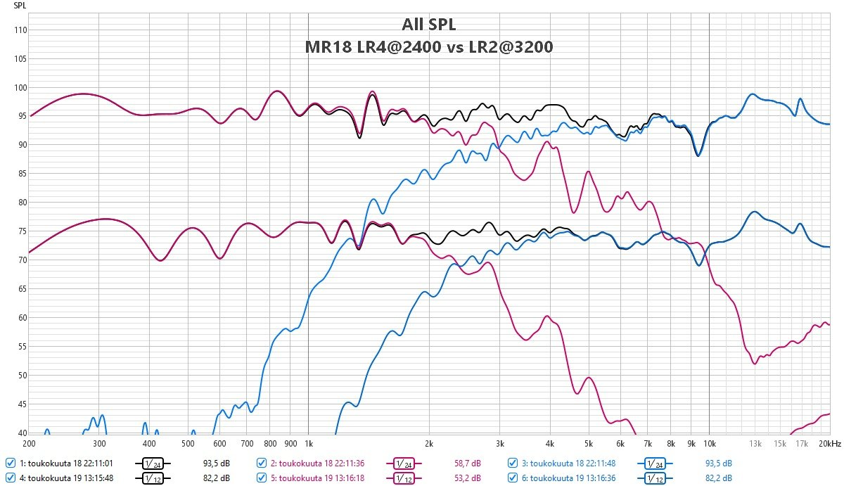

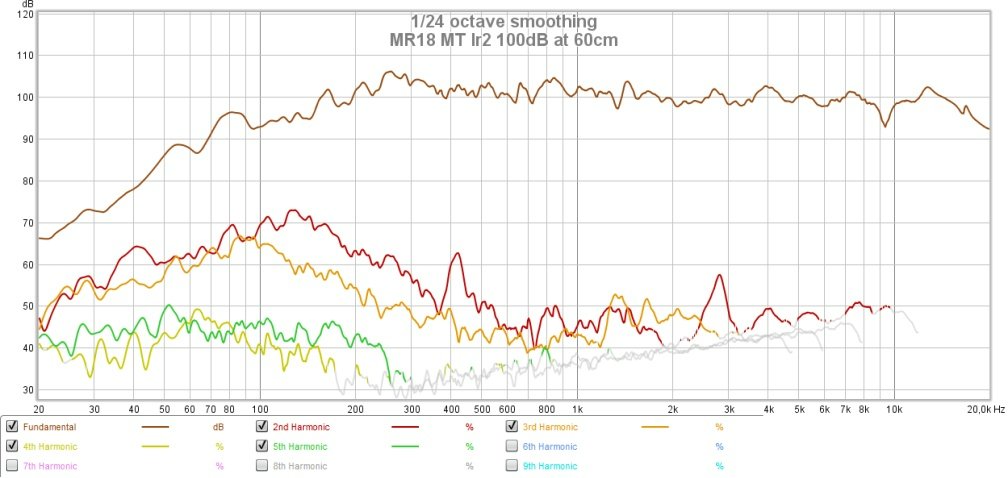

I use small synthetic selfadhesive felt pads to tame cone resonances of SEAS MR18 woofer. I didn't save .mdat files.
The thread from 2018 is here https://www.diyaudio.com/community/threads/seas-mr18-3-way.322839/

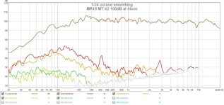

Overlays of two very different xos for M/T (without felt pads). Most saved measurements are with too low spl to see distortion.

About using harmonic distortion to assess the Intermodulation distortion, which is indeed hard to measure because it requires to play multiple frequencies. I'll post again the same measurement as above #189 but with 3rd HD:

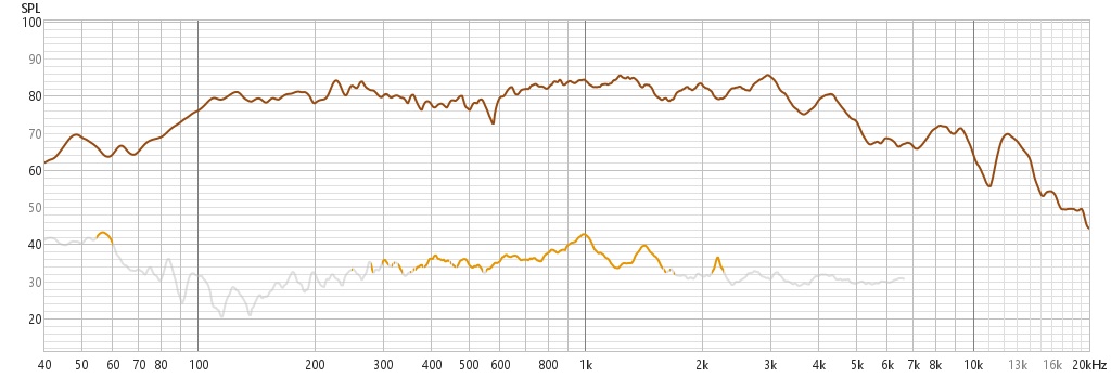

We are talking about the same 3 kHz cone breakup from #189. Here it creates the peak at 1 kHz, as 1,000 * 3H = 3,000.
This peak is at 42 Db, with main signal at 84 Db, so it's 42 Db = 0.01% distortion measured as a harmonic one.
So, can I hear a 0.01% harmonic distortion? Probably not, I won't bother trying to set up a listening test trying to detect it.
Can I hear the IMD that can be measured with HD test that pinpoints the distortion area with 0.01% peak at HD3 graph?
Absolutely. I don't just hear it, it hits me with pain in the ears with dozens of test tracks listed in #193, I grade this distortion well above acceptable and I am working for weeks trying to find the XO to fix it. I refuse to accept my speakers in this state until it's gone.
So the conclusion is that the 0.01% Intermodulation distortion measured with H3 is way louder than the audibility threshold. I suspect that threshold will be at the end somewhere in the 0.003% area but I will report the exact number when I have it.
