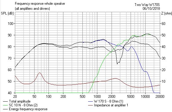

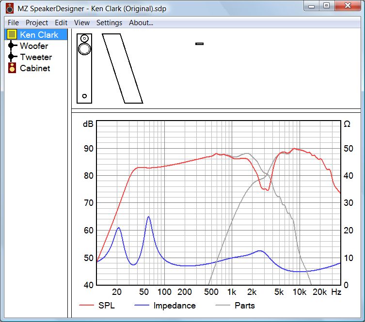

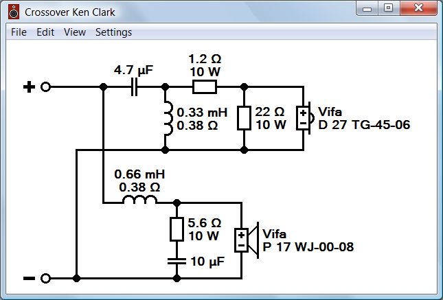

Let's have a concrete example, rather than all this awful waffle then!
Me and Dissi are currently trying to salvage an inept 6" plus 1" design in another thread. TBH, we are both winging it a bit, but are interested in polycones, which are famous for having very little breakup.
Dissi is pretty good at this sort of thing. It is using the famous old Vifa P17WJ-00-08 polycone, Vifa's FR is below. TBH, you've got to be pretty clueless to get a bad result with such a tidy driver. But the poster HAS succeeded in messing it up totally.
Here's what Dissi has got for the useless filter.

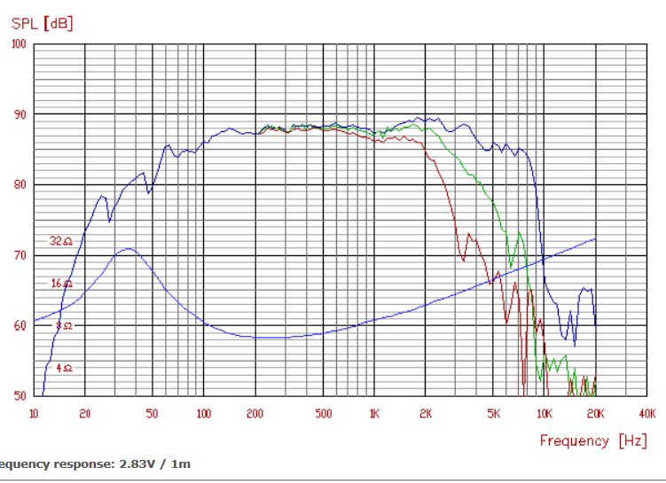

Below is what I get for the same dreadful filter with a 6" paper Visaton W170S cone. But you CAN see the paper cone has much more breakup at 5kHz. Either way, a bass filter with more bafflestep and rolloff is indicated.
IMO, breakup notches are dubious things. I think there is a better way. But that's another topic.

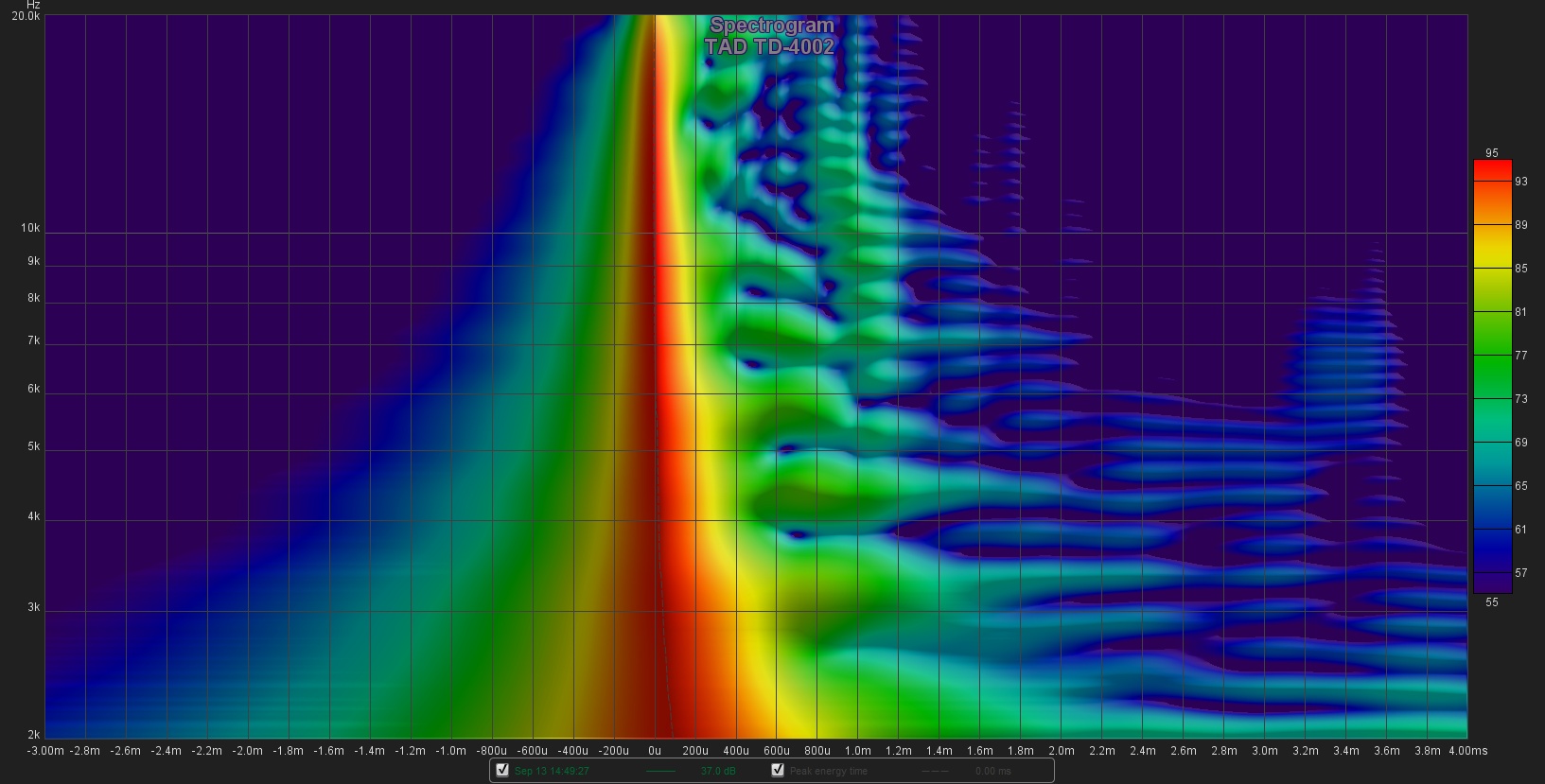

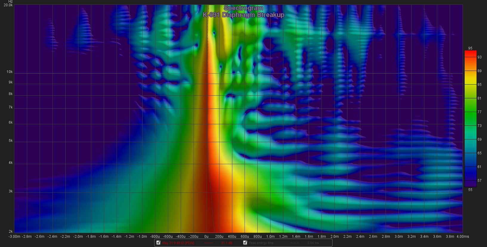

You didn't see this? Look at the ~3-6 wavelength delay "slap" at 12-20 kHz, plus the degree of pre- and post-impulse chatter relative to the TAD TD-4002:
This is diaphragm breakup, or more accurately bending modes, that is significantly altering the desired output waveform as viewed in the time domain.

On the basis of what aspect of the spectogram do you deduct is the diaphrapm only (so to speak) and not other aspects of the driver-horn combo?

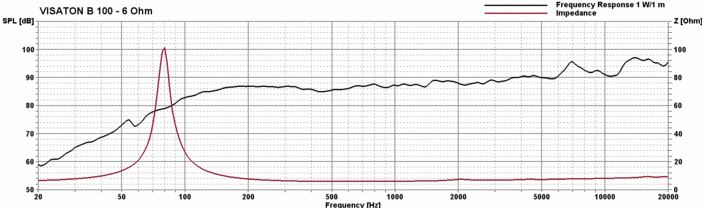

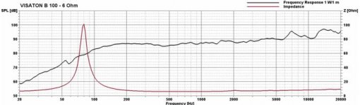

I said earlier that 8" drivers breakup up at 3kHz. 6" at 5kHz. 4-5" around 7-8kHz. Even a fullranger does not defy this rule.

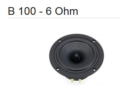

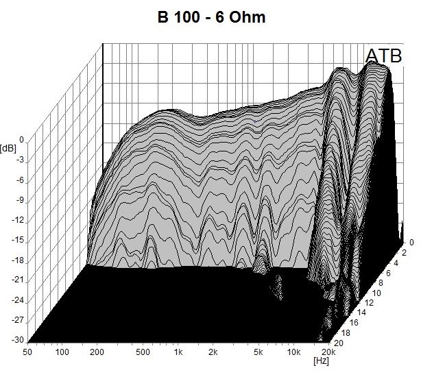

Visaton have recently introduced a rather splendid pricey 4" fullrange:
B 100 - 6 Ohm | Visaton
But I'd use that as a mid. You can see why it is problematic above 7kHz. The CSD shows the stored energy, aka breakup. More manufacturers should publish the waterfall, IMO. It is particularly revealing for tweeters, and often shows the useful crossover point below which things go to hell.
I can see it is the same horn, but the geometry plus matching to the horn mouth cannot be disregarded as a potential source of trouble.
Again, I suppose you might take the position that it's the horn, but it seems more likely that you are simply not allowing yourself the opportunity to see that what is being described is actually occurring.
However...and once again for learning opportunity...look at the second spectrogram closely. It is the same horn measured from the same measurement location, levels, and configuration. The diaphragm doesn't break up because the material itself is roughly 6x better (a utility measure of the combined lightness and stiffness advantage) than the titanium in the first case. It's really difficult to look at the second spectrogram and claim "...It's the horn. It's the 'geometries'...but it's anything other than the most likely thing...", i.e., diaphragm bending modes.
There seems to be some sort of reader resistance to this information provided, which I'm at a loss to explain. Why would you continue to push measurements and plots that eliminate the time domain when looking for the difference between simple resonance and diaphragm break-up modes, i.e., Bode plots only?
I think it's much more than a very safe bet that what I'm describing (correlated to what I hear) is true and is the most likely and reasonable explanation for the 3-6 wavelength delay "slap". I know that since I've moved on from this observation, the ground that I've covered has been extremely productive. It has allowed me to look for drivers that don't have that characteristic--via measurements--and the resulting sound is a whole lot better.
Chris

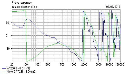

Apart from the Waterfall, the other indicator of breakup is the phase plot which also shows stored energy. You can see something rum is happening at 3kHz with this 8" paper driver:
As TMM said, you can't just equalise it away, becasue simulators really don't know anything about all the bending modes of a cone or dome. And even if you do equalise it, the modes will be excited by distortion products from lower in the range.

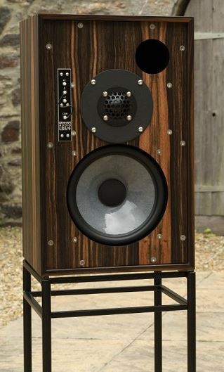

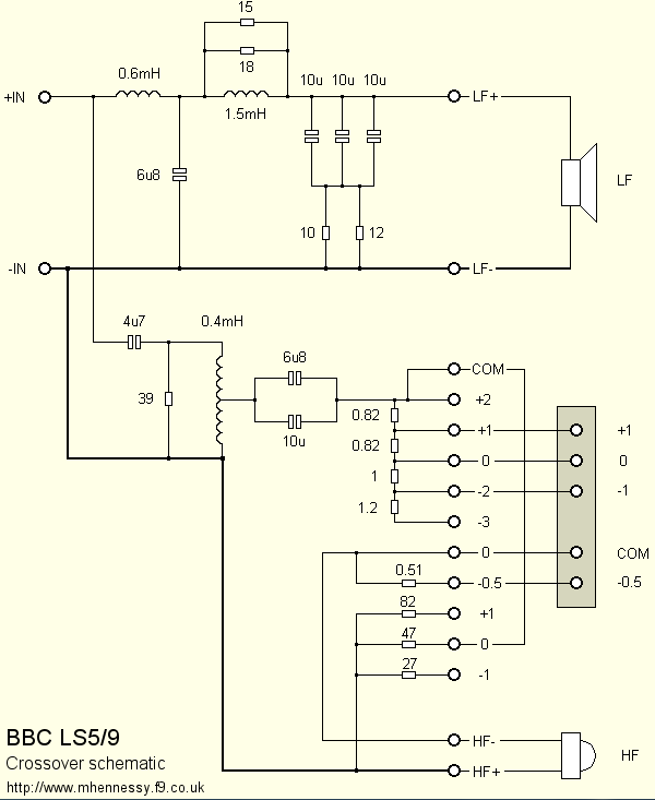

The BBC LS5/9 polycone/soft dome with 3kHz crossover was designed for an active filter. It never needed one, because the passive filter was so good.
You've got to know what to measure to understand it. It's that the bass unit sees a very low source impedance anyway. This gives a little more control and damping than most bass filters. It also has a very flat impedance at the driving amplifier. Win-Win, IMO.

...Apart from the Waterfall, the other indicator of breakup is the phase plot which also shows stored energy. You can see something rum is happening at 3kHz with this 8" paper driver:
...you can't just equalise it away, because simulators really don't know anything about all the bending modes of a cone or dome. And even if you do equalise it, the modes will be excited by distortion products from lower in the range.

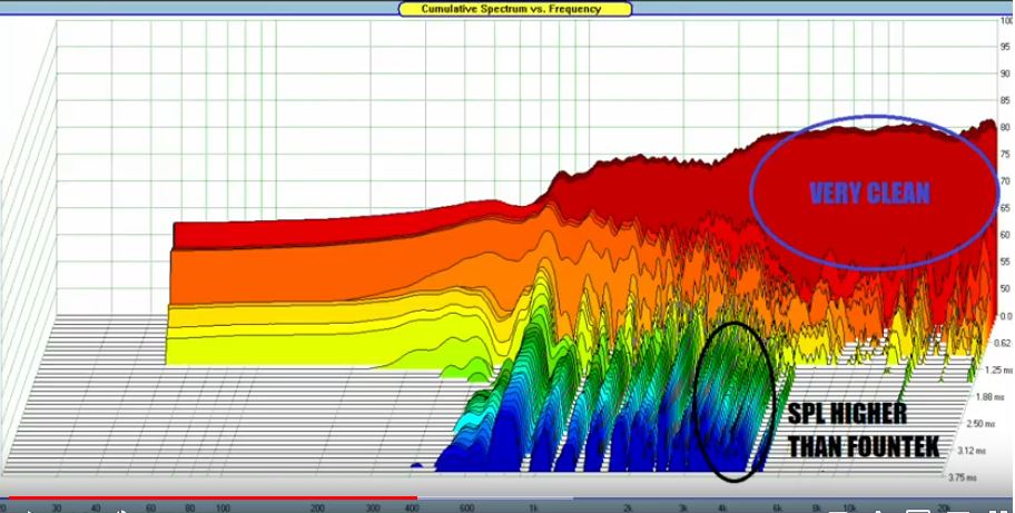

This video about ribbons is fascinating. I like Ryan and what he does in the Impulse Audio channel. YouTube
I think this is the video where he plays guitar to convince you 3rd harmomic distortion is much more annoying than second. IIRC, 3rd harmonic comes from asymmetric frequency response, but I might be wrong there.
But I just look at that $500 ribbon GRT 145 waterfall and say cross over above 4.5kHz! No brainer.
FWIW, the GRT is unusual amongst ribbons in having a surround. Maybe that explains its rather good control at low frequency. Well, better than most ribbons.
