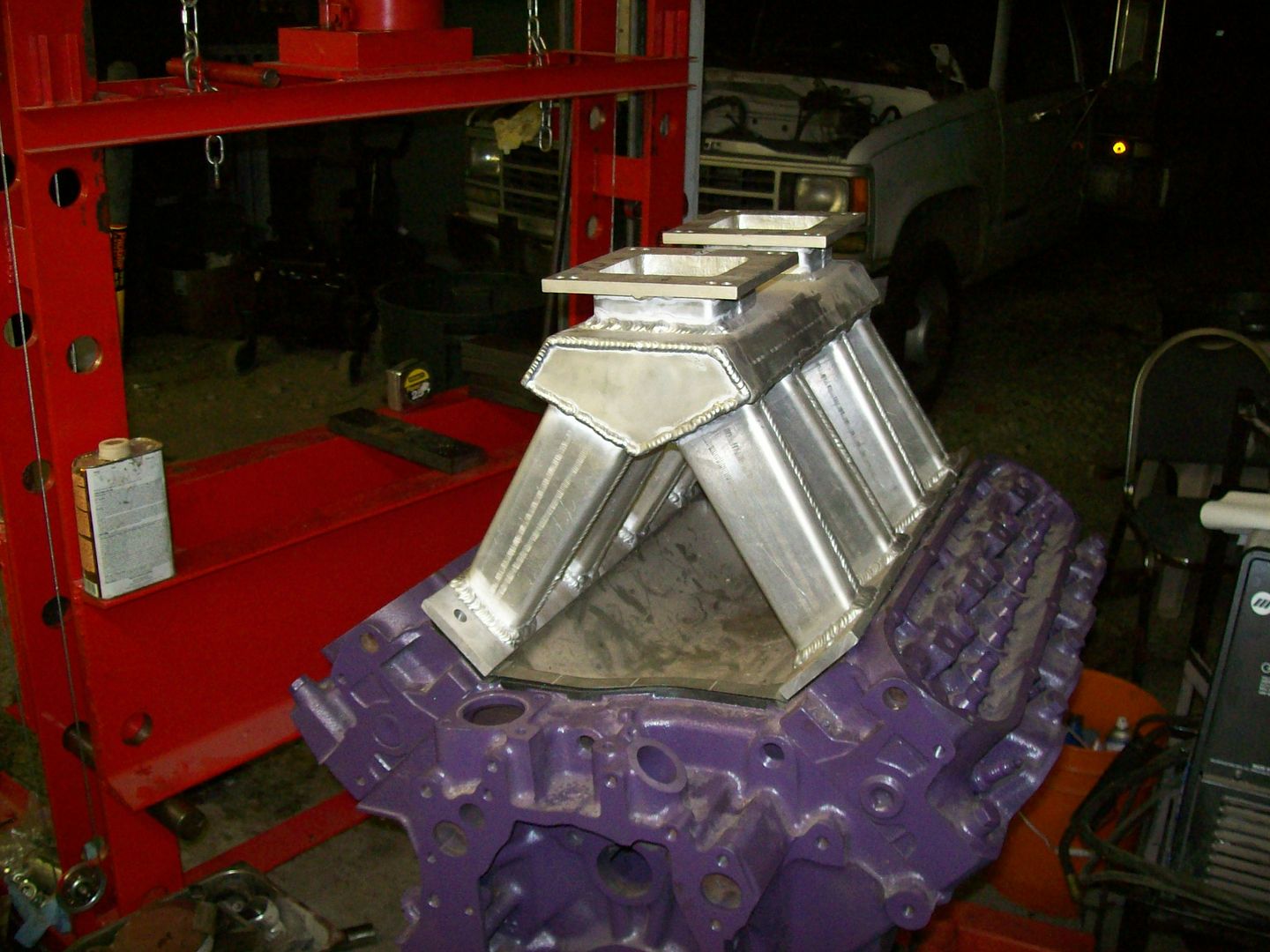

Below is an intake I built for one of my jet boats (Caddy 500). I also built the red press. I’ve yet to retrofit an old engine with modern fuel injection. That's another item on my bucket list. . . .
