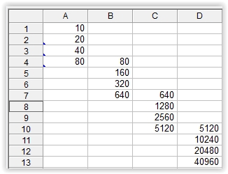

50 watts into an extremely large horn capable of 116dB using one watt at one meter would produce a shade over 131 dB at one meter using 50 watts, but Entropy Eric plans to listen to the horn around 24 meters distant, at which point the SPL will have dropped at 6 dB per doubling of distance to only 101 dB, not much on the excitement factor if he's been near the front rows of a Red Hot Chile Peppers concert, where LF levels can exceed 131 dB by a good margin.
To get the equivalent SPL of the 50 watt amp at one meter, at 24 meters will require 30 dB more power, 50,000 watts. That will require a lot more drivers than Entropy Eric's original plan, but larger drivers with more Xmax like the B&C18SW115-4 could do that SPL level with around 10 or so, using a mere 25,000 watts.
Taking the inverse, if a pair of drivers like the B&C18SW115-4 were used in a hot tub sized sub located 2 meters from said listening position, they could produce 131 dB output using around 6000 watts, that power only costs $450, and can easily be run using a 10AWG extension cord from the shop, or run off the same service that runs the hot tub that Entropy Eric has indicated will be his usual listening position.
Perhaps this little bit of math makes it clear why I have questioned the distant placement of the subs once Eric indicated the small nature of his desired listening location.
I do not want 100 dB at 24 meters - thus I need to rethink my design.
Assume for the moment that I build a 25 kW bass horn, feeding (qty 10) B&C 18” drivers (which I am completely onboard with doing – because the ends justify the means. . . . . and because I like the idea of achieving concert-level sound – should the need arise. . .)
Question - for my highs, I was leaning towards Radian 850PB-8 drivers, with off-the-shelf rectangular cast-aluminum horns (unless I get really crazy, and fabricate some tractrix horns out of stainless). If I crossover the radians around 800 Hz, I can get about 138 dB (1 meter) without overload. I've read that although Radian advertises this horn driver as being able to hit 20 kHz (which I'm not sure I can even hear over 17 kHz anymore) - customer reviews have strongly recommended a 5 kHz low-pass, and running a dedicated bullet-tweeter from 5 kHz and up - which I might do. . . I was originally planning on two compression drivers for the highs (one Radian 850PB-8 per channel). If I design for 131 dB maximum acoustic output at 24 meters, what do I do with the Radians? I’d need at least four (maybe 5) 850PB-8 drivers per channel, right? Assuming I purchase the off-the-shelf rectangular cast-aluminum horn lenses, do I simply stack them vertically? Do I curve them a bit – to form a high-frequency horn array?
I currently own (qty 3) crown MT-3600VZ amplifies, (qty 1) crown MT-5000VZ amplifier, (qty 2) crown DC-300A-2 amplifies – all are available for this project – and I’m willing to buy more power if needed – MUCH more power if needed.
That being said - 131 dB at 24 meters (from 20 Hz up) seems like a pretty darn aggressive sound system. Would 121 dB at 24 meters still achieve the desired wow factor? And not require my guests to put in hearing protection when I’m throwing a summer party? I honestly don’t know the answer to this question – I don’t have a good engineering feel for how much SPL is required outdoors. . .
1)Assume for the moment that I build a 25 kW bass horn, feeding (qty 10) B&C 18” drivers (which I am completely onboard with doing – because the ends justify the means. . . . . and because I like the idea of achieving concert-level sound – should the need arise. . .)
2)Question - for my highs, I was leaning towards Radian 850PB-8 drivers, with off-the-shelf rectangular cast-aluminum horns (unless I get really crazy, and fabricate some tractrix horns out of stainless). If I crossover the radians around 800 Hz, I can get about 138 dB (1 meter) without overload. I've read that although Radian advertises this horn driver as being able to hit 20 kHz (which I'm not sure I can even hear over 17 kHz anymore) - customer reviews have strongly recommended a 5 kHz low-pass, and running a dedicated bullet-tweeter from 5 kHz and up - which I might do. . . I was originally planning on two compression drivers for the highs (one Radian 850PB-8 per channel).
3)If I design for 131 dB maximum acoustic output at 24 meters, what do I do with the Radians? I’d need at least four (maybe 5) 850PB-8 drivers per channel, right? Assuming I purchase the off-the-shelf rectangular cast-aluminum horn lenses, do I simply stack them vertically? Do I curve them a bit – to form a high-frequency horn array?
4)That being said - 131 dB at 24 meters (from 20 Hz up) seems like a pretty darn aggressive sound system. Would 121 dB at 24 meters still achieve the desired wow factor? And not require my guests to put in hearing protection when I’m throwing a summer party?

Eric,
1) As stated before, "concert level" in the front rows of a RHCP concert can go well above 131 dB, though the cabinets used by Dave Rat don't go much below 35 Hz, reducing the size needed to produce around 140 dB by a huge factor.
2) 138 is a theoretical number based on power handling and sensitivity. In reality, the non-linear nature of air when nearing 160 dB in the throat (easy to figure using the inverse square law, and I have confirmed the levels by measurement exceed 160 dB well below thermal limits) limits output to a few dB less than theoretical, and although the Radian and other drivers voice coils can survive the thermal demands, they will start to sound horrible (distortion well in excess of 10%) at a fraction of their rated power. The splitting up of the frequency range using two HF drivers is the "classic" way to mitigate the distortion problem.
3) Generally speaking, most concert systems HF output is 10-15 dB less than the low frequency, and depending on how much of a LF "haystack" employed, may be closer to 20-25 dB less. As the saying goes "tweeters don't get the party going, it's all about the bass".
That said, to keep the HF "clean" will require several HF drivers per bass driver. To deliver non- interfering, summed HF response using multiple horns requires them to be designed for the purpose intended, either using multiple very narrow HF devices (like my "Maltese" 11x11 degree horns with 115dB one watt one meter sensitivity) or narrow vertical throat adapters such as the 1992 "Vdosc" line array patents describe, or any number of others developed by competing companies to effect the same end. The choice then becomes whether you go point source, with less throat distortion, but worse polar response, or use the HF line array approach.
Having used Tom Danley's "Paraline" HF horn coupling in a small format horn loaded line array, and the Maltese horns, which are the cleanest sounding horns I have experienced, regardless of designer, I can say with no reservations that the Paraline sounds better in multiples than the narrow, "non overlapping" approach. That said, if you placed the system near the listening position, a pair of 3" diaphragm drivers on a horn of the proper dispersion to cover the area will sound better than any multiple driver system from a distance, unless you are after the reverberation such a distance will afford.
4) 121 dB in the bass range is about 20 dB less than at a loud concert. It only takes a 6 dB reduction in SPL at 40 Hz to sound half as loud. Do the math, measure your wife's bass rig, and answer for yourself.
