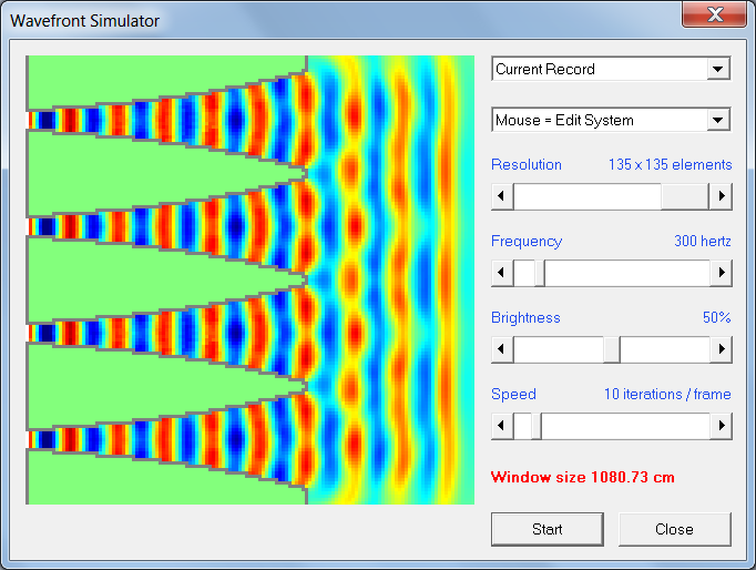

The attachments show the plan view of four side-by-side rectangular 15Hz exponential horns. Each horn has a mouth 8' wide x 14' high. Attachment 1 shows isophase wavefronts at 100Hz. Attachment 2 shows isophase wavefronts at 300Hz.
This illustrates my point quite clearly.
If the wavefront was completely flat as a pancake exiting the horn and stayed completely flat as it propagated past the mouth the wavefront would be completely in phase and it would be a solid color all the way across.
But it's not, there's considerable interference across the wavefront as a direct result of the curved wavefront even as low as 100 hz.
I am still not convinced that there's a problem that needs fixing.
If I achieve a "wall" of stereo sound waves, that drives deep down to 15 Hz cleanly, then mission accomplished! A little unevenness within the sound field is not a deal breaker for me (this is a backyard DIY project). I'll have weatherproof outdoor horns, 100% free of room nodes, that will last for 50 years. I can play hide & seek with my kids in the horns, and they can pay hide & seek with their kids. And should I ever feel the need to sip tea, I'll simply place my chair within the one sweet-spot that has minimal lobing. . . . .
so these plots do contradict JAG's assumption that combing would occur in the listening area in front of Erics currently favored four-horn-array, don't they? If the wavefronts exiting the horns are coherent, there should be no comb filtering, right?
If the waves were fully coherent they would be a solid single color all the way across the wavefront of all four horns. But it's not, not a 100 hz and definitely not at 300 hz.
The narrow beams and comb filtering are what make the wavefront not a solid single color all the way across.
