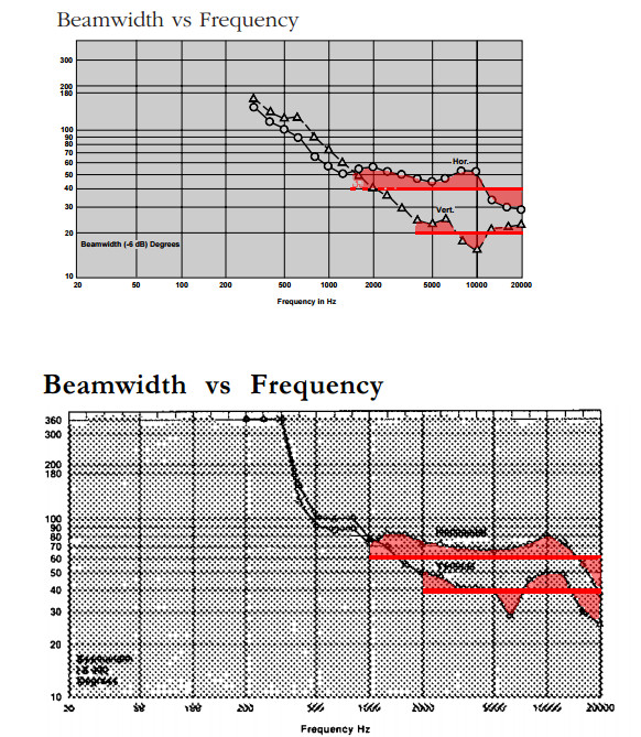

I think it is angle and mouth size that matters for this, not the throat.
This site is pretty good at explaining directivity: Understanding Horn Directivity Control
For me, the surprise (it seems counter intuitive) was that narrow dispersion needs a bigger mouth.
For a practical example: JBL horn specs give good directivity info.
https://www.jblpro.com/pages/components/2380ser.htm
The 2385a and the 2386 horns have exactly the same mouth size, 279x445mm, and exactly the same throat size (for 2" drivers). The 2386 is 50% longer, with a narrower pattern (also known as 'long throw').
The 2385a horn has a nominal 40 degree vertical coverage. The beamwidth graph shows widening vertical pattern below ~2kHz.
The 2386 horn has a nominal 20 degree vertical coverage. The beamwidth graph shows widening vertical pattern below ~4kHz.
That is: halving the angle for the same mouth size = an octave less control.
Note (and apologies if this was already obvious): part of the SPL boost of horns is due to their directivity. Again, referencing those two JBL horns:
The wider 2385a specs less gain from directivity but more bandwidth for it (Average Range: 1 kHz 16 kHz) vs. the narrower 2386 (Average Range: 2 kHz-16 kHz)

Here is a scribble enhanced excerpt from those spec sheets, as a real example of the relationship of coverage angle vs. the frequency that control is maintained, for two horns with the same throat & mouth sizes.
20x40 on top
40x60 below
--> note there would be less pink scribble below ~12kHz if JBL had have added 10 degrees to their nominal horizontal patterns, and called them:

In general, it would be beneficial if your rigging system allows you to tilt and point your loudspeakers precisely. No point in hoisting them up if they dangle about randomly like christmas tree decoration....😀
Hoisting up the mains has two main benefits and one drawback.
Drawback: distance to listener increases, sufficient headroom is needed to counteract.
The benefits:
1. more even SPL coverage = less variation in level between front and back.
2. the stereo triangle is no longer just in the horizontal, but also vertical. This means if you tilt the mains a little bit down so that they also cover the space close up to the bass horn mouth, you should get good a good stereo image from the mains up close to the horn.
Keep in mind that the dispersion of your mains and the orientation will determine coverage. One more parameter to play with. You can optimize to get good coverage close to the horn and at your hot tub listening spot, or point your speakers to cover the hot tub and far field beyond it at the expense of the area close up to the horn.
On the other hand in practice I have to say, with a ground stacked stereo system spaced about 8m, you can get a nice coverage and stereo effect.
Also, I was going to go square mouth, however TB46 recommended something much more rectangular (lower profile). I have no preference either way - I just want to achieve my goal, of getting that sound I'm looking for. . ..
making the horn wide will help the coupling to the mains if you choose to have them lowish (just above ear height).
If we are talking larger kick-horns (which I’m assuming we are – 8 to 10 or so, 12” horn-loaded drivers per side – a first approximation guess),
Look at the system in my picture. 6 x 18" rear loaded horn for under 80 Hz, 2 x single 18" front loaded horn for 80 - 200 Hz, 4 x 12" FLH 200 - 1000 Hz, 4 x 2" (2x EV DH1 and 2x JBL 2445 on 2380) for 1 kHz upwards.
sub to kick ratio is 6 to 1. I'm confident your horn can do both. above 150 - 200 Hz there is increasingly less excursion required. I'm also confident you will not need a big array of kick horns. You should be able to cross over directly into a sufficiently potent full range horn loudspeaker, like Art's SyntripP, the Peter Morris DIY top, or any fully loaded commercial horn top.
