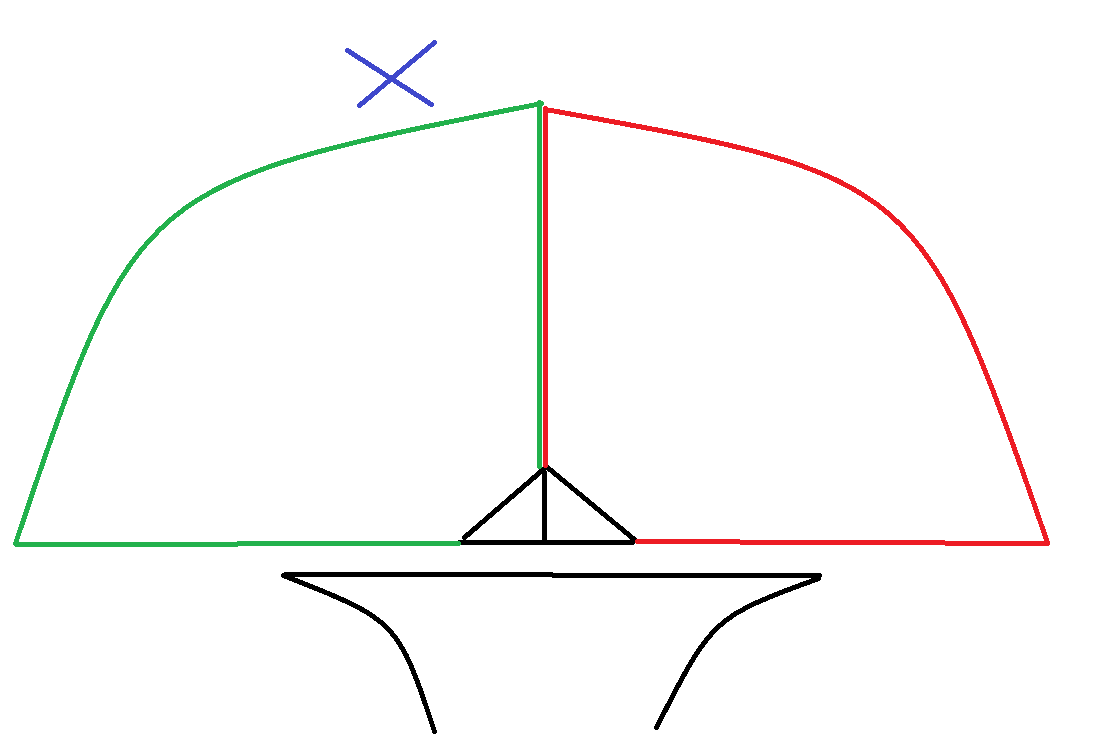

Here's a super high quality image to show the concept. This is a top down view, the bass horn mouth is obvious enough. The two triangles back to back are two triangle shaped horn mains with approximately 90 degree horizontal coverage (each). The green part of the hemisphere is the the lower frequency 90 degree radiation pattern from the left speaker, the red is the radiation pattern from the right speaker. They don't overlap so they don't destructively interfere with each other, and clearly they can be placed very close together and right on the sub horn exit axis if desired to avoid interference issues with the sub. Now you can cross over as high or as low as you like and have no lobing issues.
The only problem with this is that obviously the horn loaded mains will become directional with higher frequency so if they beam too much the center position of the audience doesn't get good high frequency coverage. But there's ways to deal with that, this is just a concept showing close mains placement as a way to avoid lobing and allow for a high crossover frequency. There are many different ways to apply this concept (with differing radiation angles and different placements. It doesn't have to be two mains spaced 30 feet apart and toed in to point directly at the middle of the audience as the OP is suggesting.
Note that the midrange horns would have to be VERY large for this to work with zero overlap, even with a 200 hz crossover the mid horns would have to be very large to limit their dispersion to 90 degrees, but OP wants big horns for the entire frequency band so ...
Some separation of the mains is ok, some overlap is ok, this is just a concept to show the exact opposite of what OP is planning can work too.

So listening at 'x' he wouldn't really be getting the left channel ?
I think it would need to be mono to work ?

Yeah, I probably should have explained this a lot better. There has to be some overlap, it has to overlap everywhere that a listener would be standing but it doesn't have to overlap before the audience area. If the main listening position (the hot tub) is 30 feet out you don't need overlap until you get 30 feet out unless there are going to be people closer than that on a regular basis.
This is just a concept drawing to show that coverage patterns can be controlled with directivity, and that the mains can be very close together instead of the proposed 30 feet apart. With a close mains placement you can avoid lobing issues and cross over very high if desired. But yes, the coverage does have to overlap the audience position.
