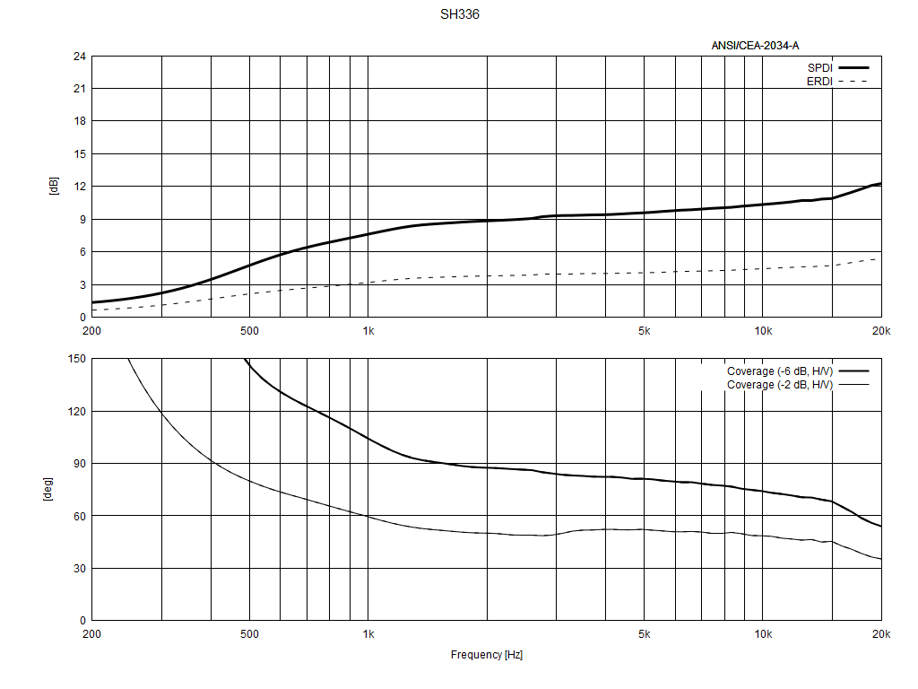

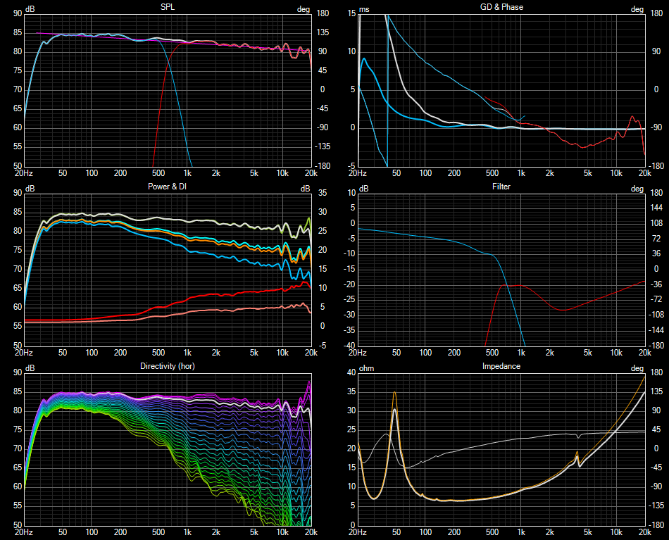

Playing on low volume in a small living room 25m^2 I'm using HF108-8 with 8-order high pass filter (DSP) and ~700 Hz xover point in a 32cm self-standing "Sandhorn" designed by MaBat.
- http://www.at-horns.eu/lsh.html
Vertical simulations of a loudspeaker and the horn itself attached.
