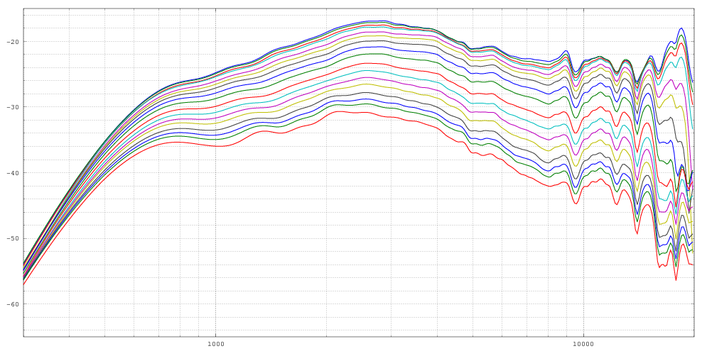

Here are raw measurements of Faitail HF108 in the 32cm free standing Sandhorn from MaBat. It sounds "normal" for me, but I have it just for home/indoor listening. There is a large thread about ATH waveguides https://www.diyaudio.com/community/threads/acoustic-horn-design-the-easy-way-ath4.338806/

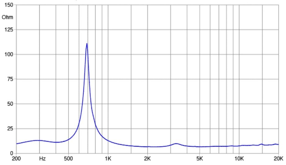

@miero The 17k peak in that horn with the HF108 is interesting. I've never observed that on other horns using that driver. There is a small peak at 15k in the factory impedance curve, but nothing like that has come through in my tests. Maybe its because my horns weren't that effective up there.
I will add that the HF108 does need a little tweaking from its out of box performance. Its an excellent driver for use with a 12" coax because it can cross very low.
An important note about this driver - I've noticed the diaphragm sometimes isn't centered very accurately from the factory. It benefits from a little TLC, especially if you want to use it very low past the recommended cutoff. I've run it down to 800hz a few times and it dealt with this quite well given SPLs weren't pushed too hard. The driver itself has a primary resonance at 700 hz which should be notched if you want to push the HP down under the Faital recommended 1300 hz.
