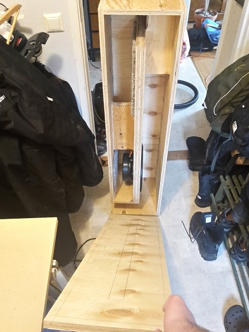

I built this simple tapped pipe design as a very cheap home theater sub for a friend, but the Fane 10 inch driver did not last very long.
GAS ALPHA 10D2 | GAS | Billjud | Brl.se
I needed a strong heavy duty driver with a quite low Qts and a strong cone that could take the quite large warping pressures inside the tapped pipe without complaining. The GAS Alpha 10 has a published Qts of 0,30 and I am inclined to believe the published Qts even though it is a cheap car audio driver.

Johannes,
did the GAS fit into this slim box? It seems to be substatially deeper than the Fane... From the pic I take it that the box is approx. 30x30x100cm external?
There was one single mm of clearance behind the magnet in the tapped pipe. This is not optimal, since it blocks of the air flow through the pole piece. I did not want to build a new box. I knew it was a tight fit, but I hope it will survive. It is a home theater sub, so it should never have to endure prolonged periods of intense use. It is usually most explosions and collapsing buildings and stuff. The Gas Alpha 10D2 seems like a very rugged driver.
The baffle is 36 mm thick - two layers of 18 mm plywood. This is a way to get a very robust and stiff mounting of the driver, and a way to get more clearance behind the driver.
If I have to build another box, it will be tuned a few Hz deeper and I will increase the distance behind the driver to ease the airflow and cooling of the driver.
