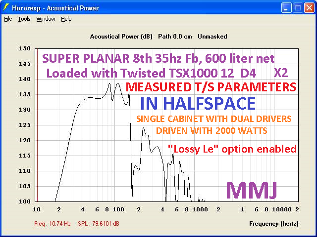

The original plans for the box based on the published parameters is now no longer appropriate .... Once our friend Barnaby measured the drivers and saw the real T/S parameters he realized that a different cabinet will need to be designed .....
We found out that the measured parameters will work in a Super Planar 8th but the cabinet is large , however he says he does have a lot of space ... We will see .. . Brian also produced an OD-QWP (TL) model which will be a great solution for using up much less space ............ So if Barnaby cannot get Twisted to take these drivers back (and is left stuck with them) at least he has some viable options :)

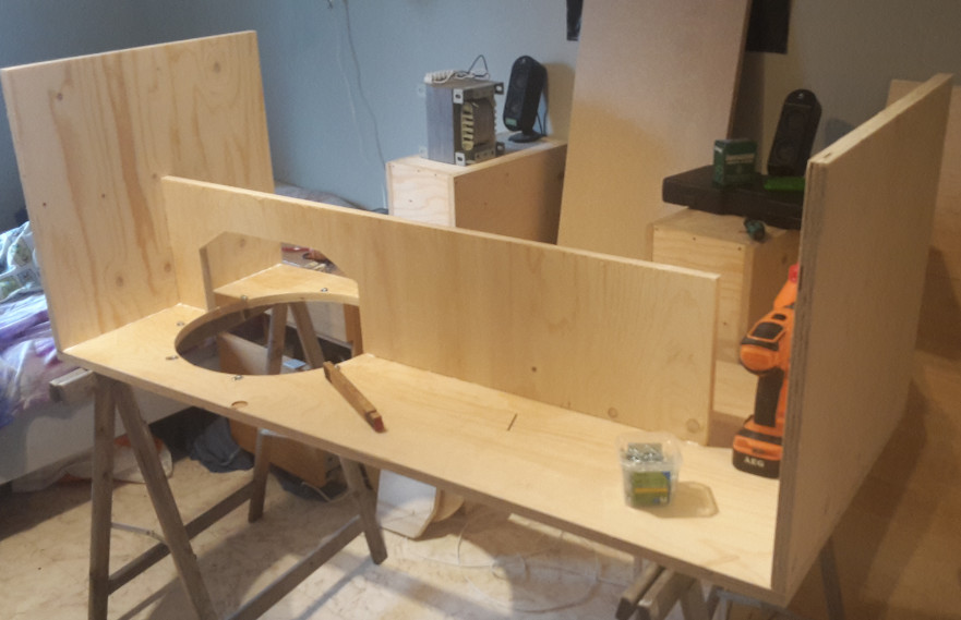

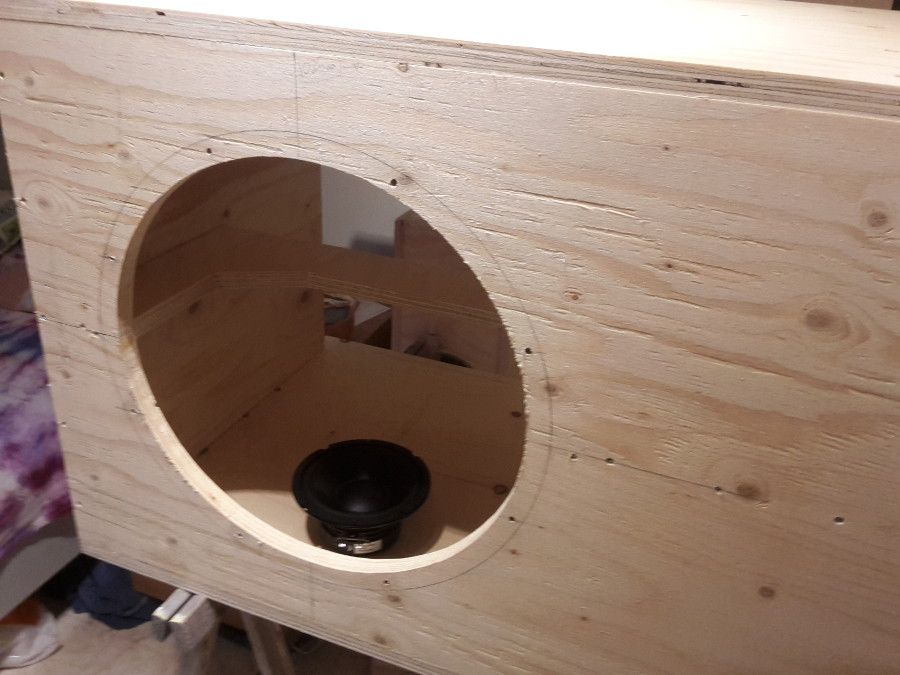

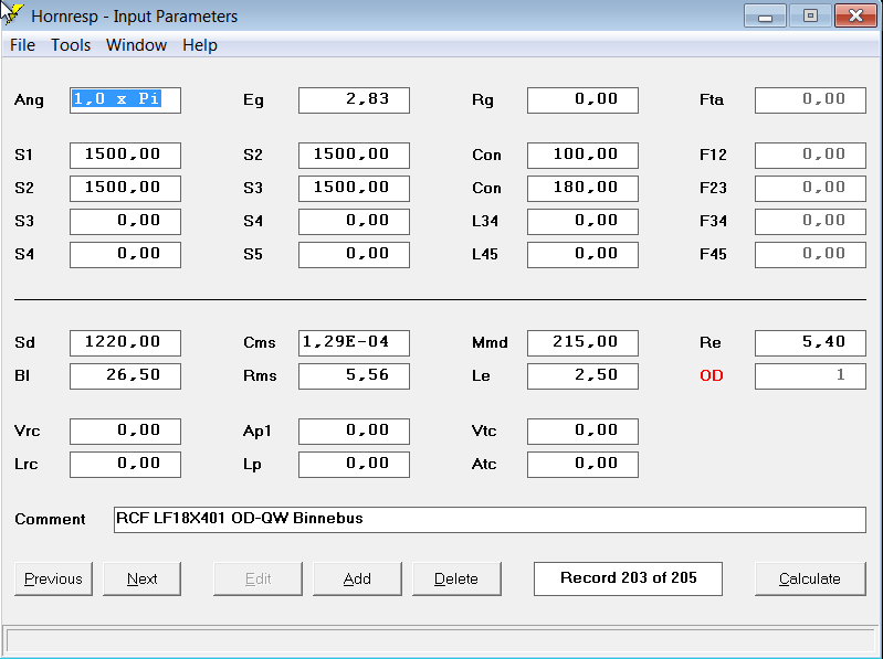

We are currently building a nice little OD-QWP for a RCF LF18X401.
A great home-theater subb for my 15 year old son. :D
We are going to build a ROAR18 for this driver later on, but it is totally unusable in a home environment.

Update on the Twisted TSX1000 12" D4s
After being measured by Barnaby Lange via DATS we were all disappointed to find out that the T/S parameters were not remotely matching the published parameters from Twisted's website, but after some work in Honresp we can see that these measured parameters are still useful... This sim is in Halfspace (open field) and this same box could be made smaller at around 450 liters for usage in a vehicle (add +18db roughly, depending on vehicle) ... Not bad at all really , just a big box ... These can also easily be made to work in smaller cabinets of other designs (with less output) .. .
