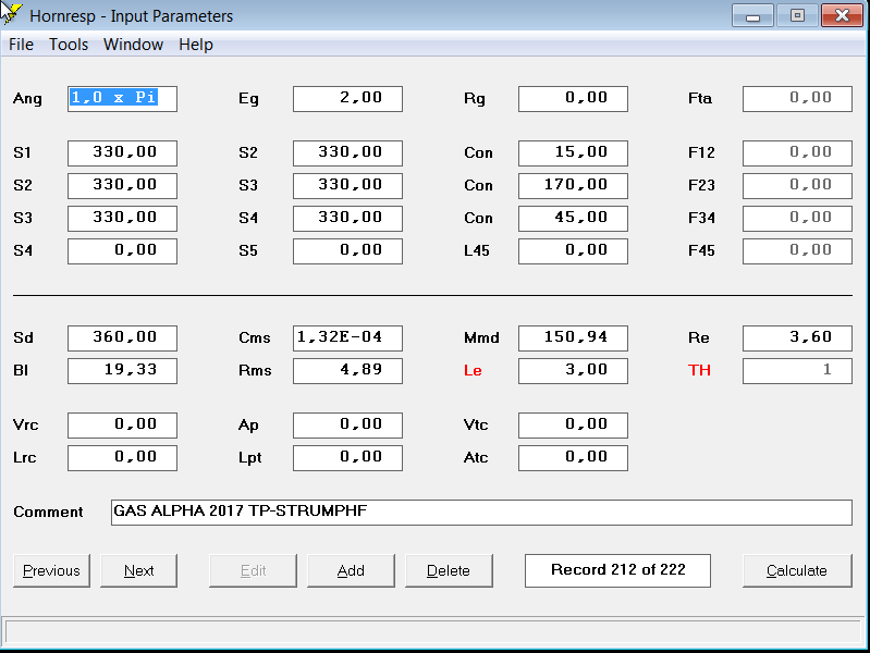

I built this simple tapped pipe design as a very cheap home theater sub for a friend, but the Fane 10 inch driver did not last very long.
GAS ALPHA 10D2 | GAS | Billjud | Brl.se
I needed a strong heavy duty driver with a quite low Qts and a strong cone that could take the quite large warping pressures inside the tapped pipe without complaining. The GAS Alpha 10 has a published Qts of 0,30 and I am inclined to believe the published Qts even though it is a cheap car audio driver.
The green line is measured outdoors at 1 meter and the red line is at 3 meters. Both lines are 4 sweeps each to leave out background noice.
This is my best guesstimate working back and forth between the published specs, the measured performance in the tapped pipe and my previous experience of different drivers in this tapped pipe.
It is not very precise. I believe it has a little less Bl then this. I am using lossy Le in this sim.

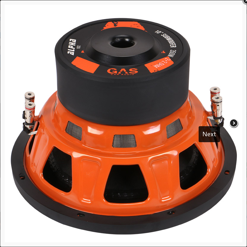

A picture I stole from their homepage.
It is a quite robust driver. We pushed one channel of my QSC RMX 1450 (500 watts) to constant clipping for 30 minutes and the bass was tremendous even though we were outdoors. We could not provoke any audible distortion from the driver despite very bass heavy EDM and no high pass filter.

did the GAS fit into this slim box? It seems to be substatially deeper than the Fane
There was one single mm of clearance behind the magnet in the tapped pipe. This is not optimal, since it blocks of the air flow through the pole piece. I did not want to build a new box. I knew it was a tight fit, but I hope it will survive. It is a home theater sub, so it should never have to endure prolonged periods of intense use. It is usually most explosions and collapsing buildings and stuff. The Gas Alpha 10D2 seems like a very rugged driver.
The baffle is 36 mm thick - two layers of 18 mm plywood. This is a way to get a very robust and stiff mounting of the driver, and a way to get more clearance behind the driver.
If I have to build another box, it will be tuned a few Hz deeper and I will increase the distance behind the driver to ease the airflow and cooling of the driver.
