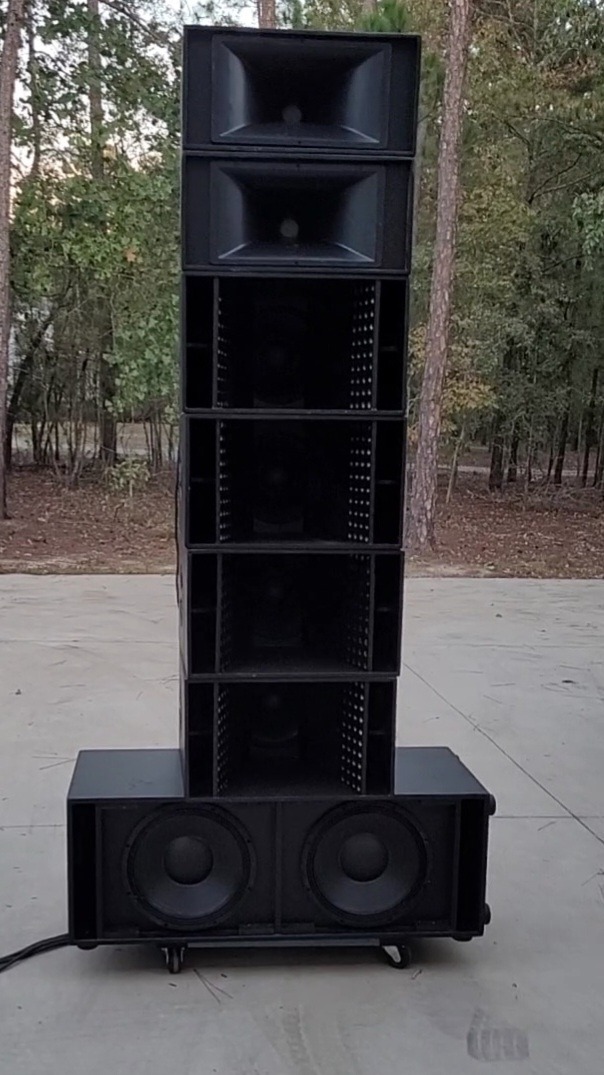

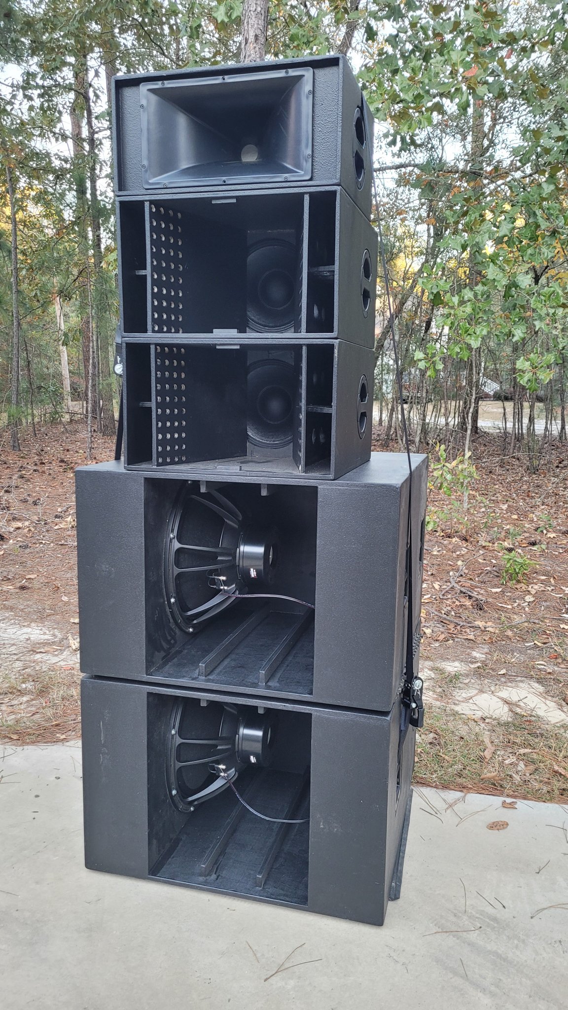

Handful of pics/vids from over the weekend with the two completed Type C cabs.

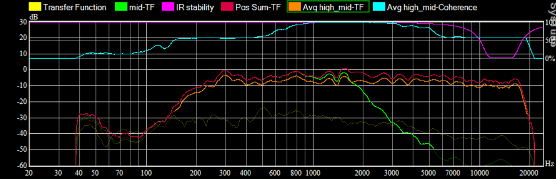

The sound is fantastic. I went hog wild with the measurement mic on top of a hill in Morro Bay last weekend. Frequency response is exactly what was advertised and it was really easy to EQ and integrate with the rest of the system. There was a big cancellation happening between the paraflex and the kick and once I added the right delay settings every kick drum felt like being jabbed in the sternum with a boxing glove when standing close to a stack. Excursion was under control all night even with huge bass drops that went very low. They are also surprisingly directional so when we pointed them towards a hill we were on instead of the valley below us it made a substantial difference.
Ziggurat,
So glad to hear that you are enjoying these Type "C" Classic Paraflex subs! :happy2: Thank You so much for the photos/video and the review/report :up::up::cheers:

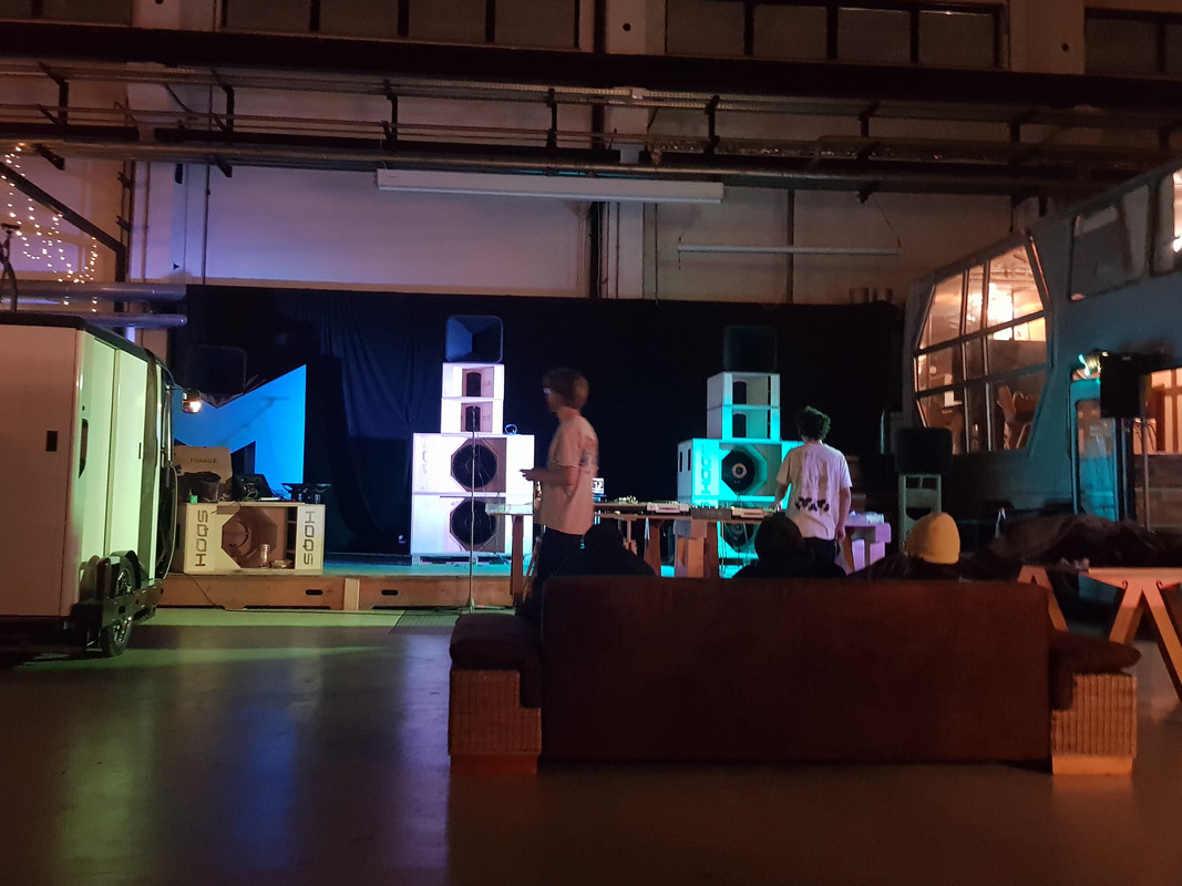

Gentlemen, there is an upcoming gathering in a few days on November 12th ... The location is a place called MotionLabs in Berlin ..... Many HOQS Paraflex cabinets will be featured there including various of our subwoofers & kicktops ..
Sign up to attend if interested, here is the link:
https://www.facebook.com/events/424940612643183/

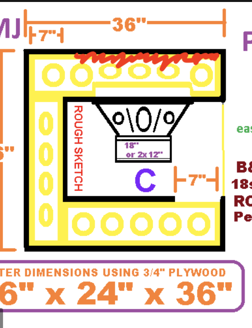

If the cabinet's upper response sounds a bit too resonant then you always have the option to stick a 2" thick square piece of open-cell acoustic foam on the panel at the back (closed-end) of the High-Tuned resonator section, and that will tighten things up for you 🙂

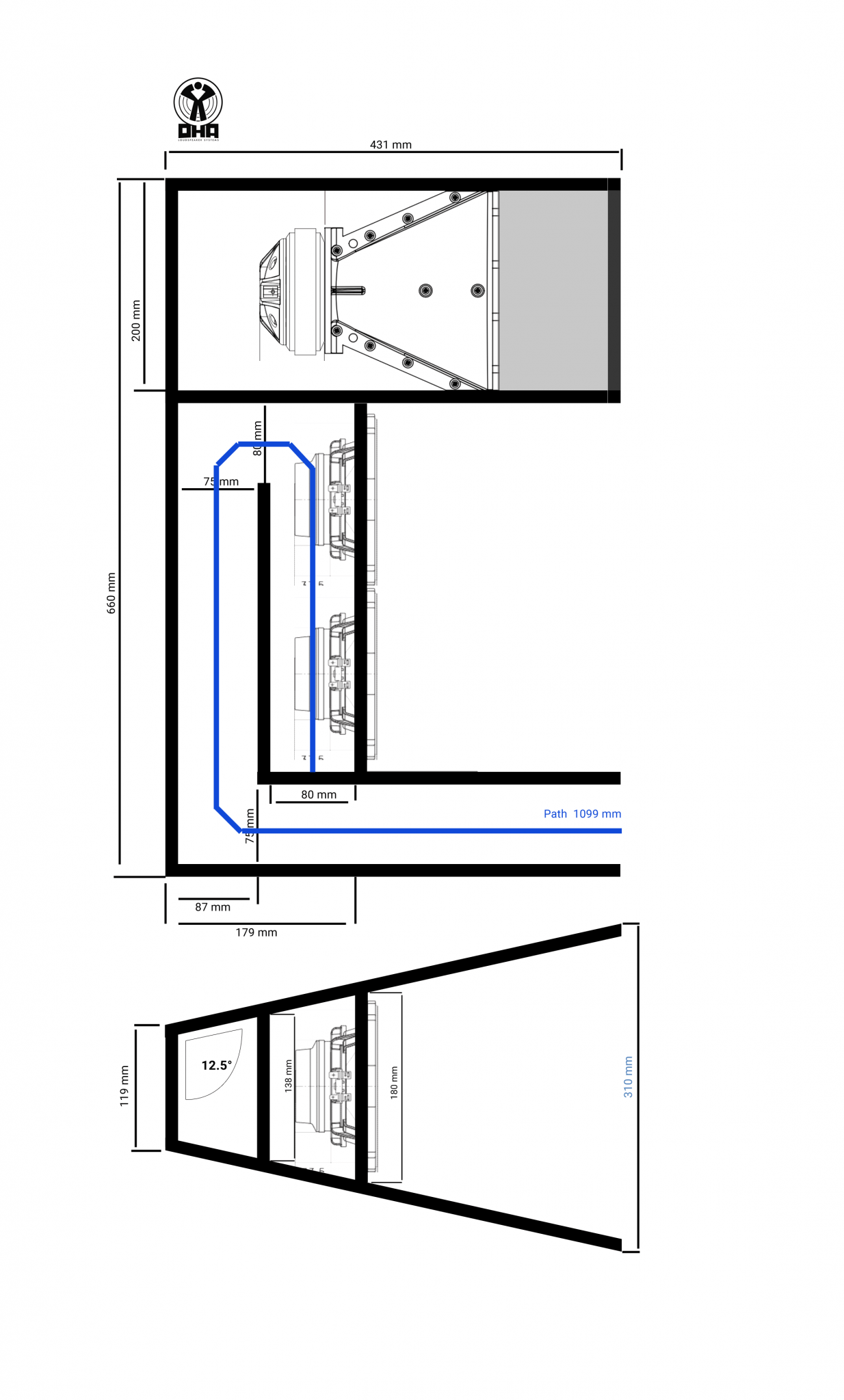

Matthew, I wanted to follow up on this suggestion of yours!
I haven't been able to build recently and have had limited time to throw parties because I'm a new dad--but we did notice that the cabs have a resonance somewhere and if I can fix it with acoustic foam than that's obvious low-hanging optimization fruit for the rig.
Where precisely would I want to glue (staple??) the foam? On the inner wall directly in the path of the driver? Here's an uggo ms paint illustration of what I'm thinking (foam would be in red); let me know if I'm on the right track (and if you can link to a foam product to buy, that would be clutch too):

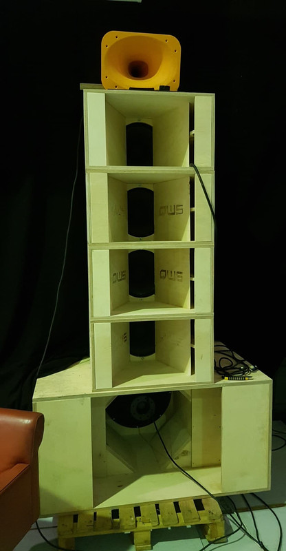

Considering a Paraflex 1x12 midtop build but I want to eliminate the horn driver at the front of it. Is there a problem with that? I guess I could build them with the waveguide installed but leave out the actual horn drivers, giving me the option to put the horn drivers in later
I have 4 = 1x12s loaded with B&C 12FW76 using a separate cabinets for HF using PRV WG45-50 horn and PRV D3220Ti driver.
I have a passive crossover that crosses at 1800 and it sounds great - I only use this for simple setups.
For more complex setups I bypass the internal crossover and bi amp through PA2 crossing at 1000hz. It sounds much better - but only audio/sound junkies will notice.
Unfortunately I have no experience with the B&C 12MH32.
