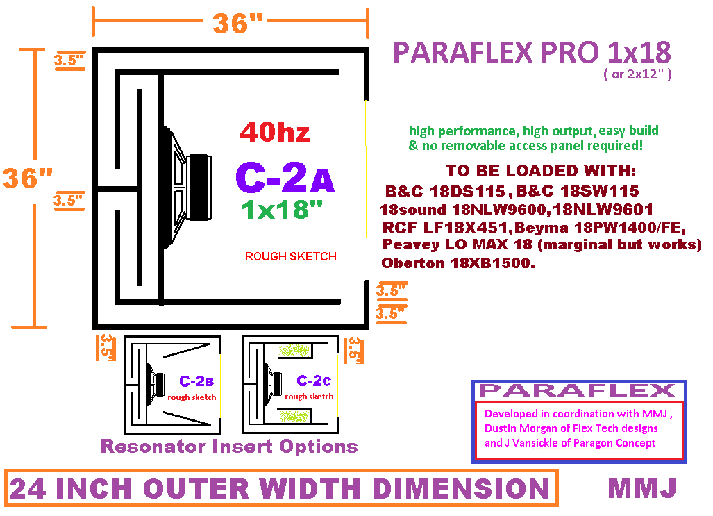

So this is the 18" C2A (or perhaps more accurately the TC2A-118)?
I'm still trying to figure out the workings of this sub, as I understand it it is built around two main QW resonators (or three due to the split path) one short with large cross section area exited by the rear of the driver, and the two on either side and they all sum at the aperture, is this correct?
Paraflex Type C-2 series, C-2D and C2E are all split-path symmetrical layouts ..
Martinsson,
Correct it is a Paraflex Type C-2A (abbreviated Paraflex TC2A) ...
Yes, it's operating principle is Compound Loading using quarter wave resonances ....The Compound QW Loading with the ends of the resonators merging very near a shared mouth is a common feature of all the Paraflex designs .... However with some of these Paraflex designs such as the "C" series we have given the High-Tuned resonator and the mouth a large Cross Sectional area, and since the long (low tuned) path utilizes the rest of the cabinet as a large expansion & shared volume with shared mouth it means that we could call this a sort of Compound Horn design .....
As you correctly pointed out the high-tuned resonator is short and fat (where the rear of the cone, basket and driver's motor are located), and is excited by the rear of the driver's cone but as mentioned above this section is also utilized as a shared volume by the low-tuned QW resonators, adding to their performance ........ In these Paraflex designs the high-tuned resonator can be a cavity resonator or a QW resonator or any transitional degree between the two (easily optimized in Hornresp, and easy to see how the geometry changes the results) ..........
These split-path symmetrical models of course have the lower tuned resonator path split into two identical paths, each with half of the Cross Sectional Area that we would normally give the single path ...... This split-path symmetrical approach is used in the Paraflex Type C-2A (sub), C-2D (kickbins) and C-2E (sub) .. . 🙂

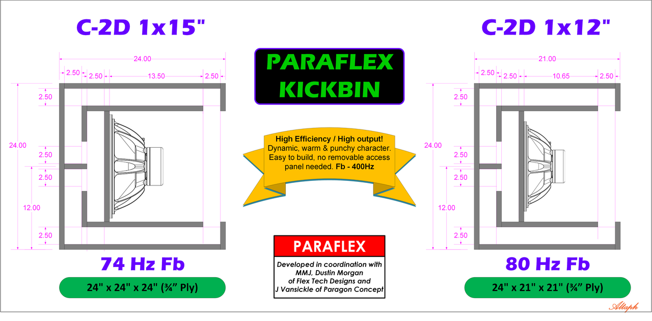

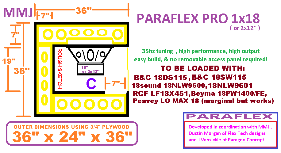

Some of the simple plans (below) which our 3D artists will create their professional drawings from :
The last two drawings were provided by our talented friend Altaph Mohammed in Trinidad ..

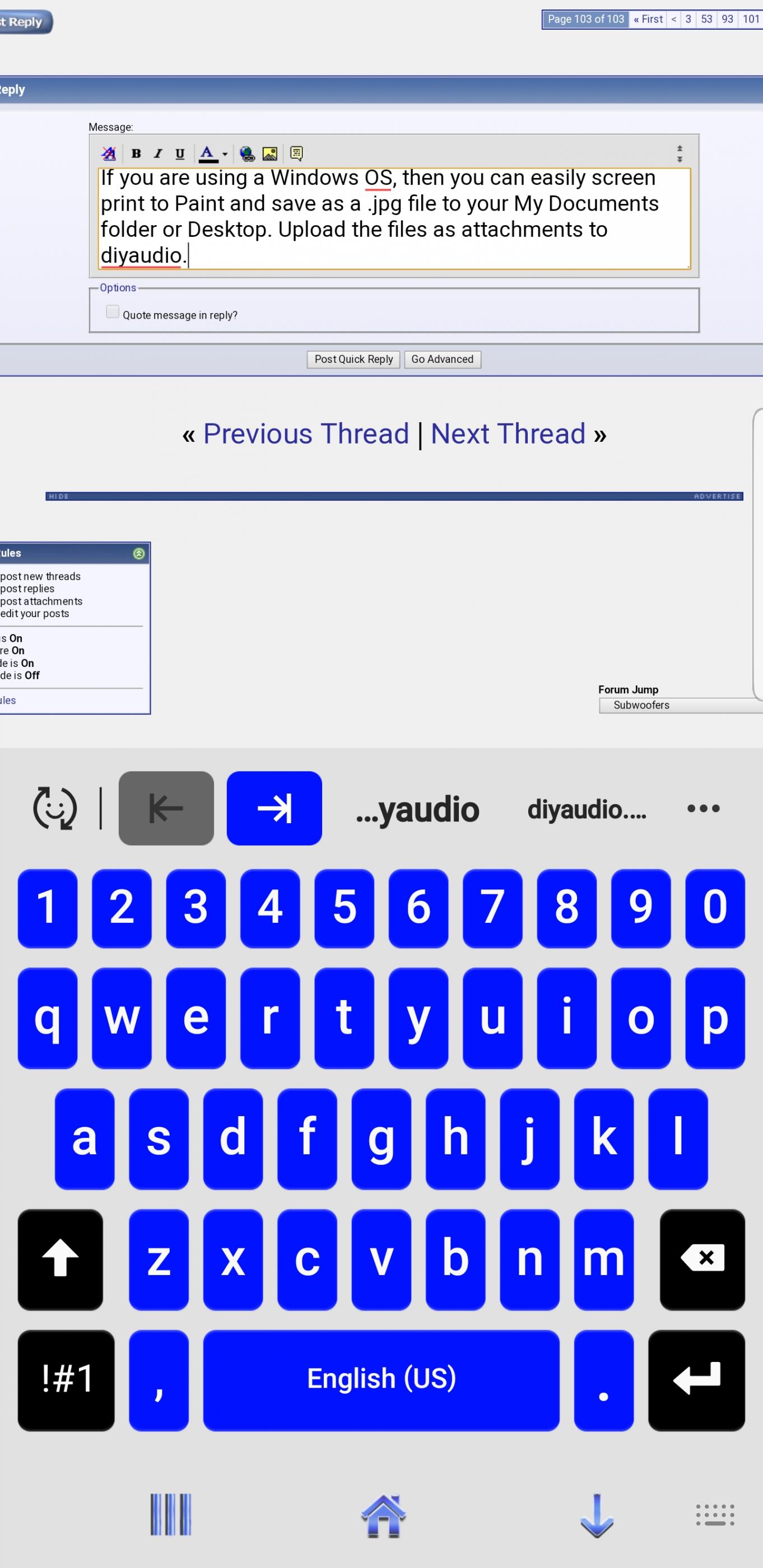

If you are using a Windows OS, then you can easily screen print to Paint and save as a .jpg file to your My Documents folder or Desktop. Upload the files as attachments to diyaudio. I just attached a screen shot of my phone. It's that easy. I don't see why anyone needs a 3rd party to post pics.

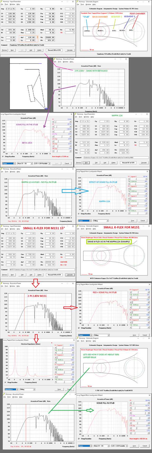

hey MMJ - here's what I've tried to send a couple of times. I'll probably miss out on getting a K built for now as picked a horn toy instead.
Hi Matthew - I tried to reply a few days ago but your inbox was full.
Maybe a small K-flex which could share either Kappa 12a - or my JBL M151. Do you think a traditional K-aperture will work well? It does on the little Acoustic 115BK which has about 1 cubic foot front chamber. I've not heard from my builder and since wasn't sure on the K-flex, told him to build a simple folded horn for the mean time. How is port area adjusted on your kluge model? What segments comprise the front chamber?

ps here's those sims with M151 stuffed in the little K-flex
https://i.imgur.com/9mzt4Qi.png

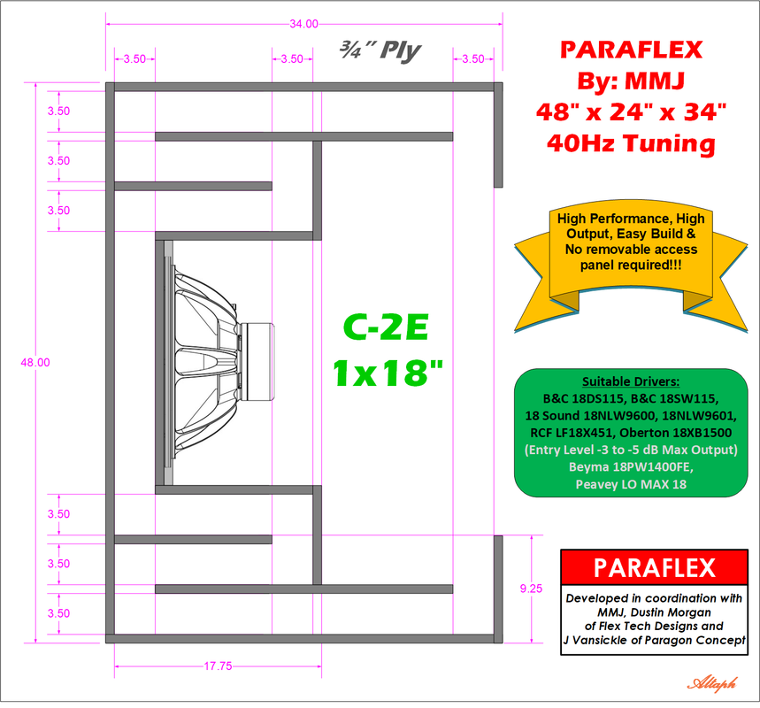

As far as scaling the Paraflex Type C-2A subwoofer (for a 15" driver) it can be done the way you described or it can be as simple as sticking with the C-2A 1x18" layout and reducing the 24" dimension down to 17 inches or 18 inches (outer), which works
UsrfObiwan has scaled and built the C-2E for a 15" driver ... Also turned out to be an excellent cabinet ... He loaded it with a heavy duty 15" driver from Oberton and he liked the results so much that he is planning to build several more to be used as a group at events in the Netherlands..
Another fellow named Bradley Katz built a pair of Paraflex Type C-2E 1x15" and loaded them with some of the higher end Faital Pro 15s and they are performing well for him (also being used to reproduce dance music at events with live DJs ) ... He is very happy with them.. . He also shared some videos of them in action (i think i can link them over to here) .. .
The original C-2A Paraflex plans were intended for a single 18" driver but can easily be adapted to four 10" drivers, four 12" drivers, two 12" drivers or even a single 12" driver but at that point becomes a Paraflex Type "F" . ...
BP1Fan, the convenience of hosting the photos on DIYaudio is attractive for sure but there are some benefits to 3rd party hosting such as being able to share these posts (including photos) with folks who don't have DIYaudio accounts (I still want them to see the images) ..... 3rd party hosting also allows the images to show up in search engines which i prefer in most cases, and for those photos that i don't want to appear in search engine results i always have the option to host them on DIYaudio .... It is good to have options 😀

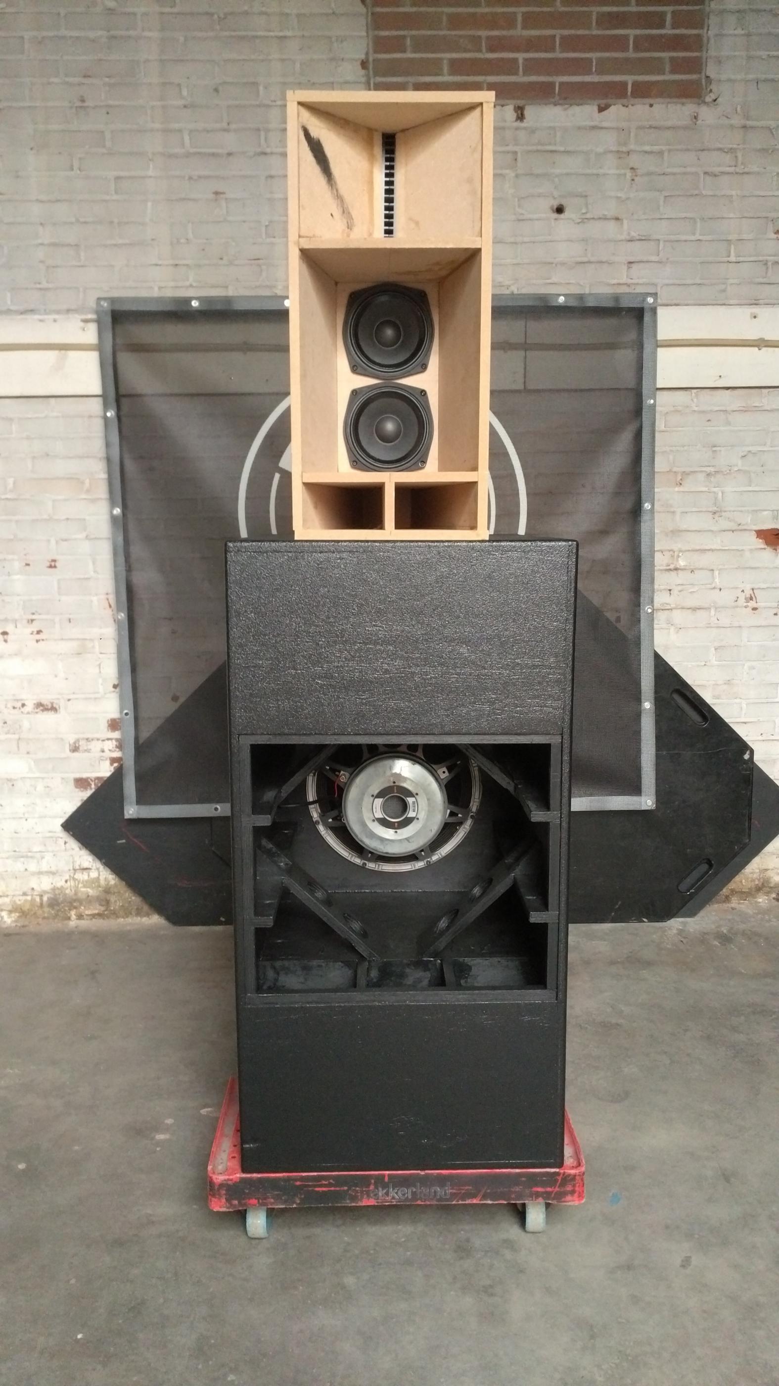

The Pro Audio lineup.. Super Planar and Paraflex cabinets.
Here (below) is our current DIY PA lineup including the Super Planar and Paraflex series cabinets ... Rendered in gorgeous 3D by our talented artist friend in Australia, his name is Ty Cention (of Kaironex).... His rates are reasonable, and he is available to create 3D of other designs, so if you need that service just contact him on Facebook (or on here if he gets an account on DIYaudio ... He might sign up once he sees that i am posting his work in these forums 😀 )...

those 2x8 and 4x8 "kick top" cabinets look like they could be pretty nice for home systems. A 2X10 should be good and decent height to hold MF/HF horn. Is Delta 10a suitable for a 2x10 kick top? What do sims of the eight inch cabinets look like ? Do they play low enough to hit a drumkit's mounted toms?
Yes , A pair of Delta 10a drivers should be great in such a cabinet (scaled up) .

hey Matthew - that looks like a good and capable home system - which 6" are those? - - is there a compression driver on a (commercial array) waveguide driving the upper horn's throat? If one has membership with Facebook, can info be found in the "files" section at the illustrious High Order Quarter Wave Society?
with regards to the Karlflex with K-aperture and stub - I think its worth a shot as long as the speaker is rather "bright" in the first place so there can be tonal balance and not sound like either in a cave or under-water

Hi Freddi
I believe 18sound 6pr112 and b&c de250 was used on the 2x6
Yes indeed most plans myseld and others are up there. Sketchup files and cutsheet photos in the comments.
Plans for the 4x8 and 2x8 paraflex are not public currently. The 4x8 will need phase plug testing to find something optimal.
The 2x8 will be able to use the same semi circle that was found optimal on the 2x12.
