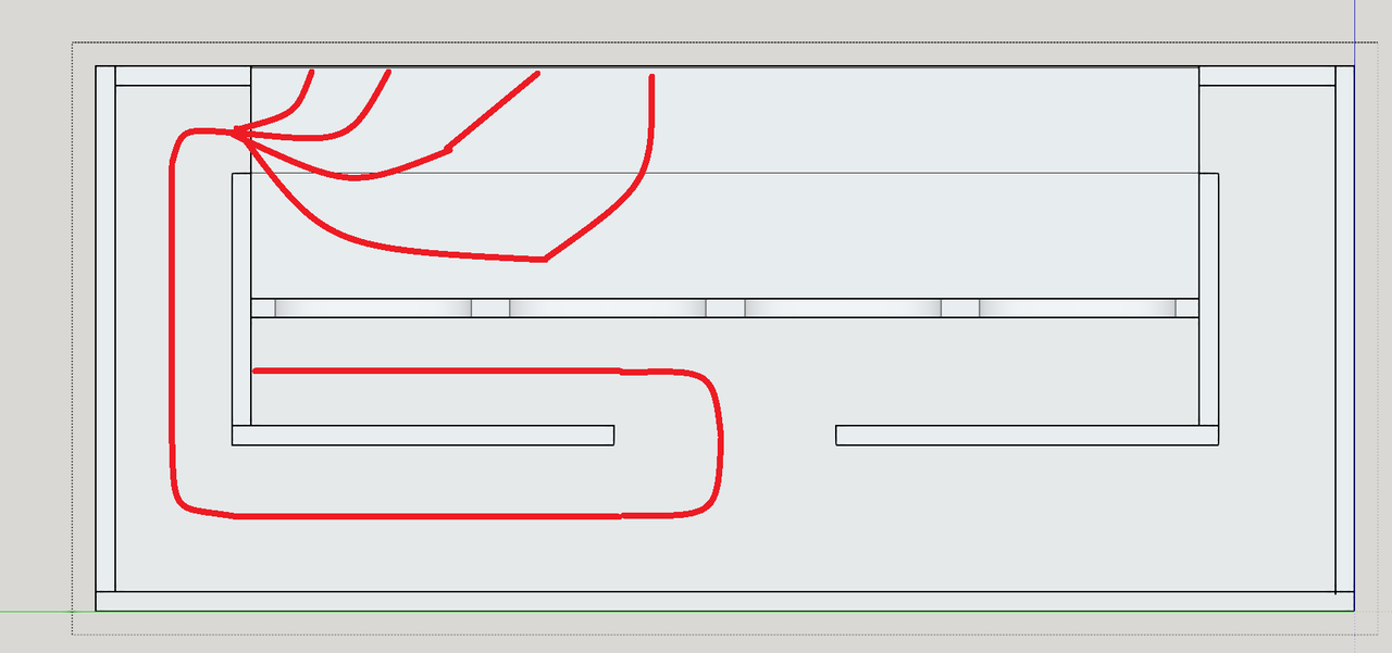

Here is a layout sketch (below) showing the main path (in red) on one side, and of course there is an identical path on the other side of the cabinet (the 4x8" is a split-path symmetrical design),and in addition to that there is the short high-tuned horn path directly in front of the drivers .... They all merge and share the same large mouth and to some extent the main path also couples to and shares some volume with the high-tuned short horn flare ....

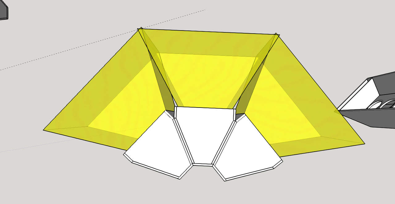

From a top down view we can see the trapezoidal shape of the cabinet and estimated pattern when multiples are arranged in a splayed array . .
There are a few different merge styles that we plan to try in our initial testing ... The C-series style is shown here (below), but there is also the "Option-X" style that we could try which will raise the fundamental tuning to some extent (desirable in some situations).... We also have the option of very easily converting the cabinet to a Super Planar ...

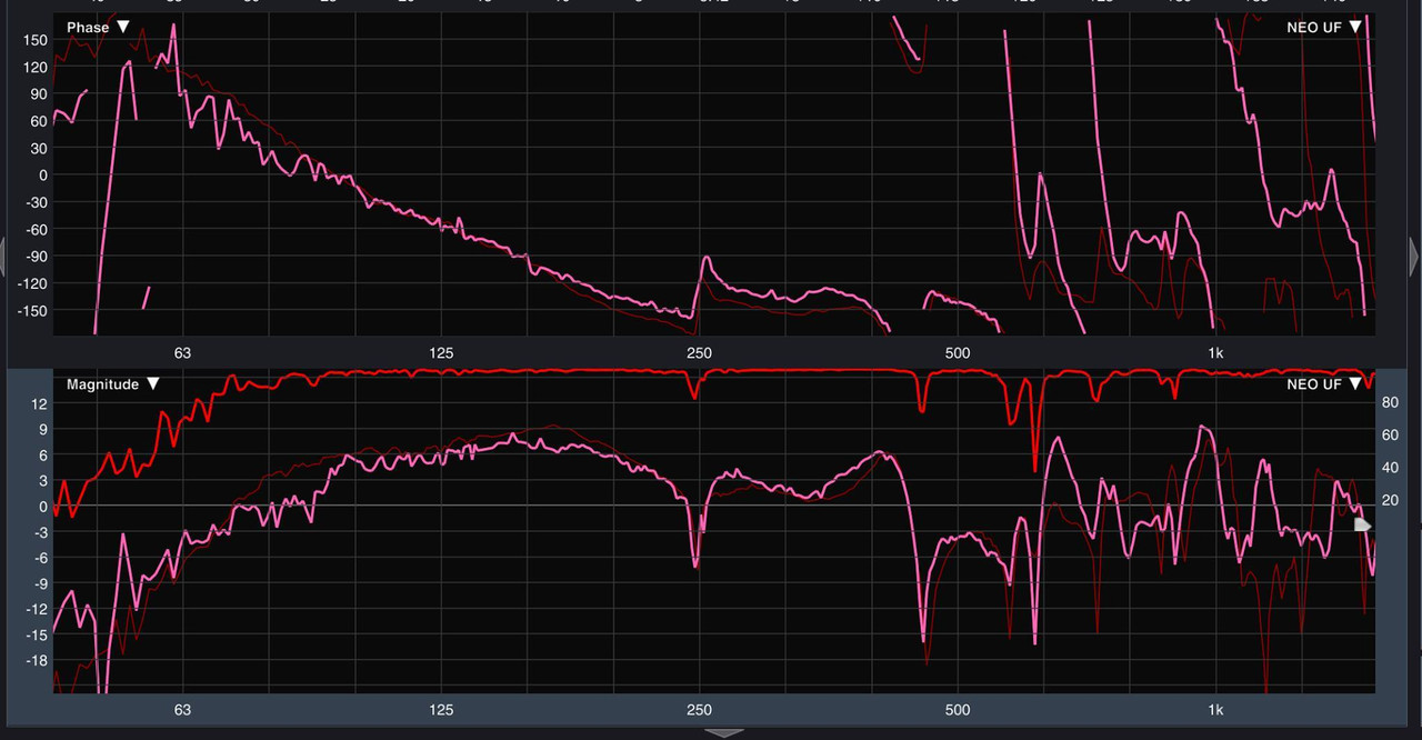

C-2D 1x15" kickbin measurement
Our friend Mark Tomlin in the UK measured his C-2D 1x15" kickbin outdoors recently, the curve is shown below.... ..Plans for this cabinet are included in post #1022....
Mark really likes these C-2D kick cabinets....He made a few recordings of them available to us, and they do sound nice...Very bold sounding kickdrum reproduction with a lot of dynamics and impact......
These are loaded with the Beyma G450N (dark red curve, look closely
).... The Beyma 15P80nd (pink) was also tested out in this cabinet .. .. .... Both drivers models sounded good but they preferred the G450N ..
Mark says the dip at 250hz is not audible, and he only plans to use them up to 200hz anyhow but for the sake of science he will try a little damping/lining at S1 & also in the high-tuned resonator (large short resonator where the motor is located) just to see if the dip is alleviated to any extent ....
Phase response looks well behaved and other than the hiccup at 250hz this cabinet looks solid and useful out to around 430hz.

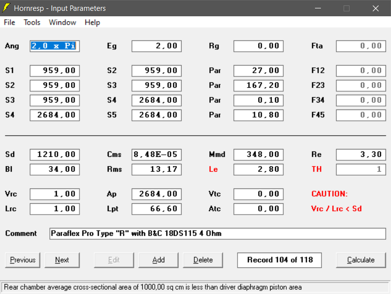

Comparing to the prediction Hornresp makes for this C-2D ... Not bad ..
Hornresp did a good job of predicting the C-2D Paraflex kickbin 1x15" response ... The average measured output from 260hz to 430hz isn't quite as far down (relative to the rest) as the simulation suggested it would be but other than that i am seeing some good correlation here within the intended operating range of this cabinet....
Hey MMJ - would you provide a hornresp record or screenshot of input for this little 1-12 kickbin? With bracing

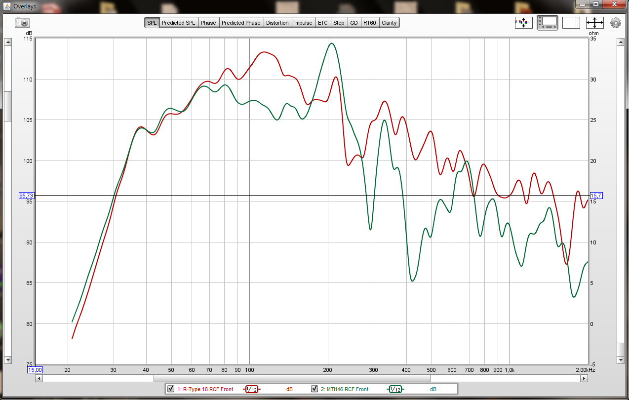

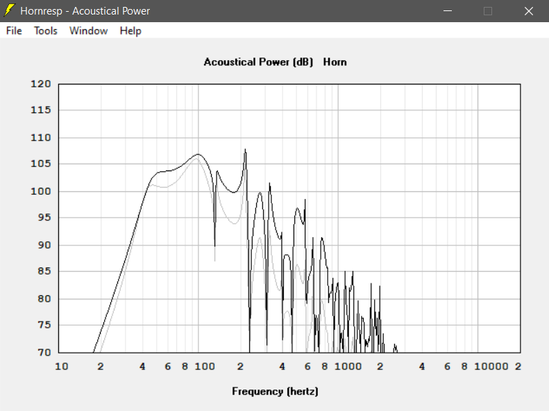

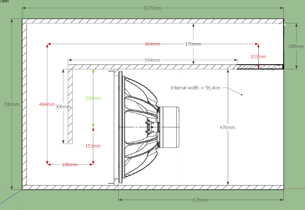

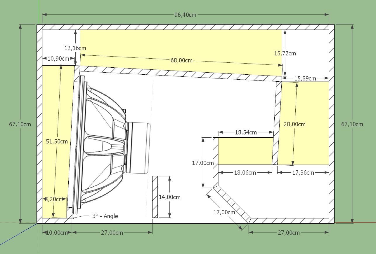

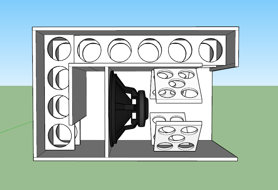

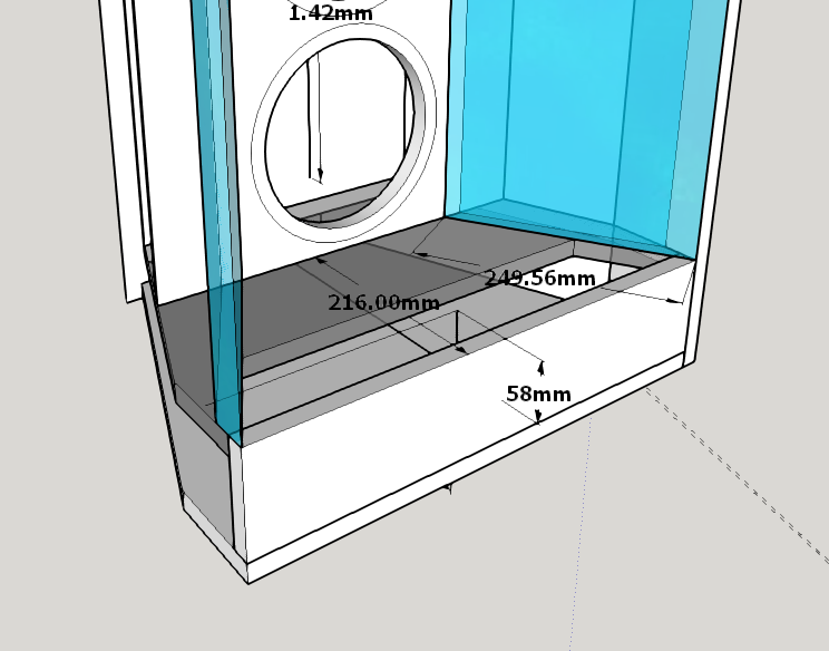

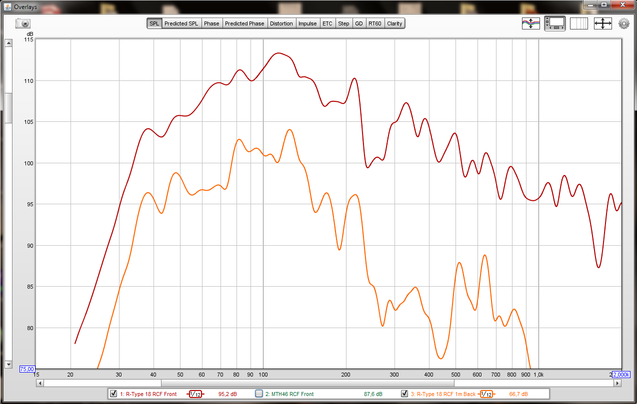

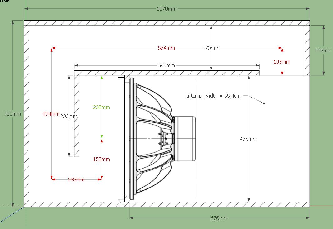

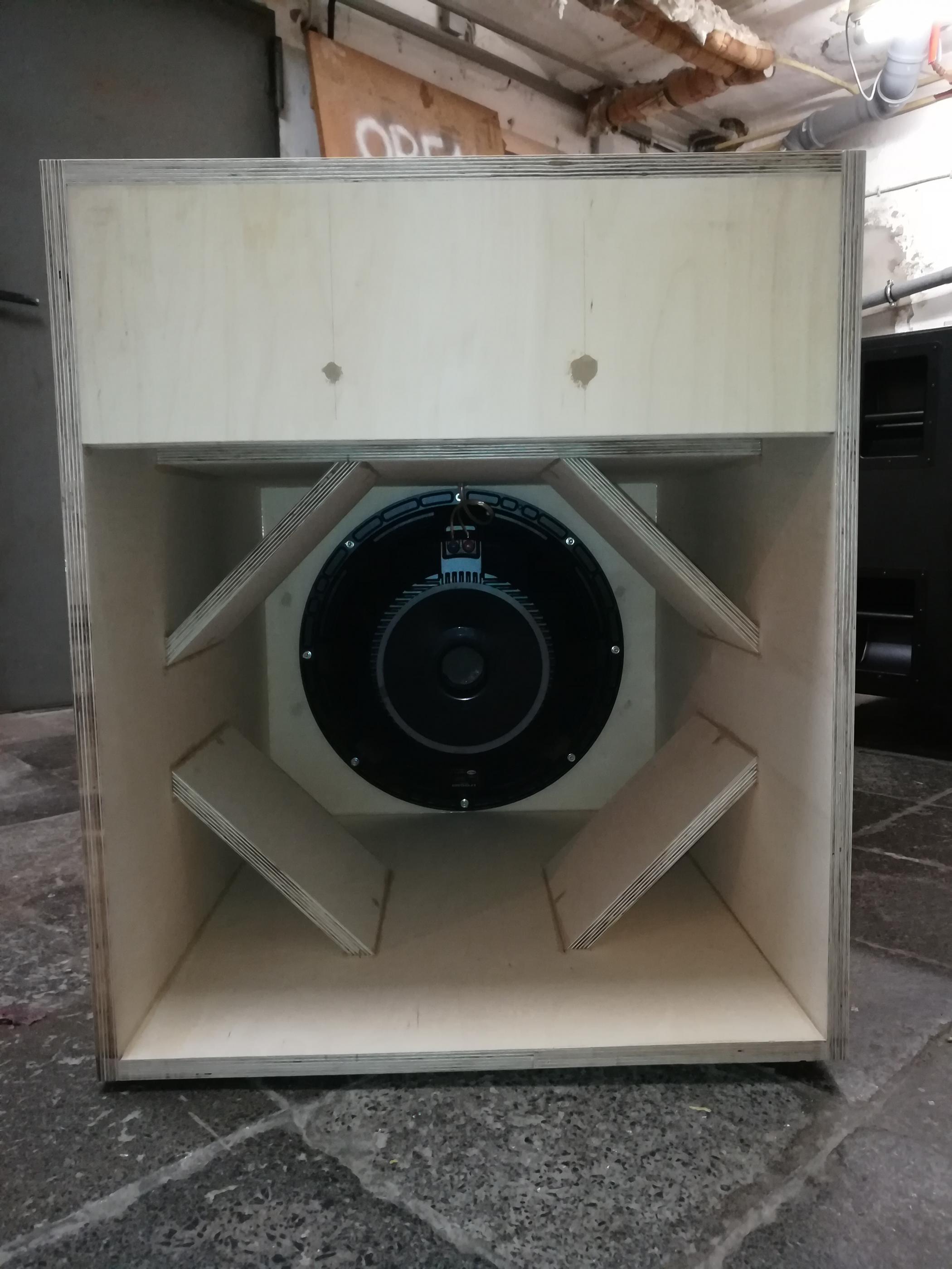

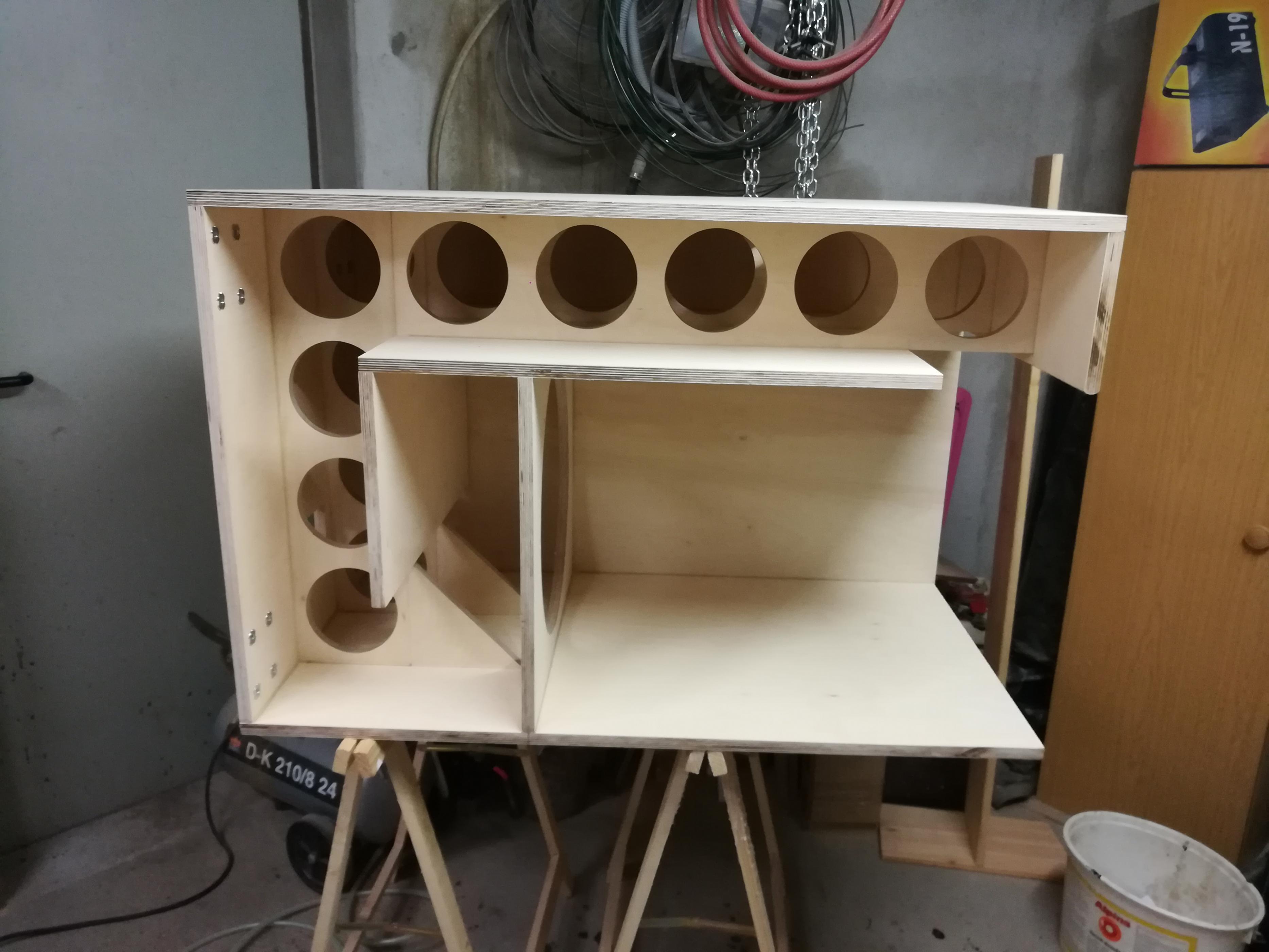

Paraflex R-Type
Hey everybody! 🙂

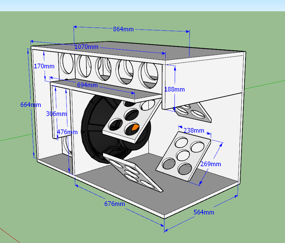

The last few weeks Matthew and i worked out a Paraflex R-Type Subwoofer Cabinet. Driver is going to be the B&C 18DS115-4, but the actual measurements were taken with the RCF LF18G401-8.
From what i heard and tested so far (just measurements with the sub, playing some tracks just with the sub) i can say, that this is the most powerful subwoofer i've ever built!! 😎
Have a look at the graphs and curves.
Sounds very strong, clear, punchy and also kicky!
The best thing of all is the overall directivity =) i measured 1m at the front and 1m at the back and we have up to 15dB cancelation at the rear of the subwoofer (orange graph)! A passive cardiod-subwoofer so to speak.
If you have question, tell me!
Next days the DS-115-4 will be delivered and i will repeat the testing with that driver.
Note for the measurements: They were done with a calibrated Umik-1. The other subwoofer (green graph) is a Big Tham (MTH46VS with additional panels - longered the horn path like in the plan attached).
Patrick
Hey Bryan! 🙂Yeah, i already discussed that with Mr Morgan, because your idea was one of my first ideas with that cabinet. If i remember correctly, the coupling with the high-tuned resonator will be missed then. And it would become some slightly different tone/character and response. Suggestion was to couple both resonators by that front-sheet.
I understand your intention - every bend costs bass-energy and dB at the end of the day. So that still has to be found out. 😉
