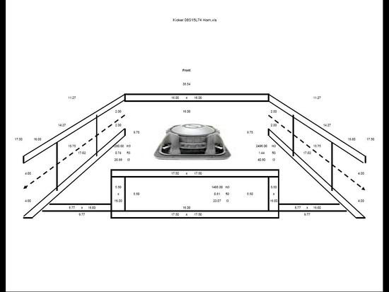

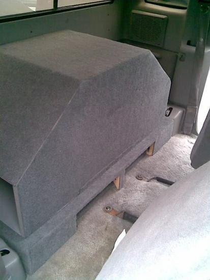

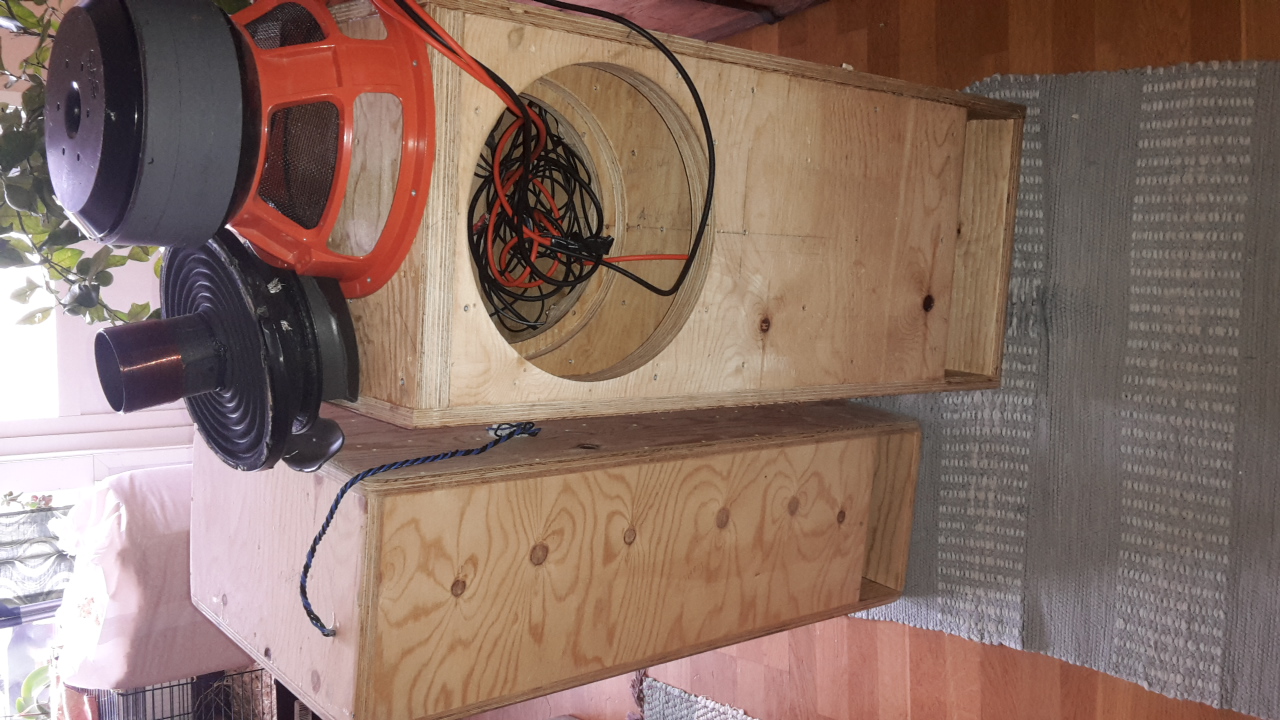

That GAS Comp driver must be tougher than an old boot!
Johannes,
Glad to hear that the driver survived as long as it did under such extreme conditions, it says a lot about the durability of that driver! ...... I am also glad that you are finding the Paraflex design to be useful 🙂 ..
I have some Paraflex build updates from other folks to post here ... People are reporting good things about them..
Paraflex meetup.
The driver did not like prolonged periods of heavy clipping from a 3500 watt amp with 18 dB bassboost.
The small Paraflex contains a 8 inch Alpine type R.
Johannes,
It sure isn't a Kicker! 😀
It's the user. My 08S15L74 has been in use since 2009. I've had it in a Ford Ranger SuperCab in a BPH. It's been playing in my mancave since 2012 in a T-TQWT.

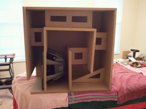

Angel G's Super Planar 1x15" top build
Freddi ,
I have a real world report from a friend named Angel Garbitos Romero in the Dominican Republic ... He builds cabinets professionally down there, and his company is called Garabomusic ..
He just built a prototype Super Planar top using one of his 15MB700 drivers from 18sound ..... He also owns HD15 kickbins and he is telling me that the Super Planar is leaving the HD15 behind in the dust in terms of performance in his listening tests, he is very impressed, however the Super Planar is considerably larger from what i understand so that is the "give and take" of it .. ..
He really likes the sound that this cabinet produces so he plans to build more of them out of higher quality material now ..
Angel's build/report post with videos in the comments section can be found here at this link on facebook.

Freddi ,
