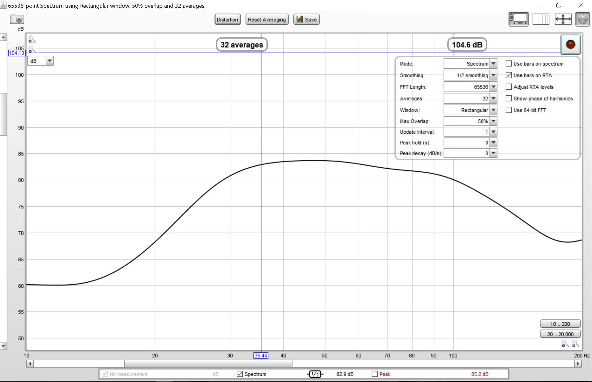

Simulation vs in car measurement. The microphone was close to the windshield at the passenger side. 0,3 volt from the amp output.

Distortion at 0,3 volts measured in car.

O.3 volts into the speaker? Seems a bit low. What does it look like at 2.83V and higher? I think it would be interesting to see how the linearity and "distortion profile" changes as input voltage is increased, but it might be best to test that out of the car. For my last few subwoofer builds, I upped the input until the in-band THD just exceeded 10%, then backed off the input in 3dB steps, measuring FR and THD along the way.
This was the loudest I could measure before my Umik clipped.

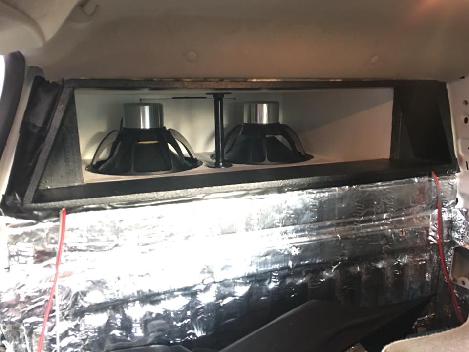

It is not my car, and we could not measure with the box outside the car.

Very efficient enclosure with only 0.3 volts!
Cabin gain is a wonderful thing too 🙂

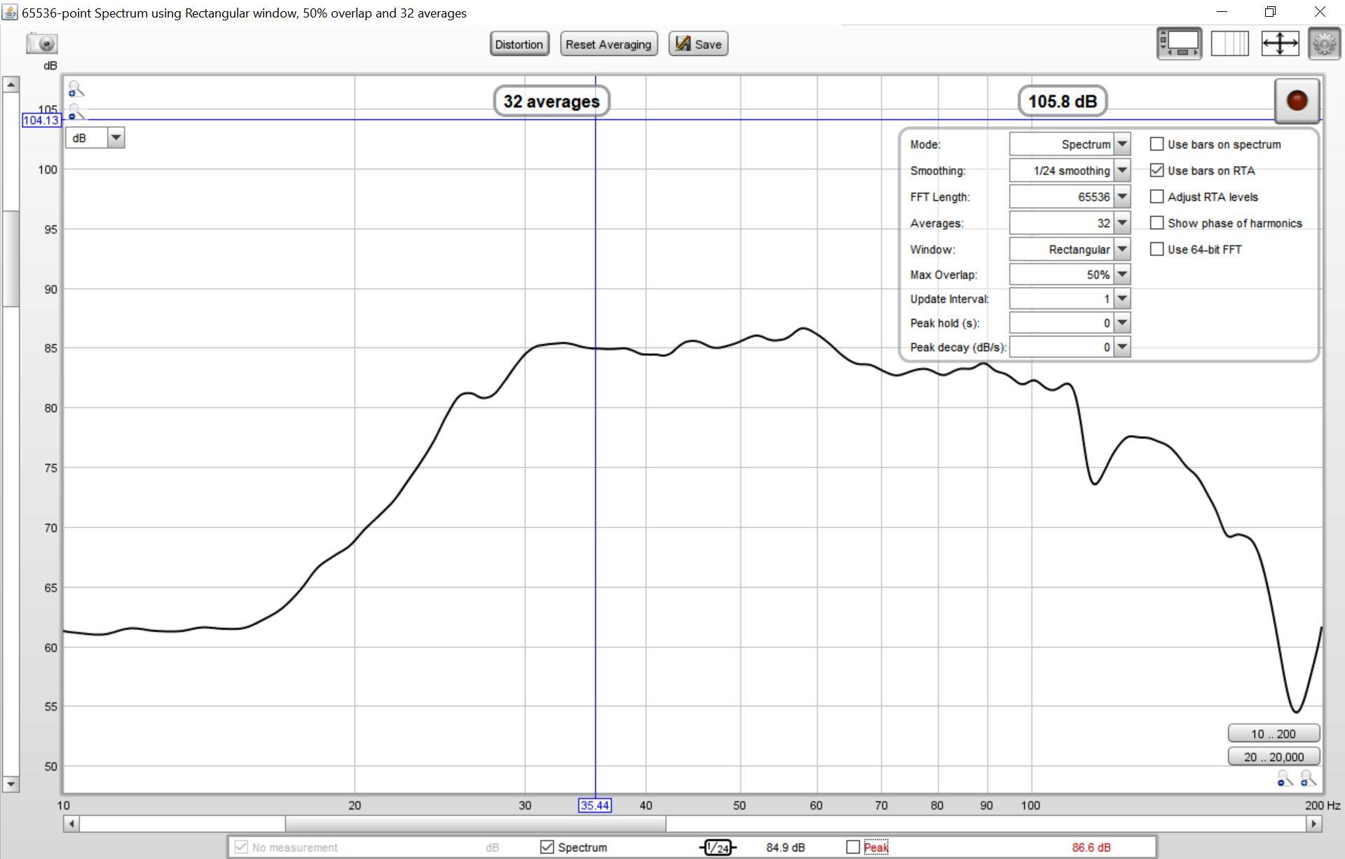

A better updated Hornresp model compared with the in car measurement.
I blame the 8 layer voice coil for the large Le.
