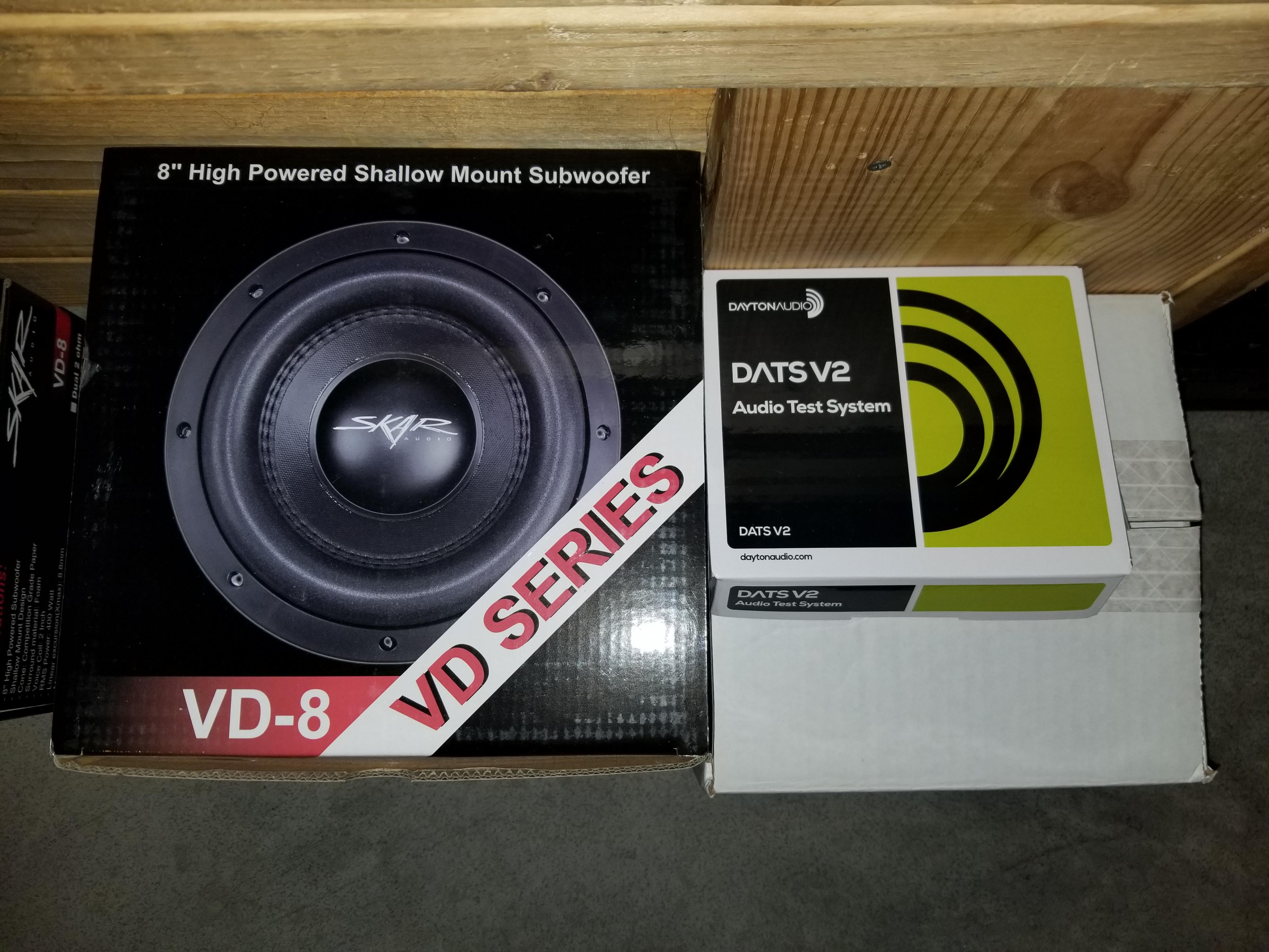

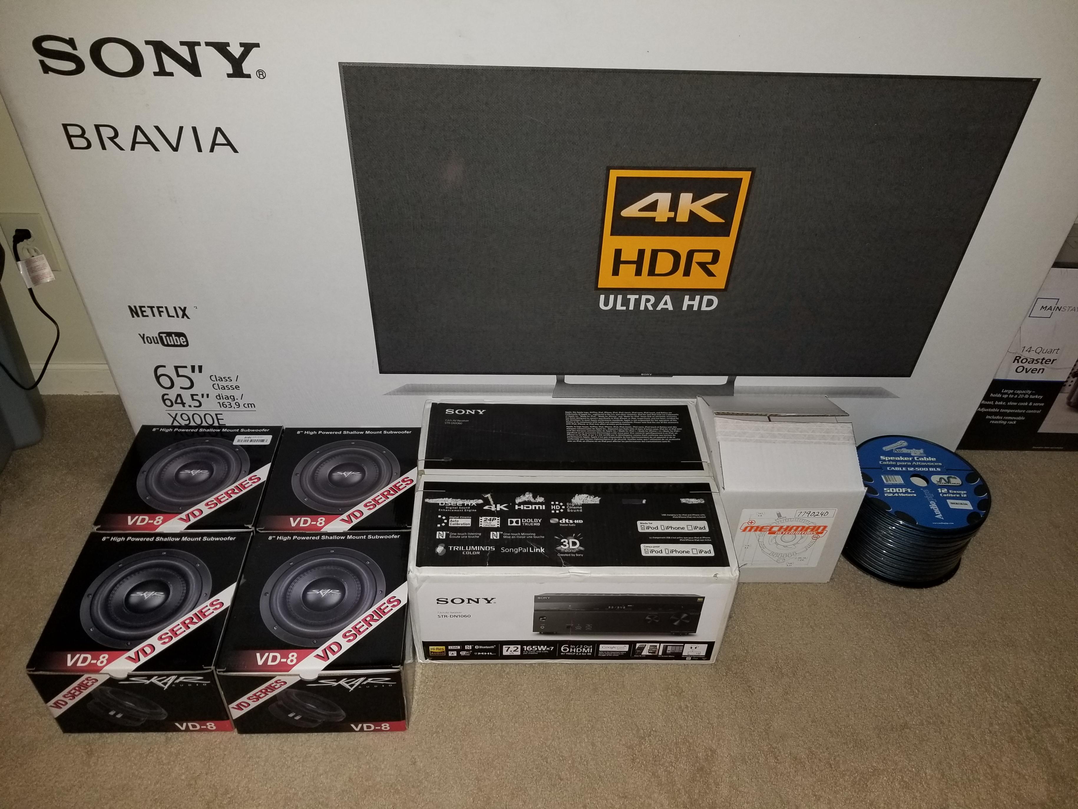

Look at what I got 4 xmas!

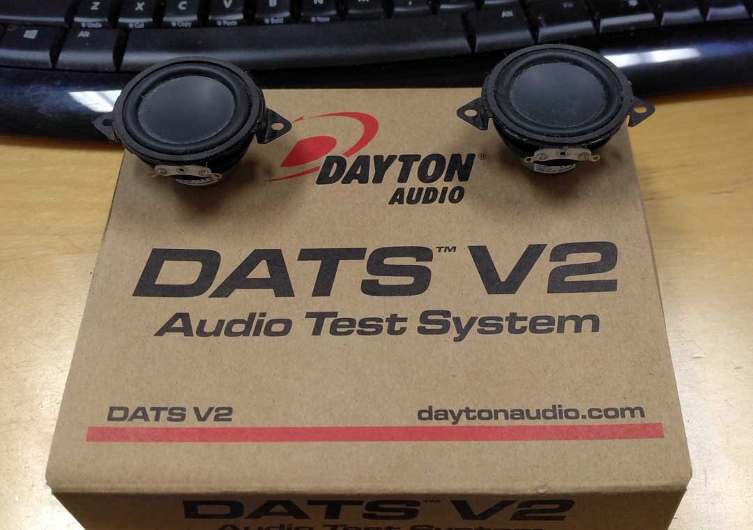

I got a DATS too.
I just don't have the room behind the seat for 1 of your enclosures. I'm either going BP4 or tapped pipe (TQWP).
I got a DATS too.
Santa gave you Skars for Xmas! Hehehehe
Even better yet he gave you Skars and VDs !!😱 Four different VDs even!!
Good to hear that you have a DATS BP1fan! They are so incredibly useful
When you measure those Skars be sure to let us know what the results are , it would be much appreciated 🙂
