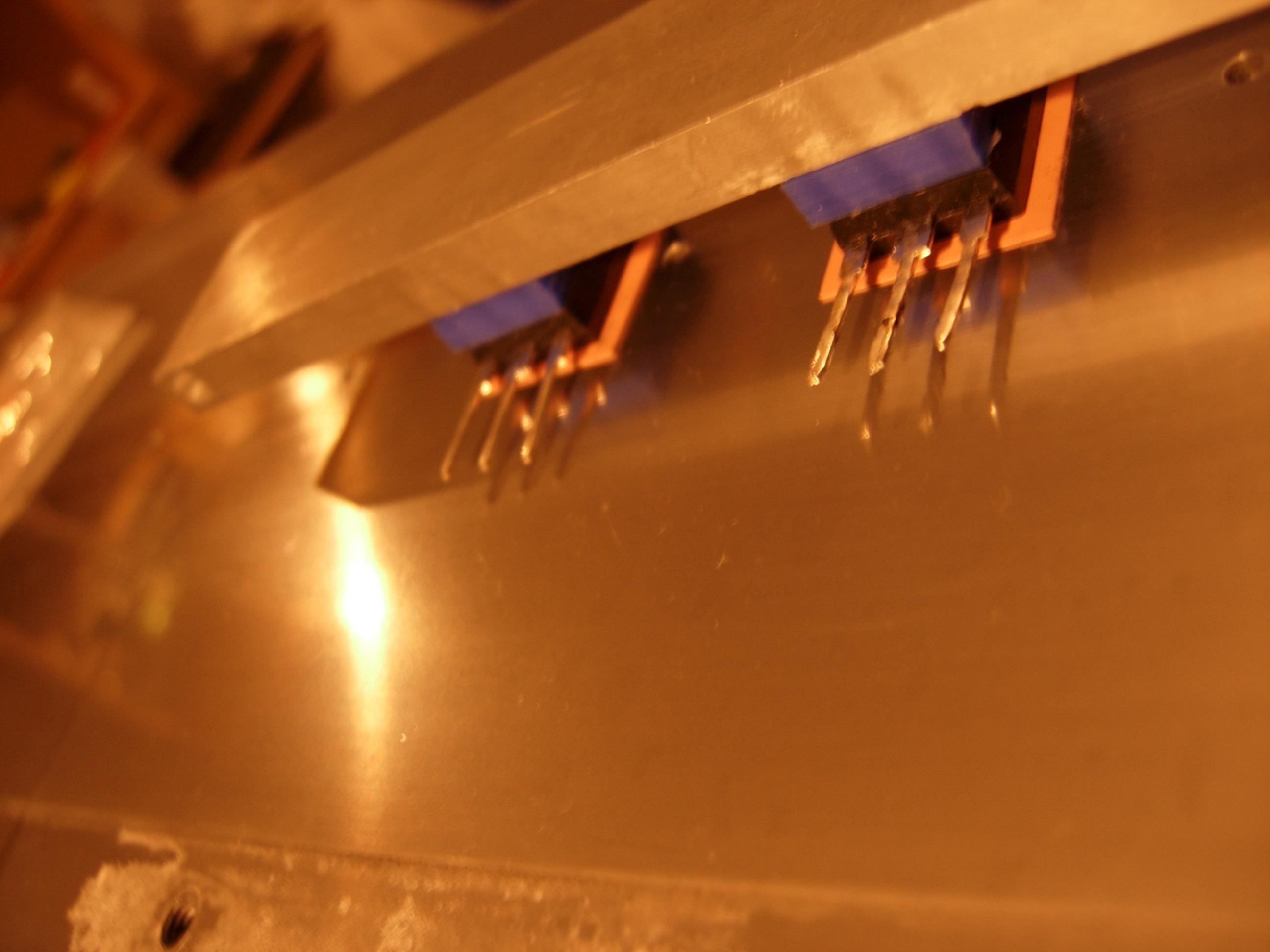

I have been thinking about the placement and contact of the fets ... I have opportunity to
use a bar over the top of the fets trapping them against the sink . I could also connect the pins by wire which would allow me to space the fets more evenly on the sink .
Would I compromise the signal by using wire ?
I have ordered aluminium flat bar , 20mm x 8mm for the back of the fets .
I would also have to re-think the internal layout now I have the output board .
I am thinking about some kind of shielding in the form of PTFE or a metal enclosure
around the AC input at the rear of the amp.

I don't like the idea of a bar at the back of the FETs. Right now you have a FET to heatsink interface that you polished to get good conduction of heat. If you add a bar, then you have a second interface that can resist transfer. Maybe this can be ok, but for what benefit? If the bar was from copper (or diamond!), then I could see how it might work.
For the bar on front, I've seen this in builds. I wonder would it be as effective to simply screw on a heatsink to the front of the FET? Maybe this would reduce the thermal coupling of the FETs. The bar does look good though.
For the wires, I'm curious myself....
A bar could insure improved contact of the fet to the heatsink, just be sure you don't crush the fets. There would not be any appreciable heat extraction from the bars themselves.
You will already need to use wire to run to the output boards if you use them. The only MUST is, if running wires to the individual fets, the gate stopper resistors should be soldered directly to the gate pins.
If the base on your heatsinks are 15mm thick, I would not be too concerned about spreading them out evenly. You can get close to 75mm spacing using the output boards.
the clamping bar works even better if the clamp system has some compliance to allow the device to expand and contract with changes in temperature and yet still maintain adequate clamping force.
If each device under a clamping bar could be "pushed" onto the heatsink with the equivalent of a very stiff spring, that introduces the compliance necessary to get the best out of the clamping bar arrangement.
That is why the spring clip type clamps work so well. They are springs "pushing" the device against the heatsink.
This allows better heat transfer than using the hole and bolt method designed into most power packages.

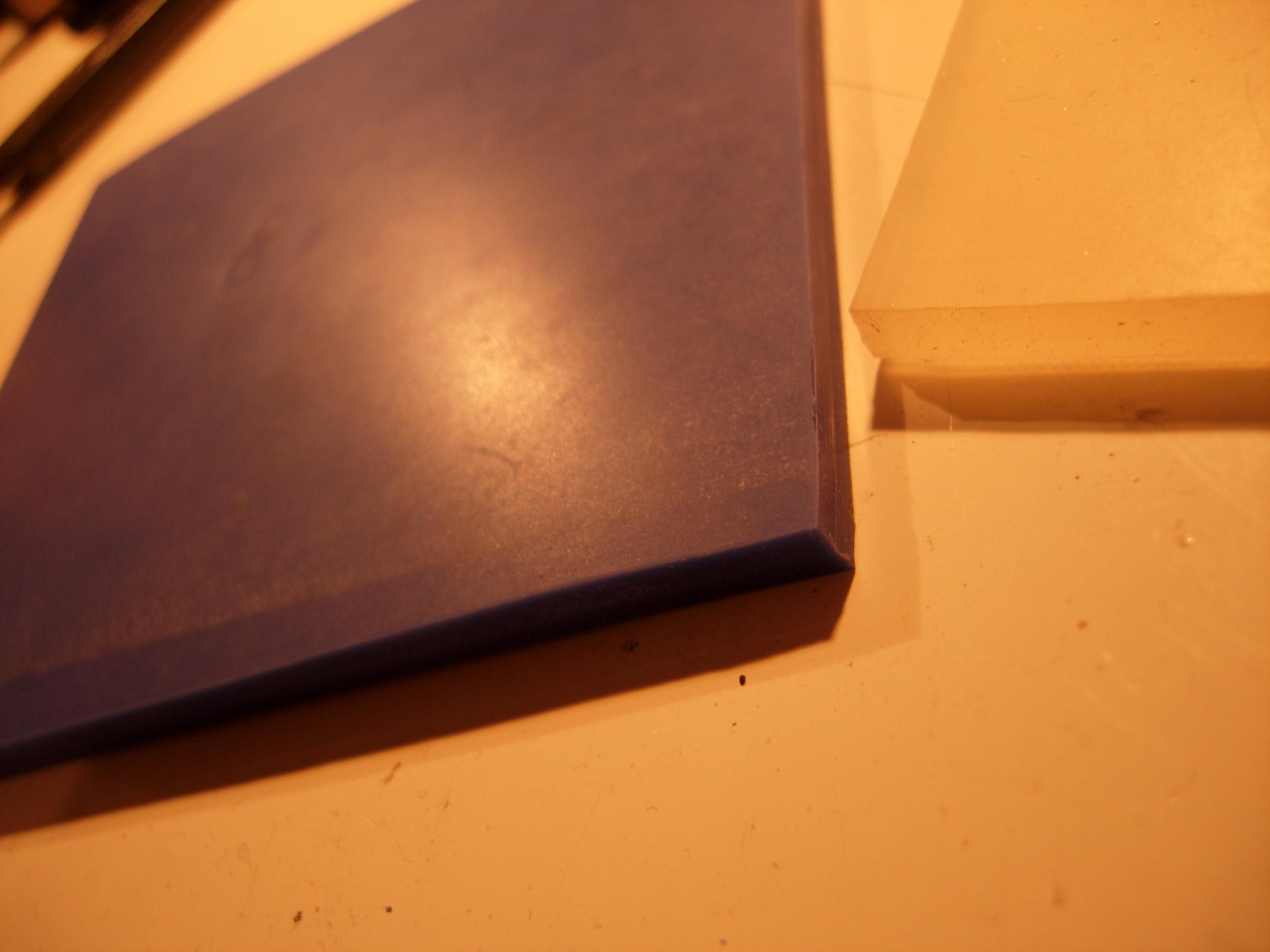

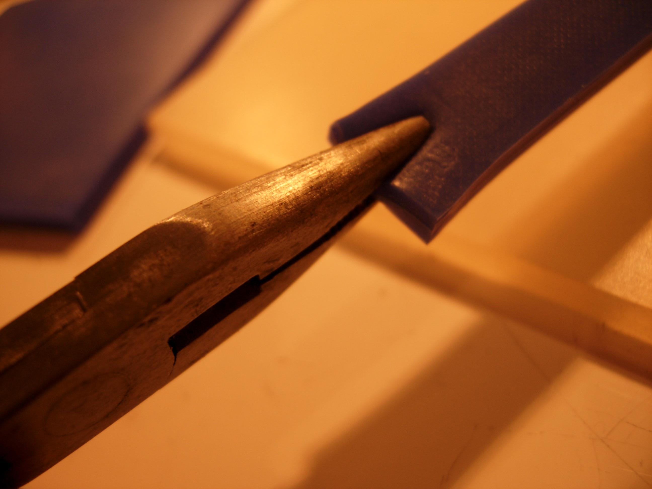

I have some PASS BLUE 60 nm silicone sheet 5mm thick . I have put a piece in some vice grips on the radiator over night at a very similar temp C
The compression would be more even .
BTW, Im only using the bar to avoid putting more holes in the sink
no,I'm only using the bar to avoid putting more holes in the sink
using a clamp bar requires at least one extra hole.
You need a bolt through the clamp on each side of every device and the bolt should be located close to the side of the device.
The clamp bar not be allowed to bend such that a few of the devices are less tightly clamped than their neighbours.
Is silicone dimensionally stable at all temps ? I mean, from power on to idle, it will go from ambient to about 60 - 70 - 80 degrees depending how far you push the bias ...
Can you be sure the pressure will be even at those different temps using silicone ?
Just my 2 cents 🙂 no offense really, the sheet looks very nice 🙂
