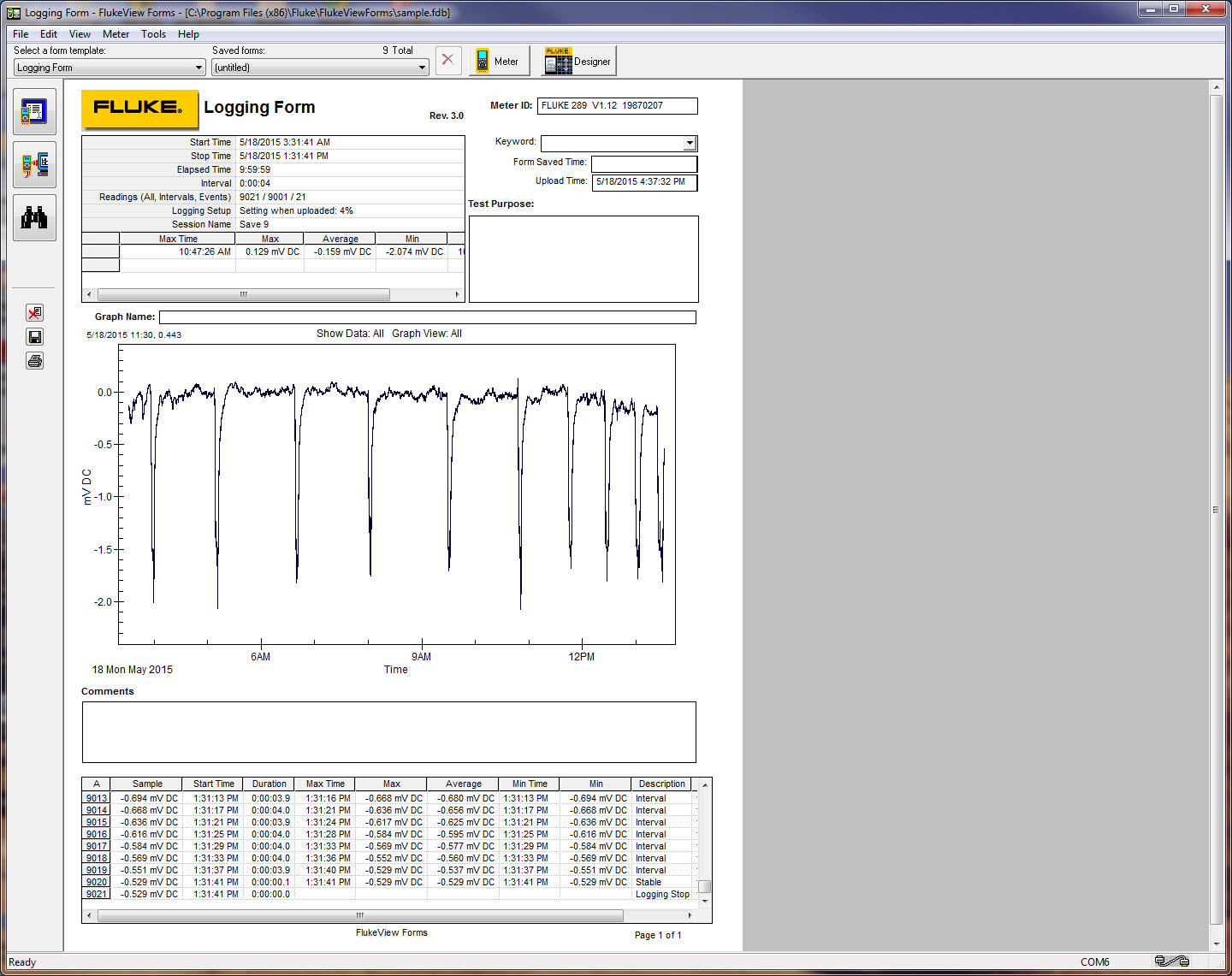

After watching the transistor being tested drift up and down over time, I decided to tape a thermocouple to one and see if the temperature was changing. Sure enough, for no good reason that I can tell, the transistor itself is changing temperature both up and down over time. If it were self heating, I would think it would run away but it eventually cools back down again. It performs this cycle continuously....
If you use an LTP style jig with the two devices thermally coupled, you fairly effectively remove the temperature variation from the comparison of DUT to REF.

I am still having the problem of the transistors not settling down even with their "heads" clamped together. Even if the power supply I am using did not have good regulation, both transistors see the same voltage. The collector resistors are within 0.007% of each other and the bases are seeing a little over 700mv. The collector currents are about 3 ma.
Any ideas?
Any ideas?
