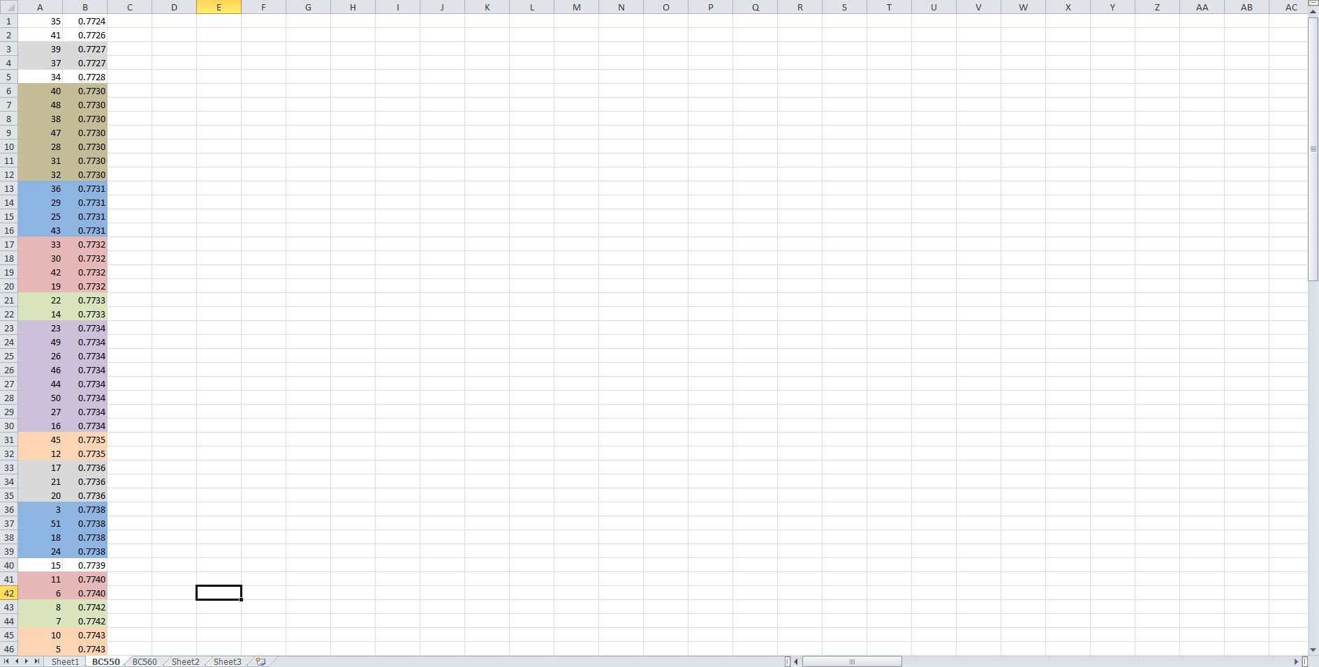

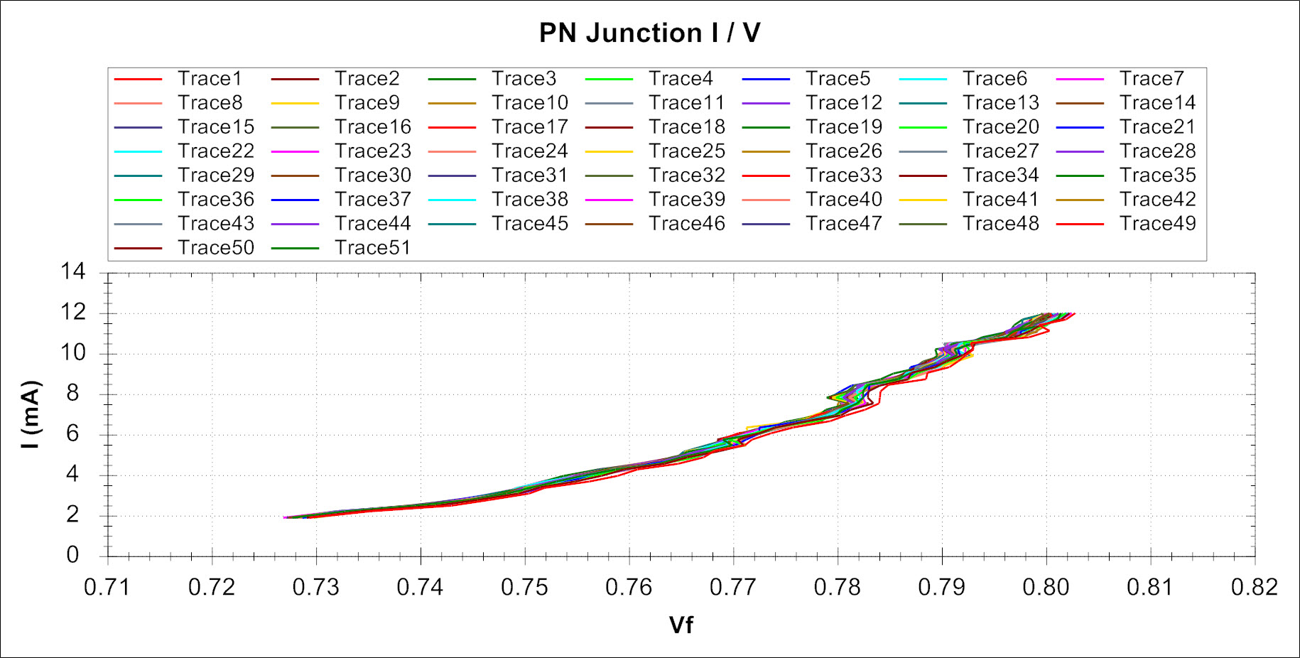

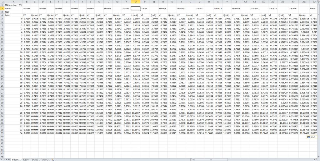

Ok, so I took two of the BC550C with nearly identical Vbe according to the DCA75 PN junction test which takes 34 measurements at different currents and tested them with Fritz' jig:
https://home.comcast.net/~ijfritz/MiscProj/transmat001.pdf
At first I thought there was a problem and then I realized that my meter was reading 0.0003**, almost an order of magnitude less than the 0.002 volts which is considered to be a match.
So it validates the average Vbe measured by the DCA75. I'll post a spreadsheet showing what the graph looks like and also the spreadsheet exported out of the DCA75 software.

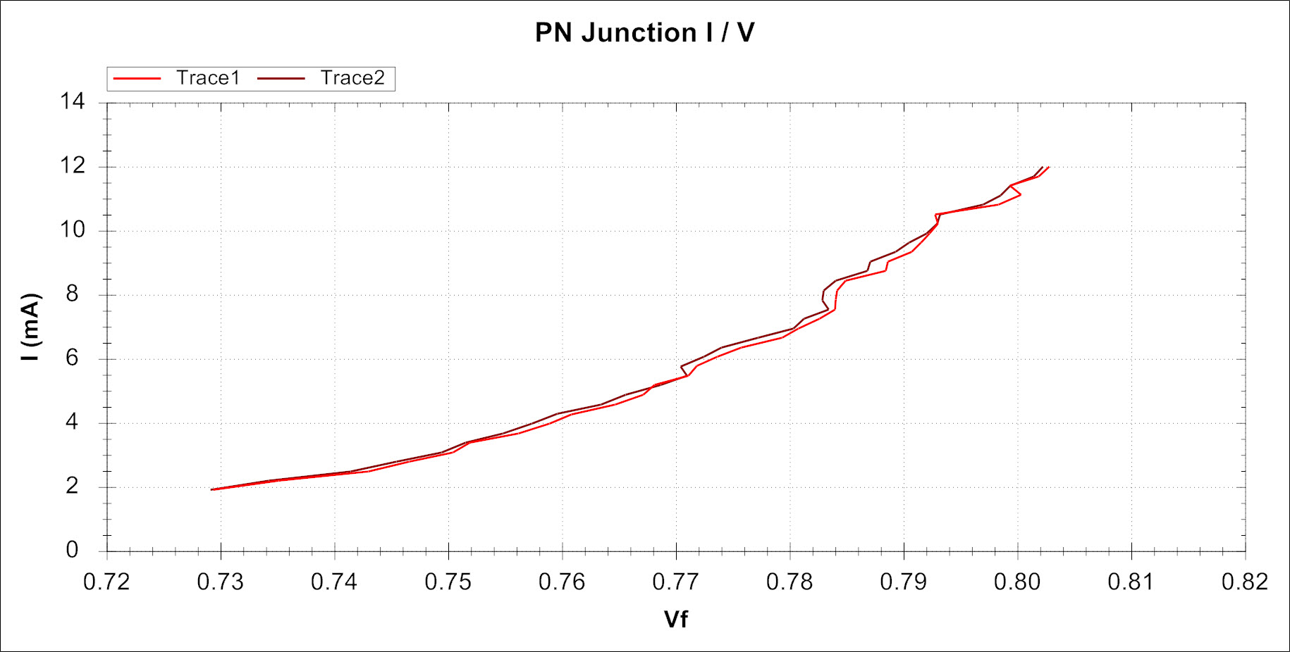

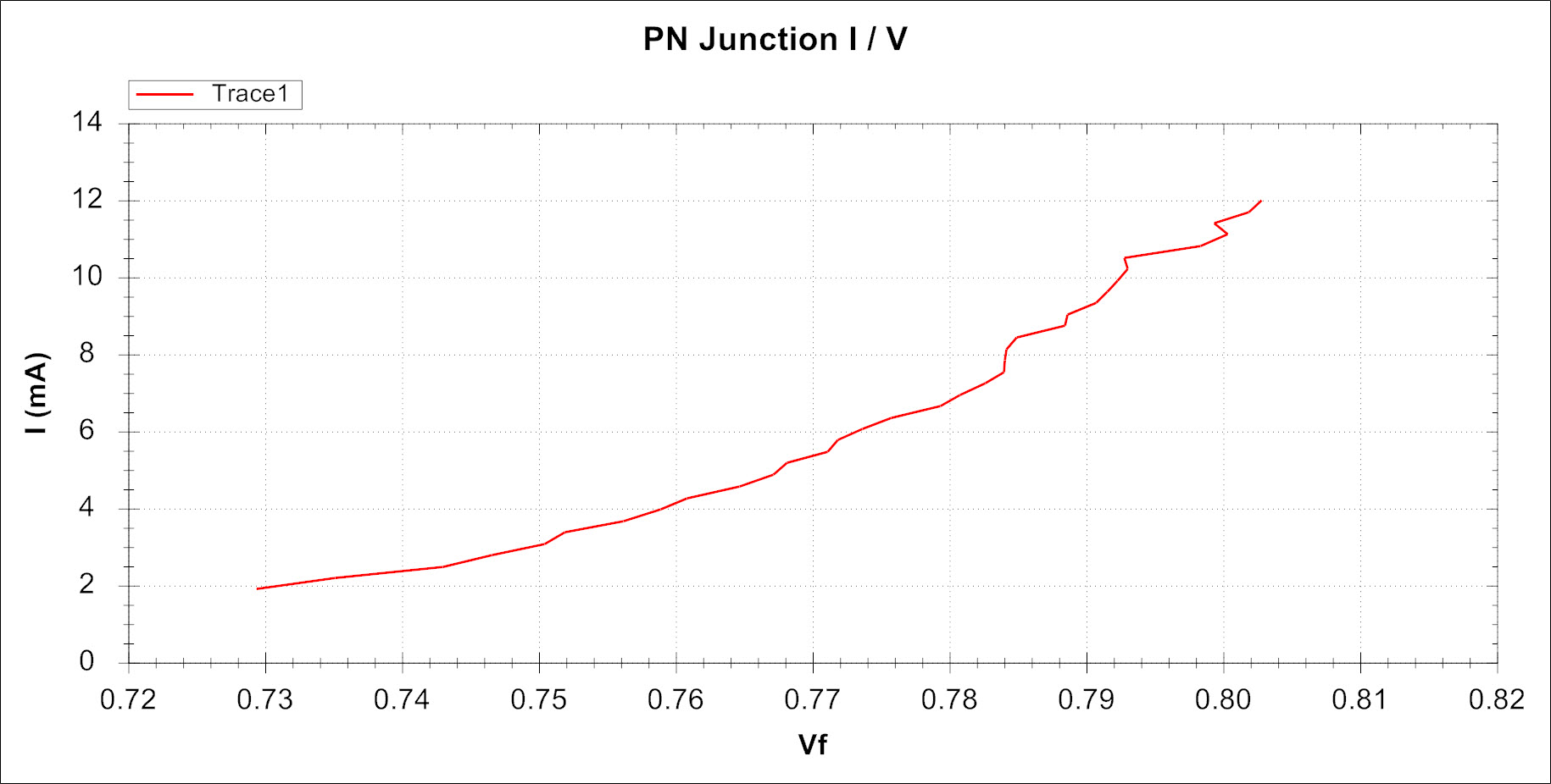

As promised, here are some pics:
Initial import of Fifty One PN junction graphs of BC550C.jpg187.9 KB · Views: 731

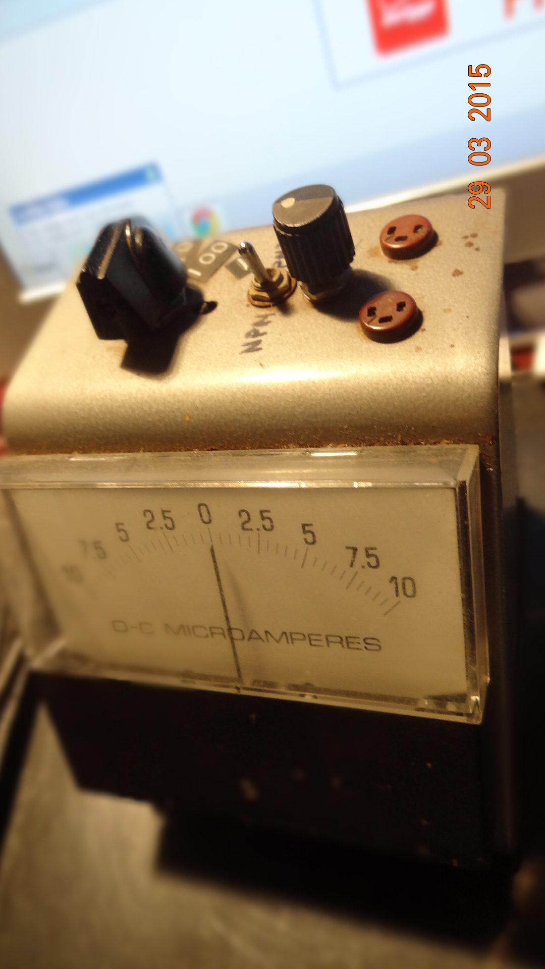

That is a well-known circuit. But unfortunately, not so good for matching complimentary power BJts.Here is a circuit that will perform like the original one is supposed to, but better:
The LEDs could be replaced by a milliameter (and the resistor values adapted)
Do you mean for my circuit, with a milliammeter? In this case, its depends on the range of the instrument, and the sensitivity to deviations you want to achieveIf I replaced the LEDs, what values should I use for the resistors?
What type of circuitry depends on Hfe matching of complementary devices ? Looking for usefully enhanced performance here.
#9
You can substitute a DVM for the panel meter. various R values are used to select closest to the intended circuits operating current. here is the picture of the original unit and I still use it from time to time. This was built about 35 years ago as part of an article I published. It is especially useful for matching complimentary push-pull topologies. I used it on the first Current-Mode Amp -CFA- topology that was all direct (DC) coupled.
THx-RNMarsh
RNMarsh had posted this on some thread.
Gajanan Phadte
