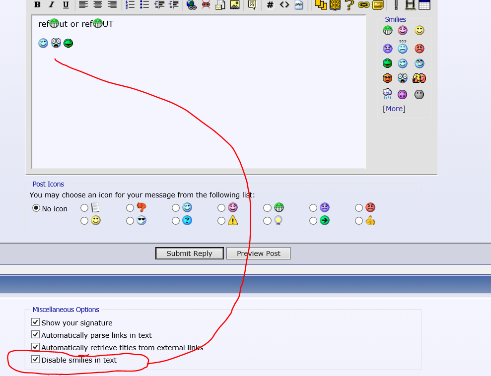

My next post68, even with "Disable smilies in text" unticked is still converting the colon followed by the capital D as a smilie.

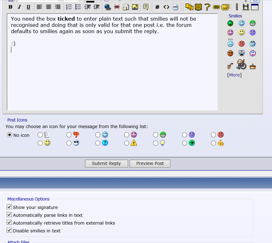

You need the box ticked to enter plain text such that smilies will not be recognised and doing that is only valid for that one post i.e. the forum defaults to smilies again as soon as you submit the reply.

For the current post:
Now I understand.
But does the other screen (Message Editor Interface) for wisiwig apply as a permanent "no smilies"?
Testing:
compare = REF😀UT
And it remembers for editing THIS post and retains the instruction to disable smilies.

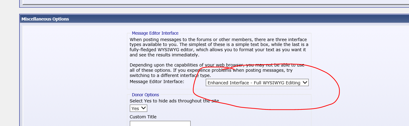

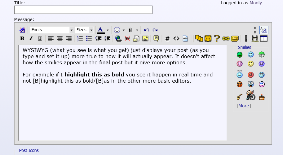

WYSIWYG (what you see is what you get) just displays your post (as you type and set it up) more true to how it will actually appear. It doesn't affect how the smilies appear in the final post but it give more options.
For example if I highlight this as bold you see it happen in real time and not highlight this as bold/as in the other more basic editors.
You don't need keep WYSIWYG. Not keeping it means you see the vbulletin code for things like colour or bold and so on. If I hadn't WYSIWG turned on I would not have seen that bold text until the message was posted. I would have seen the code for bold wrapped around the text as you see in the picture.
If you post a smilie by mistake you will have to edit the post and tick the smilies box. Check the basic text is as you want and then resubmit the post.

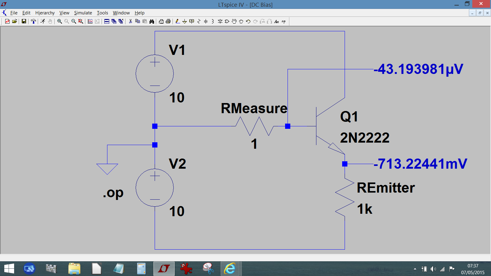

If you take a NPN BJT and hook the collector to +Vcc, the base to ground and the emitter to -Vcc via a resistor, what causes any current to flow through the base?
The base is not biased but I performed this test on a breadboard and current flowed through the collector and emitter but I could not detect any flowing through the base with my 5 1/2 digit meter.
But the base is biased relative to the emitter. If the supplies are say -/+10 volts and your emitter resistor say 1k then around 30 microamps (give or take, it depends on the current gain of the transistor) will flow from ground into the base/emitter junction.
The base current will be there, your meter should show it but it needs to be set for a low current range. You could add a series resistor to the base and try measuring the volt drop across that to deduce the current.

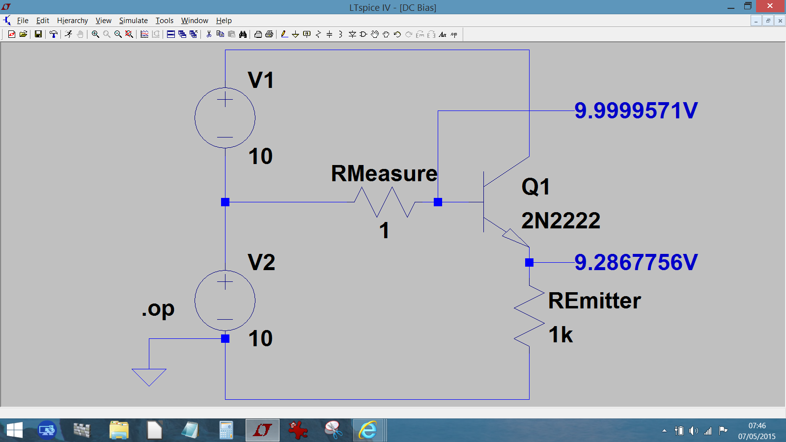

Look at the simulation of what you describe. The -43uV reading relates directly to -43 microampsflowing in the 1 ohm resistor. There is around 9.3 milliamps in the emitter resistor. Ignoring the base current (because its so small) we get a forward gain of 9.3E-3/43E-6 which is 216. That's about right for a small signal transistor like the 2N2222
Edit... ground is just an arbitrary point you decide upon. Move the ground to the lower rail and it might be easier to visualise. Doing that gives you a 10 volt supply as 'bias'. The currents are identical if you calculate them out from the voltages and resistor values.

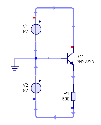

Hey, but transistor should conduct the current.
If you connected transistor like this
attachment.php
Transistor will be ON and current will flow. Do you see how?
Even if you disconnect the base, you can TURN-ON your transistor just by touching the base with your fingers.
