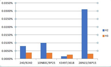

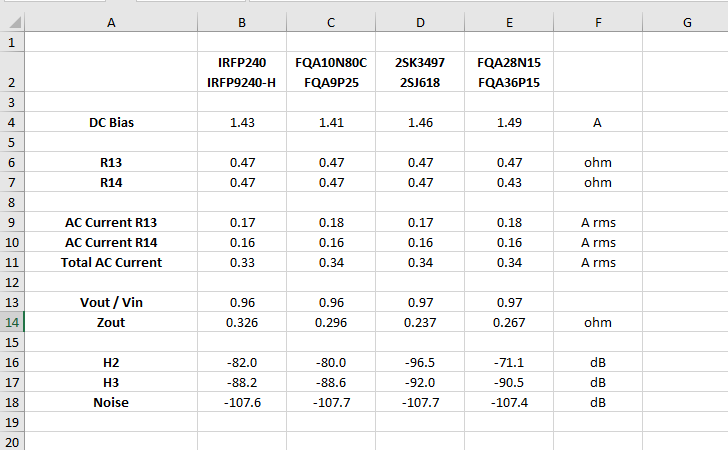

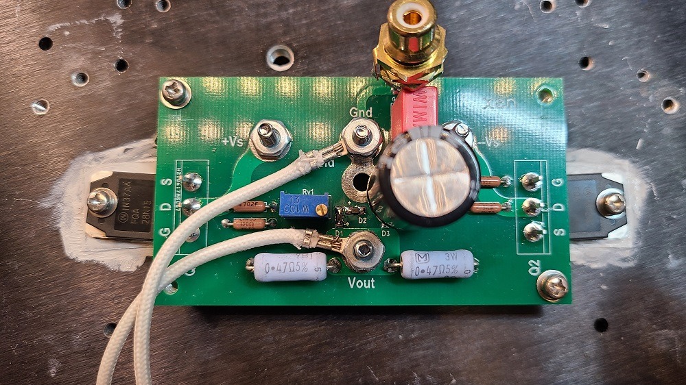

So we did a quick board for only the output stage of the M2 with optocoupler biasing.
The only change was C3 now reduced to 10µ for a more stable bias against thermal drift.
Here are the results.
As one would expect, the devices with higher Yfs give lower Zout.
The clear winner is the Toshiba pair, though it is a bit unfair as they were curve tracer matched.
All other device pairs were just random examples from Mouser / Rochester.
The IRFPs with Harris 9240 is a good solution without unobtaniums, tightly followed by FQA10N80C / 9P25.
We like the 9P25 a lot. Clearly outperforms the 9240 in the UDNeSS.
Patrick

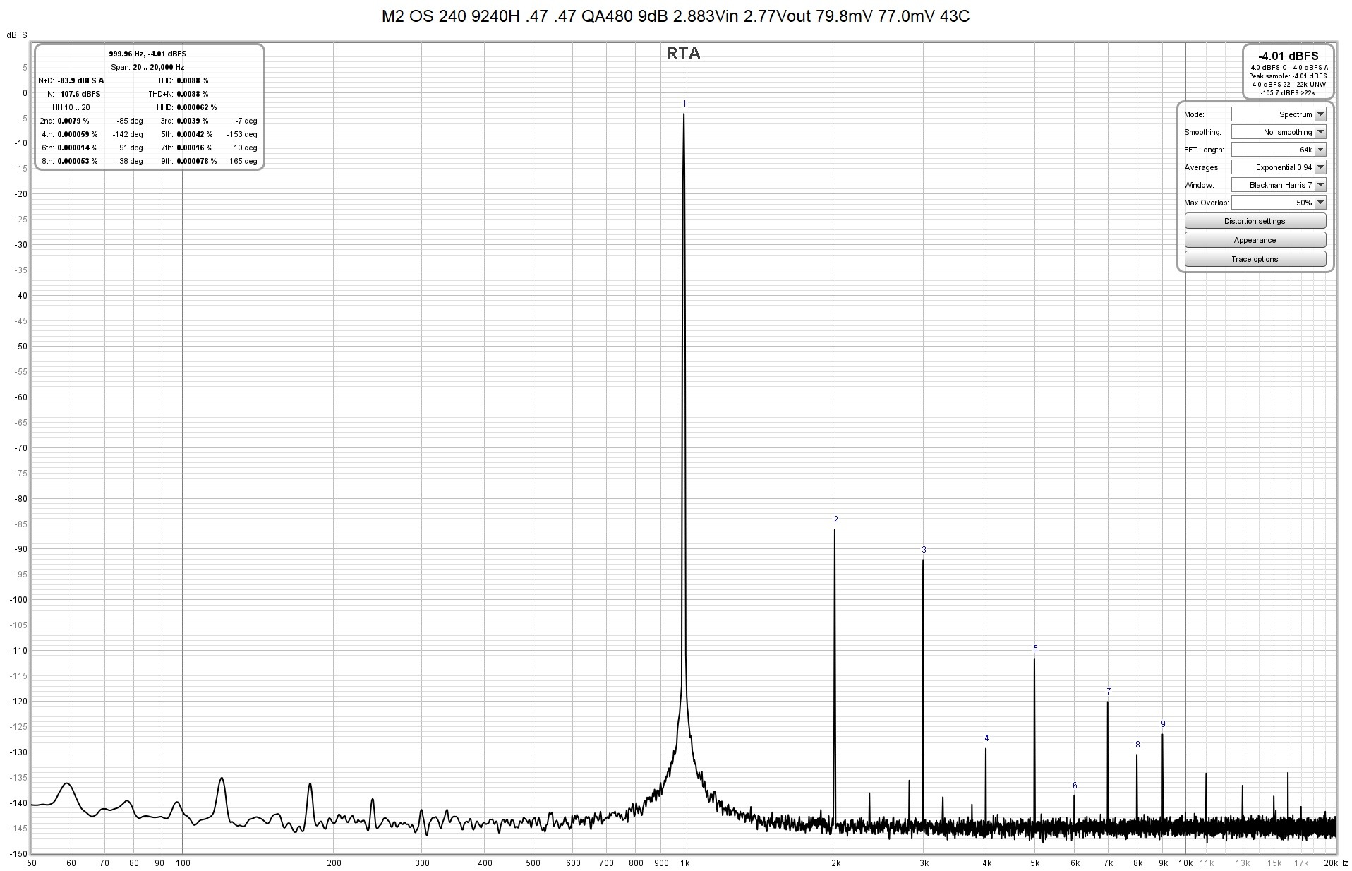

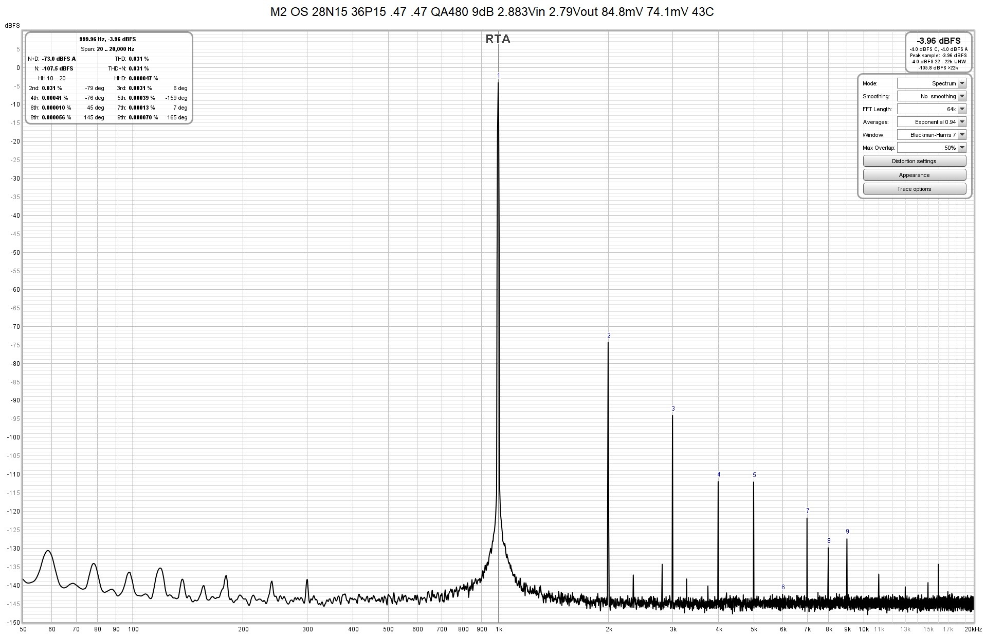

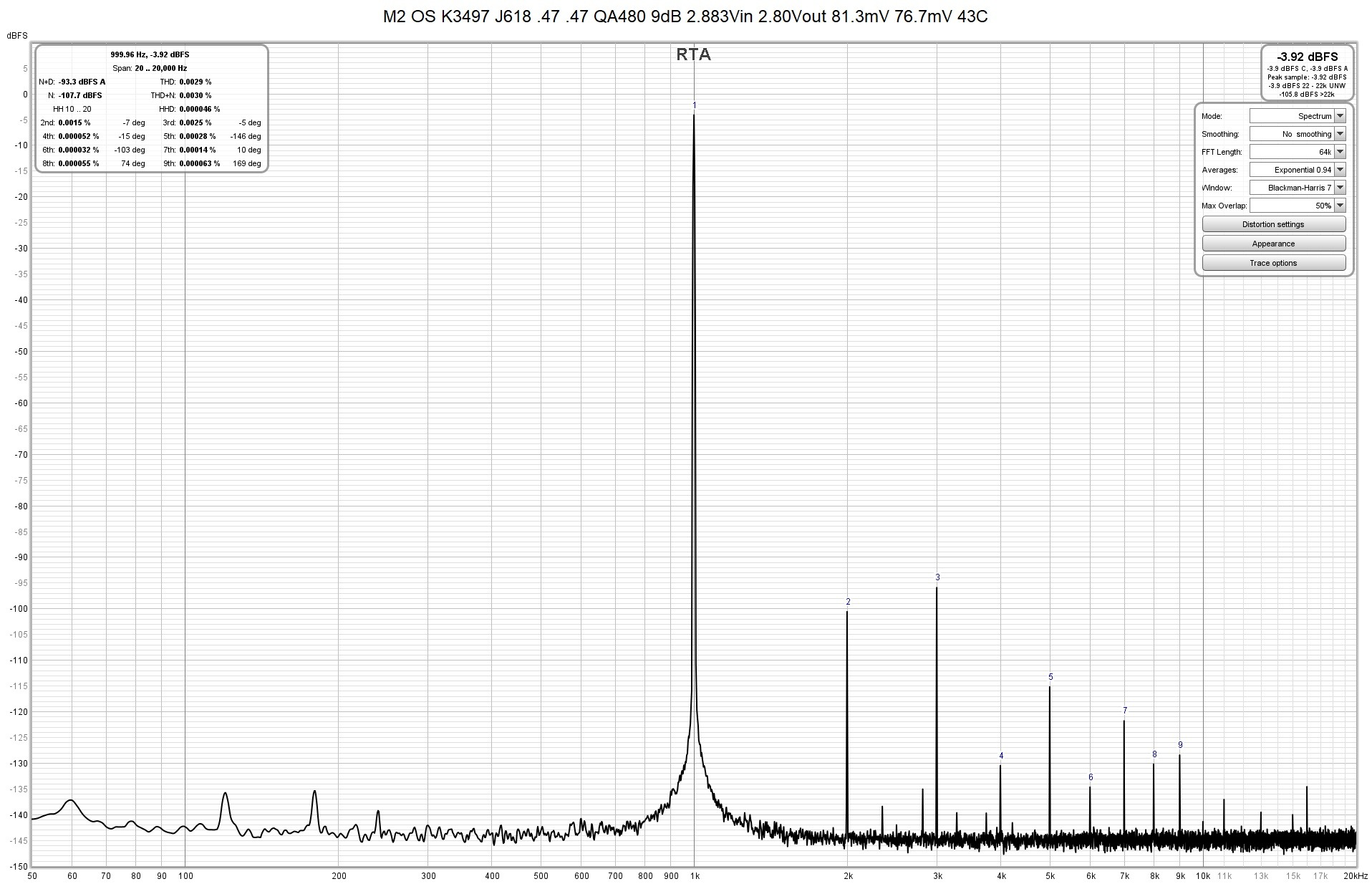

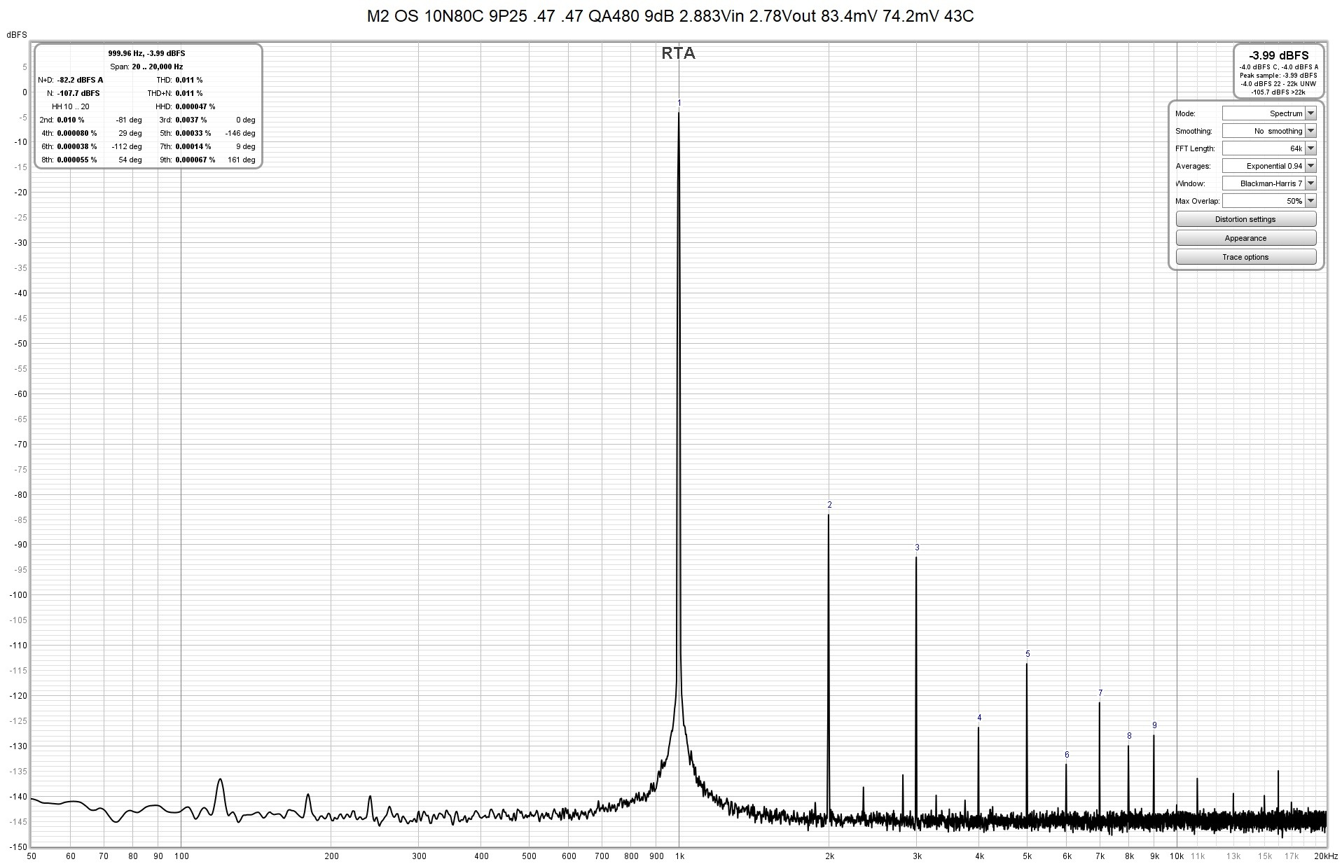

Some FFT plots.
Many many thanks to the kind gentleman in Canada who did all the experimental work for us.
Patrick
Patrick
M2 OS 240 9240H .47 .47 QA480 9dB 2.883Vin 2.77Vout 79.8mV 77.0mV 43C.jpg445.5 KB · Views: 376
M2 OS 10N80C 9P25 .47 .47 QA480 9dB 2.883Vin 2.78Vout 83.4mV 74.2mV 43C.jpg444.6 KB · Views: 385
M2 OS K3497 J618 .47 .47 QA480 9dB 2.883Vin 2.80Vout 81.3mV 76.7mV 43C.jpg445.6 KB · Views: 375
M2 OS 28N15 36P15 .47 .47 QA480 9dB 2.883Vin 2.79Vout 84.8mV 74.1mV 43C.jpg447.1 KB · Views: 406
I should add that the Toshibas will allow you to go closer to both rails in addition,
due to their much lower Vgs.

Understanding that the Toshiba parts were curve tracer matched and possibly explaining why there is so much H2 cancellation, I think it's amazing how the different devices display such a difference in H2/H3 ratios and amounts. One could potentially tune an amp according to preference in taste by using a specific pair or aim for outright lowest total THD by using matched N-P pairs.
I wonder what an F5 would sound like with the FQA28N15/FQA36P15 (increased H2, reduced H3 over the IRFP240/9240 pairing) for example
Absolutely no doubt the performance of the Toshiba parts is amazing!
Yes. Also you can adjust this with the ratios of the Source resistors - see the ACA Mini...
Matching will allow you to lower H2.
But look at the Toshiba also for H3 !!
You won't get H3 down with the source resistor trick.
Patrick
Patrick

Do you know which of their “A” series power amps were the last to use the Toshiba’s?Last but not least, 2SJ618 / 2SK3497 as used in Accuphase power amps before switching to Fairchild.
Simply because the Toshibas became obsolete.
Degen is 0.05R on NMOS when applicable.
Yfs at 1.3A = 3.75S & 4.43S (raw).
Highest of all. Also much lower Vgs at ~2.4V.
