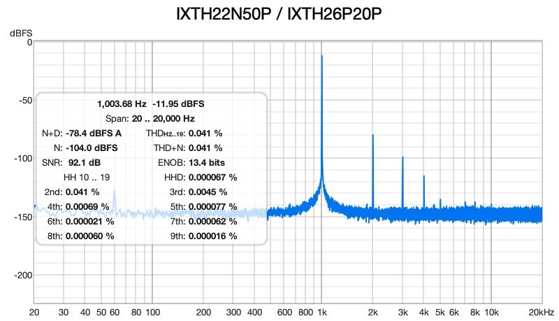

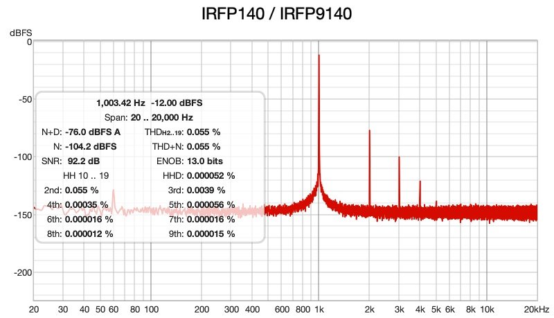

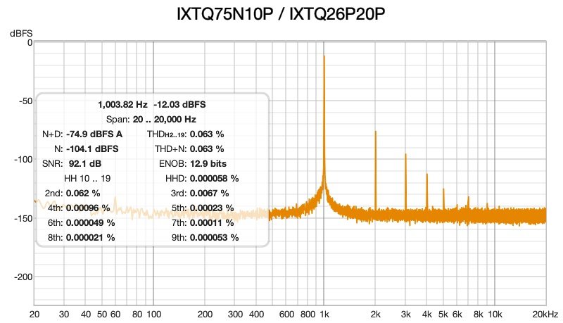

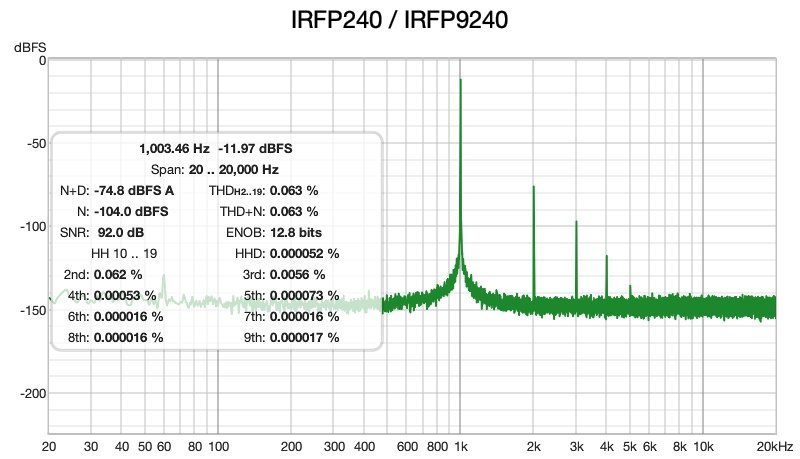

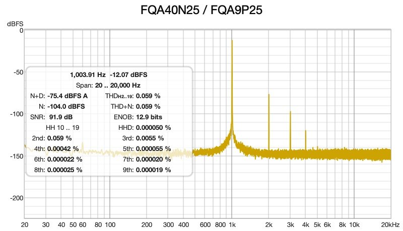

In case anyone cares, here are distortion measurements for 5 different MOSFET pairs:
  • IRFP140 and IRFP9140
  • IRFP240 and IRFP9240
  • IXTH22N50P and IXTH26P20P
  • IXTQ75N10P and IXTQ26P20P
  • FQA40N25 and FQA9P25
In each test the MOSFETs are in an F5 amp (the exact same F5 amp) running with 22V rails and 1.3A bias. The test is a 1Khz signal (from the Akitika generator) at 1W into 8ohms.
I was surprised at how closely they all measure. The 2nd harmonic ranges from a high of .062% -- the IRFP240 pair and the IXTQ pair -- to a low of .041% -- the IXTH pair. The 3rd harmonic ranges from a high of .0067% -- the IXTQ pair -- to a low of .0039% -- the IRFP140 pair.
