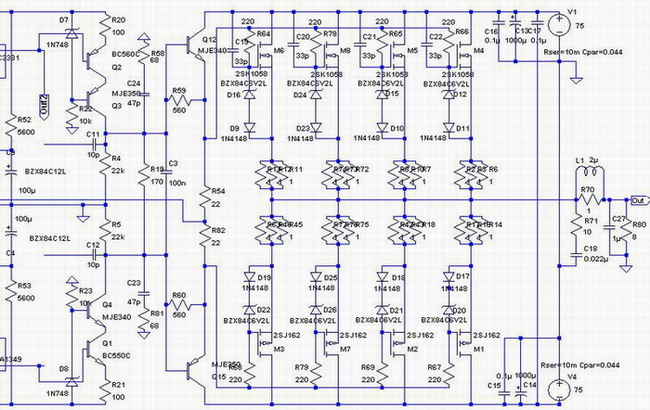

I've done some research about the capacitance of MOSFET's. I've collected some arguments:
If you have a common-source stage the Miller feedback from drain to source via this capacitance causes the input impedance to dynamically change.
In MOSFET's the reverse capacitance is really a problem, it looks small in datasheet but it's magnified when the Vds changes and is very noticeable even in a source follower, the Cgd impact is far greater because with an amplifier with for instance a rail voltage of +- 50 V the Cgd is working against a voltage change of up to 100 V swing related to the Gate comparing to the Cgs which is working against a voltage swing of just some volt.
***slowhands
Not really, Cgs is what limits how fast you can drive them. Generally MOSFETs are driven through a gate resistor to quench oscillations, and the RC time constant of the gate resistor and Cgs limits the speed of the device.
***Charles Hansen
Nope, not in a source follower configuration. In this case the source "follows" the gate (clever naming scheme, eh?). There is (essentially) no change in voltage between gate and source, and therefore Cgs is never charged or discharged in a source follower.
In the next thread you can find how to calculate the total charge:
http://www.diyaudio.com/forums/showthread.php?s=&threadid=51831&perpage=10&highlight=&pagenumber=3
My calculation:
Crss= Cds + Cgd
Ciss = Cgs + Cgd
Crss = Cgd
2SK1058: deltaV GS= +-5.5V, deltaV GD=+-140V, time 1µS
*Cgs charge: 3300pC
*Cgd charge: 1400pC
--> gate current is +-4.7mA
2SJ162: deltaV GS= +-5.5V, deltaV GD=+-140V, time 1µS
*Cgs charge: 4950pC
*Cgd charge: 5600pC
--> gate current is +-10.5mA.
As you can see the Cgd charge values are about the same as the Cgs values. But the Cgd (Crss) is much smaller than the Cgs (Ciss) value on the datasheet. This is due to the big voltage (deltaV) changes between G and D in a source follower.
In other words, it looks me the best to compensate a N with a P channel Fet to put an extra cap between Gate and Drain (Cgd).
If we want to make the gate charge of the N Fet equal to this of the P fet:
1) We must have a total capacitane of 51pF between Gate and Drain: +40pF (Crss K1058=10pF)
Or
2)We must have a total capacitane of 1663pF between Gate and Source: +1000pF (Ciss K1058=600pF)
I will choose for option 1. So I will put an extra cap of 33pF between Gate and Drain.
For the gate resistor:
I won’t change the value of the gate resistors, because when the capacitances are the same, the time constants will be either. Ciss (Cgs) won’t change much (delte V = +-constant), and the Crss(Cgd) values are +- the same due to the extra capacitor.
Greetz
Ben
You really strain out the gnat and swallow the camel!
Mosfets will do without any additional caps.
VAS without higher load to the ground won't do.
give at least 47k-62k to the ground instead of 10k.
You may increase R4/5 too for immediate gain.

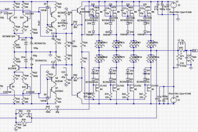

I think I've found the problem.
In the sim program's you can adjust the simulation time. And when I set the time at 0.001s with a frequency of 1kHz, there will be just one period to see.
When I take a look at the distortion than, I have 0.02% with 40Vp output voltage (1.28Vp input).
Do I always have to set the simulation time so that there is just one period to see? I this one of the rules of sim programs?
I'm just playing with this program for the last month.
Cheers
Ben

Some results:
* When using local feedback from VAS to the inverting input of the diff pair --> oscillation is even more worse. But when connecting is to the non-inverting input --> oscillation is gone or less worse, dependent on the input voltage. (looks like there is phase invertion with these high frequency's.)
*When I delete the emitter folower after the VAS, the amp is stable, but this gves me higher THD on high output power.
*When I take the feedback signal out of the VAS (only from VAS) --> the amp is much more stable and gives better THD with capacitive loads. But, with resistive loads the THD is better when taking feedback from the outputsignal. So, I should mak a combination of these two.
*When I connect a capacitor + resistor (47pF + 68Ohm) from the two outputs of the VAS to ground, the amp is also stabile, but the THS is a bit worser compared to the miller caps. Can you tell me what really the reason is why miller compensation isn't good? See attachment.

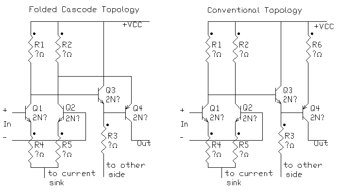

Folded cascode:
I've red that this one is more sensitive to a bad setup than a cascoded vas. The bandwith is of a folded one is very big.
Voltage loss: I've attached a picture (see next post). First you have a voltage loss over Q3 (Vce), this signal is then used to drive Q4, the emitter voltage of Q4 is taken after the load resistor R2 from the diff input. The voltage over R2 is in my design already 10Volts.
With the cascode VAS, I have a loss of about 4Volts.
Yes, there will be other design's that are more suitted to use a folded cascode.
I ran this evening a few hundred sim's, I've been playing with the feedback. I've made a combination of feedback from the VAS and from the output. This results in a pretty good THD amp. When there is a highly capacitive load on the output. You would have enormous amounts of THD in the signal lines wright after the diff pair (pairs). With also the feedback taken from the VAS, the THD stays pretty normal after the diff pair (for example :0.5% VS 25%).
With a input voltage of 1.28VP / 100kHz and load 4Ohm + 1µ, I've a THD of about 0.25%.
With a input voltage of 1.28VP / 1kHz and load 4Ohm + 2µ, I've a THD of about 0.05%.
This is not that bad I guess.

Hi Bensen,
the folded schematic you show should have r2=r1/10 approx.
The voltage at q4 emitter= voltage at q3 base.

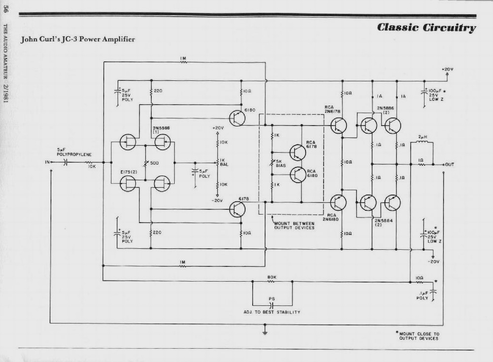

Your schematic posted with the two feedback loops is very similar to Leach but with one pole missing. Read Leach again. Borbely also takes a feedback loop from r54/r82 but instead uses diodes for voltage adjustment. Borbely manages his folded without any local feedback cap, although he consistently connects a cap to ground here.
Hi Bensen,
voltage loss of a folded cascode can be reduced to 2-3 volts, very similar to what in a cascoded VAS can be done. In a folded cascode forget about Q3 connect the base of Q4 directly to Q2. R1 can be omitted. Voltage across R2 should be choosen of about 2 volts. To perform this, use two red LEDs to V+ on the base of Q4 for example. Bias through Q2 should be a little bit higher than the sink current Iq of the LTP. So
R2,max = 2V / (2 * Iq)
To prevent oscillation, use a cap of about 100pf from the collector of Q4 to GND. This is a nearly bullet proof solution.
Andrew,
Yes I know, but when I insert a capacitor like Leach, that shortens the feedback from the output to ground on high frequency's, and uses only feedback from VAS. I didn't get good results. THD is the signal lines after the diff pairs is much worser.

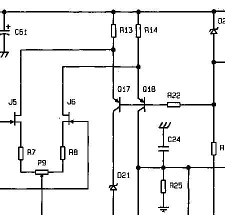

Andrew,
If you look at the base of the VAS transistor it is hooked up to the drain of one of the differentials, a true folded cascode base is attached to a fixed reference voltage and its drive is applied only to it's emitter.
To answer your question, I believe Curl was first.
Maybe you could call it a partial folded cascode...............😉
