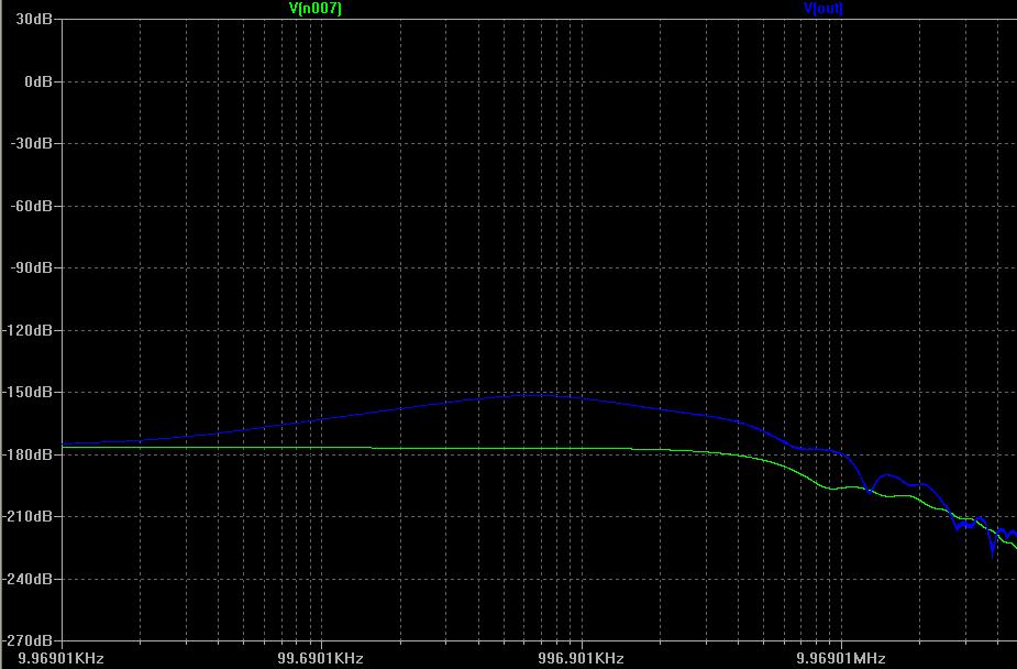

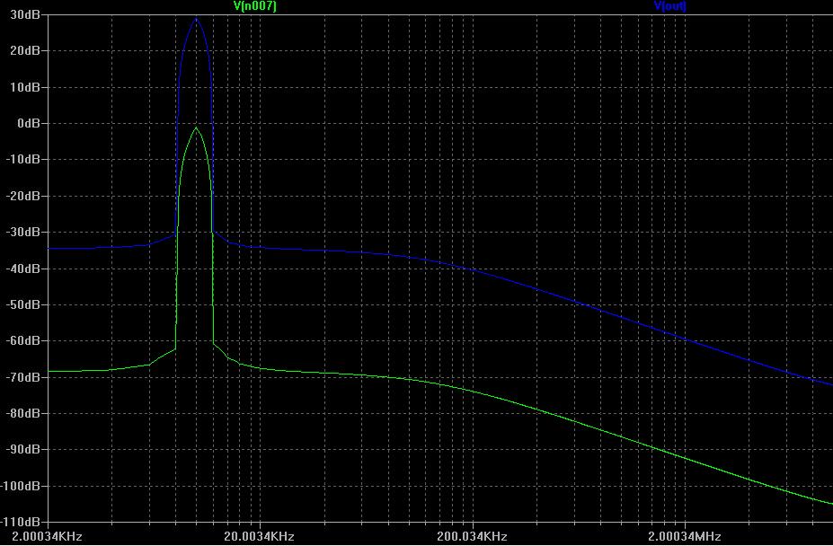

Ok, I will try to build the circuit.
I've set the time step a factor 10 bigger, now it takes about 30 seconds for the FFT.
In the attachement you can see the FFT of the output signal and the input signal (green).

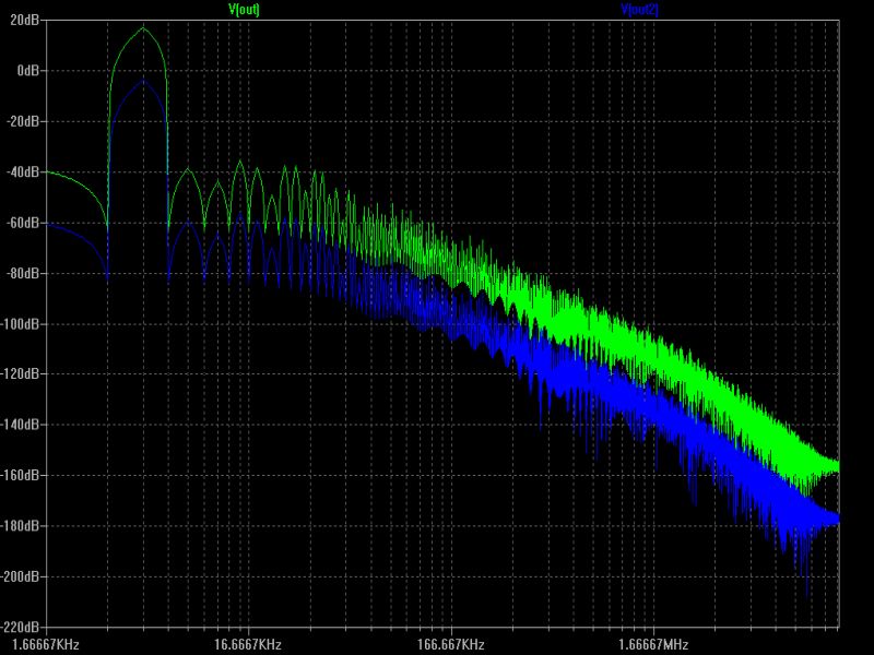

Heinz,
Here you have the FFT of output and input signal. Inpupt signal is connected to ground.
I stopped the sim after 20%, otherwise ist should taken over 30minutes to finish the sim. I don't know why it goes that slowly when input is connected to ground.
What looks strange to you in my previous post. What were you expecting? Can you describe it this? Maybe I can follow your way of thinking better than.
Sim:
Noise at output: +-240nV/Hz½.
Ben
Ben,
honestly I must say that I not understand why in the FFT with input and outputsignal I find two "noisegrounds" and we can also see now in Your last FFT (without inputsignal) that noise is not the reason : floor is really low!.........
OK,
in this moment I do a simpel test here : One source and a divider to get two different signals and I also see "different-floors"!!
So again is the question why You can get not down for EG to -100dB!!???
Here I simulte 50Hz 10V and 0,9V with timestep 100ns!
For Your signal (5kHz) this this had to go proportional shorter!
May be You try a sim by deep freqencys to save time.
Now I "belive"(?) again that the timestep is too big.
Heinz!

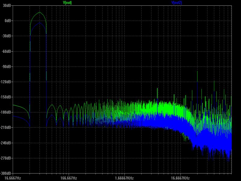

Ben
Before I go to sleep I do a last test:
Circuit as before, again only 3 periods now not 50Hz but 5kHz.
Notice : I don`t change the (for 50Hz small !) timestep:still 100ns.
For the same resolution I had to go to 1ns.
Heinz!
Heinz,
So, to your test it's logical I have to noise floor. But the noise floor is dependent on the frequency.
When I decrease my input frequency to 100Hz, the noise floor drops to about -90dB by 120kHz. And input frequency 50Hz--> -100dB by 120kHz.
Greetz
Ben
Hi Ben!
I had to assume Your timestep is still 10ns?
Then You had to reduce him linearly with increasing testfrequency
to get the same (deep) noisefloor.
So Your computer has something to work and You to wait but at least You should get a FFT-picture which shows you the harmonics You calculated already with ".four" command.
Heinz!

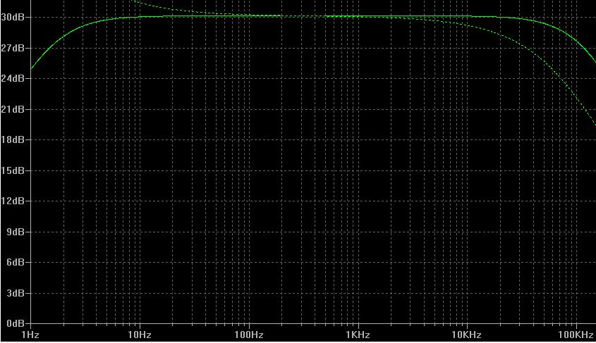

Can anybody tell me how I can determine the bandwidth of an amplifier. I know that OLG and bandwidth have direct influence on eachother.
Can I do this with an AC-analysis in LTspice? Do I have to read the highest frequency where there still is no decrease in gain.
For example: when the gain in my amp is 32dB, and the gain decreases from 10kHz--> the bandwidth is 10kHz? Or do I have to look at the -3dB point, to the frequency at 29dB?
And what are the normal values of bandwidth's in good quality amp's? I have here a schematic from elektor where the amp has an BW of 55kHz, but the OLG is only 2180x.
I'm experimenting with a complementary cascoded differential VAS, the OLG is about 13000x.
Greetz
Ben
Does it mean that when you take a look at the attachment, that this amp has a bandwith of +-110kHz?
Normal gain is +-30.1dB --> 27.1dB = 110kHz.
What do you think of this value? To big??
Ben
