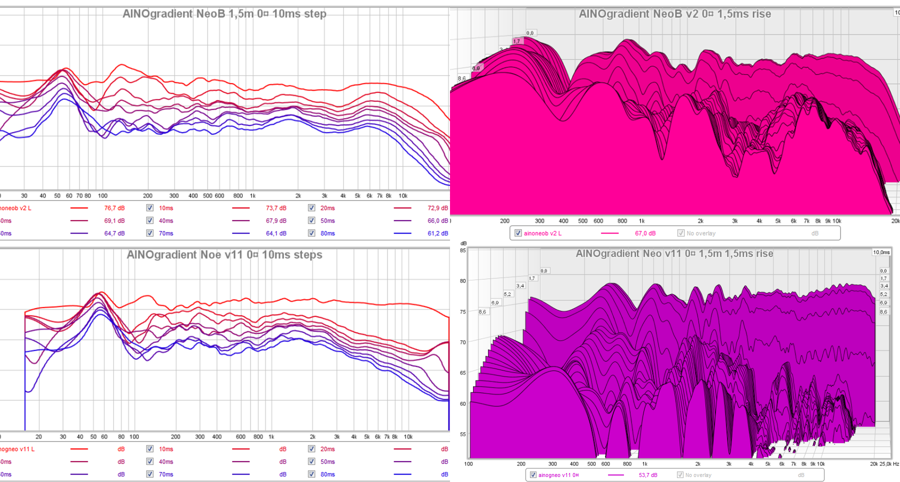

Interesting thing about the ambient driver thing -- if the system is measured in the "normal" way (quasi-anechoic, with windowing terminating the impulse response somewhere before 10msec) the frequency response measurement is for all practical purposes identical with or without the ambient driver playing. Yet even my HF hearing impaired wife can hear an unquestionable difference (maybe even "from the kitchen"!)
Interesting thing about the ambient driver thing.......
........the frequency response measurement is for all practical purposes identical with or without the ambient driver playing. Yet even my HF hearing impaired wife can hear an unquestionable difference (maybe even "from the kitchen"!)
Bang on!😀
To see rear tweeter's effect with REW it is best to look at signal decay with long enough time window (use Decay, CSD or Spectrum window).
NeoB is same speaker with rear tweeter added. On axis is not same but look at how treble decay vs. on-axis changes! Measured almost 5 years ago, published also in my signature thread.
