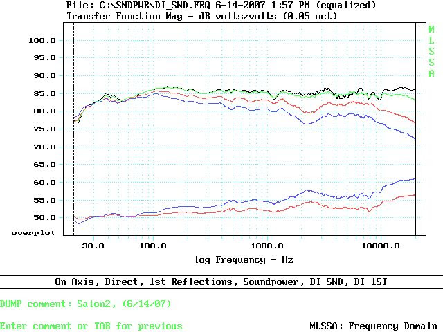

Regarding the differences between the M2 and the revel - I thought the same as you - but here are the "Spinorama Measurements" from both the Salon2 and the M2:

But note the much flatter direct and off axis response from the M2. The Salon does have evidence of the 'bbc dip'.

You right right about the 'dip' - I bet that is the LR4 TM crossover affecting the power response.
If so, and this does subjectively improve sound quality, then why fight it? :eek:
