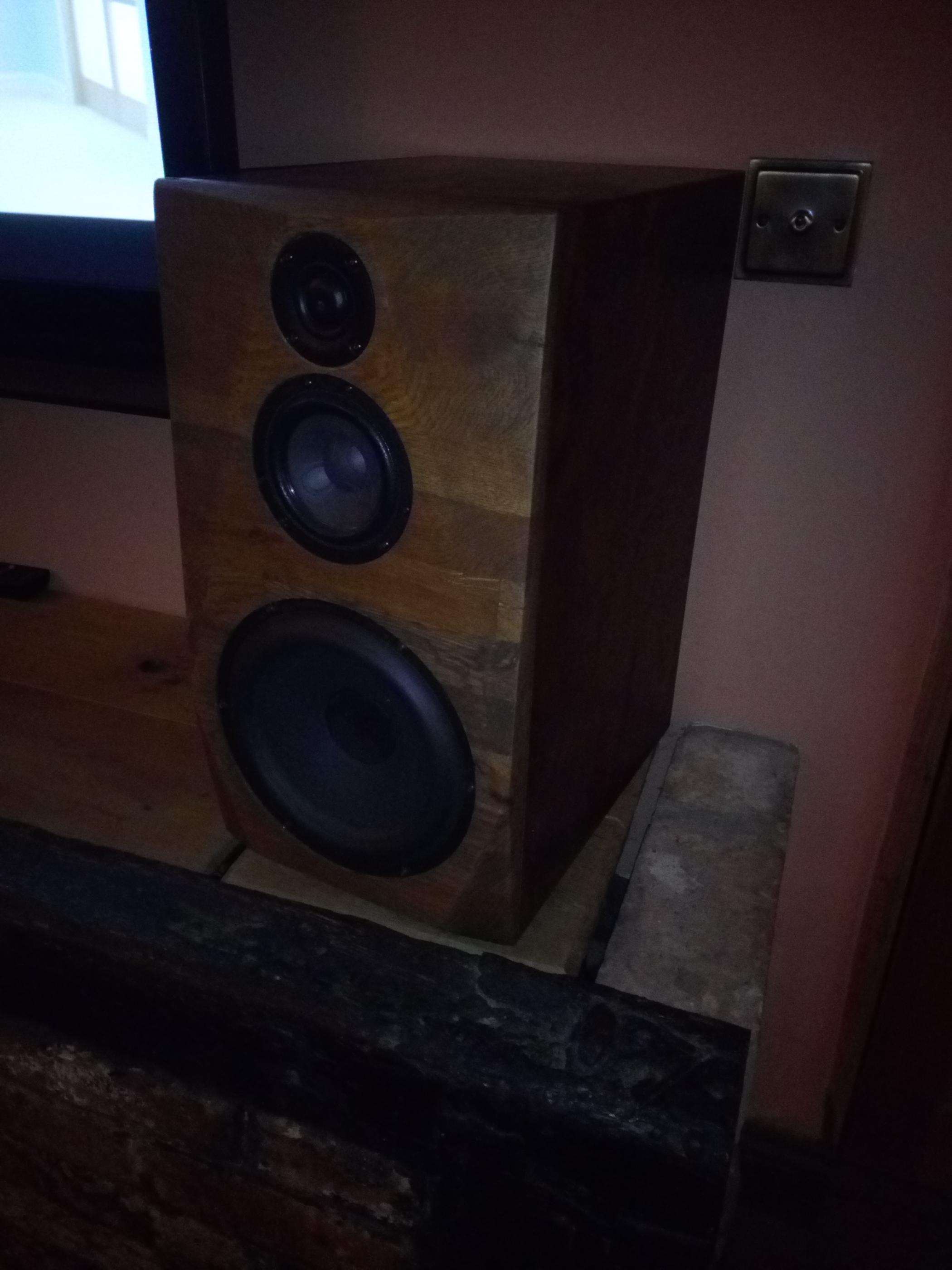

I should say I made another 4 way as one of my first complex builds and this speaker is now relegated to multichannel use only in my surround sound set up as it doesn't hold a candle to either of these set ups!

Sorry, wasn’t clear which speaker is related to multichannel and which doesn’t hold a candle? Your latest 4 way is now better than spheroid 4-way? Also, is it 4-way because of a sub somewhere because I only see 3 drivers?
Sorry that is a photo of my first complex speaker build (built 5 years ago!) a 3-way box speaker supplemented with multiple subs in the room - therefore making it a four way.
It is very good - 12MU mid, SB acoustic ring radiator and SS 8" woofer - but is not as good as either the synergy or the 4 way sphere build.
It does fine as the mains in my multiway cinema set up, but is not as good as my other creations!
