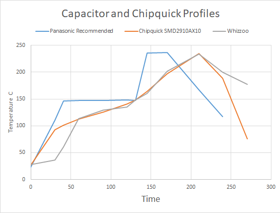

Then it must be the oven / air currents / temp profile. My bet is on the profile.
With the Controleo3 you build a profile for the solder paste in use -- in my case i made a profile to work with Chipquick SMD2910AX10. Looks like Panasonic "soak time" is quicker. (The oven will cool down much more quickly than illustrated in this chart.)
