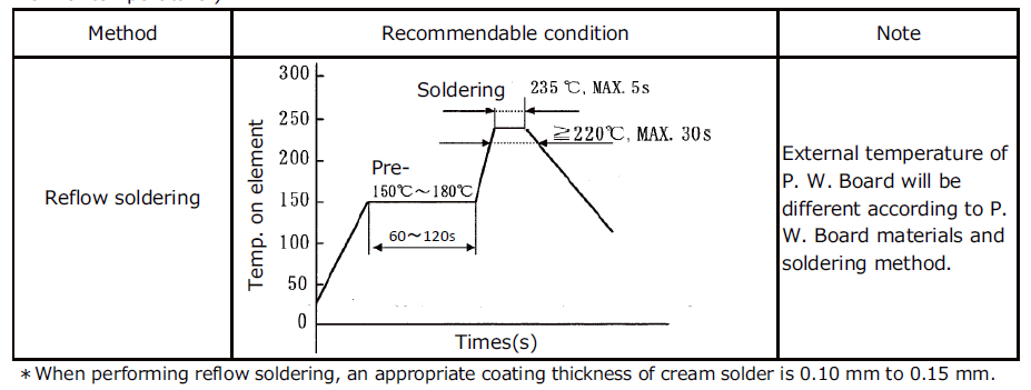

I have a "Toaster Reflow Oven" with the Controleo3 MCU. Whizoo.com Works great for SMT film capacitors most of the time, but I have found that the devices oftentimes don't like to remain seated.
You can design your own reflow profile to fit the datasheet of your solder paste and film capacitor with the Controleo3.
I recommend getting a stencil -- those from JLCPCB are stainless steel and very good.

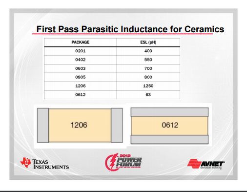

I have not seen those before. ESL is an important spec for decoupling/bypass caps. Sometimes ESL is extremely critical.The reverse package sizes look handy for staying with C0G caps when inductance matters.
I have not investigated its importance in compensation caps. My intuition says it's not that important there. The ESL of either 1206 or 0612 is going to be quite a lot better than thru-hole ESL.
I don't know how is the measurment in esl spec but radial lytics with 2.5 mm leads spacinf still exists.

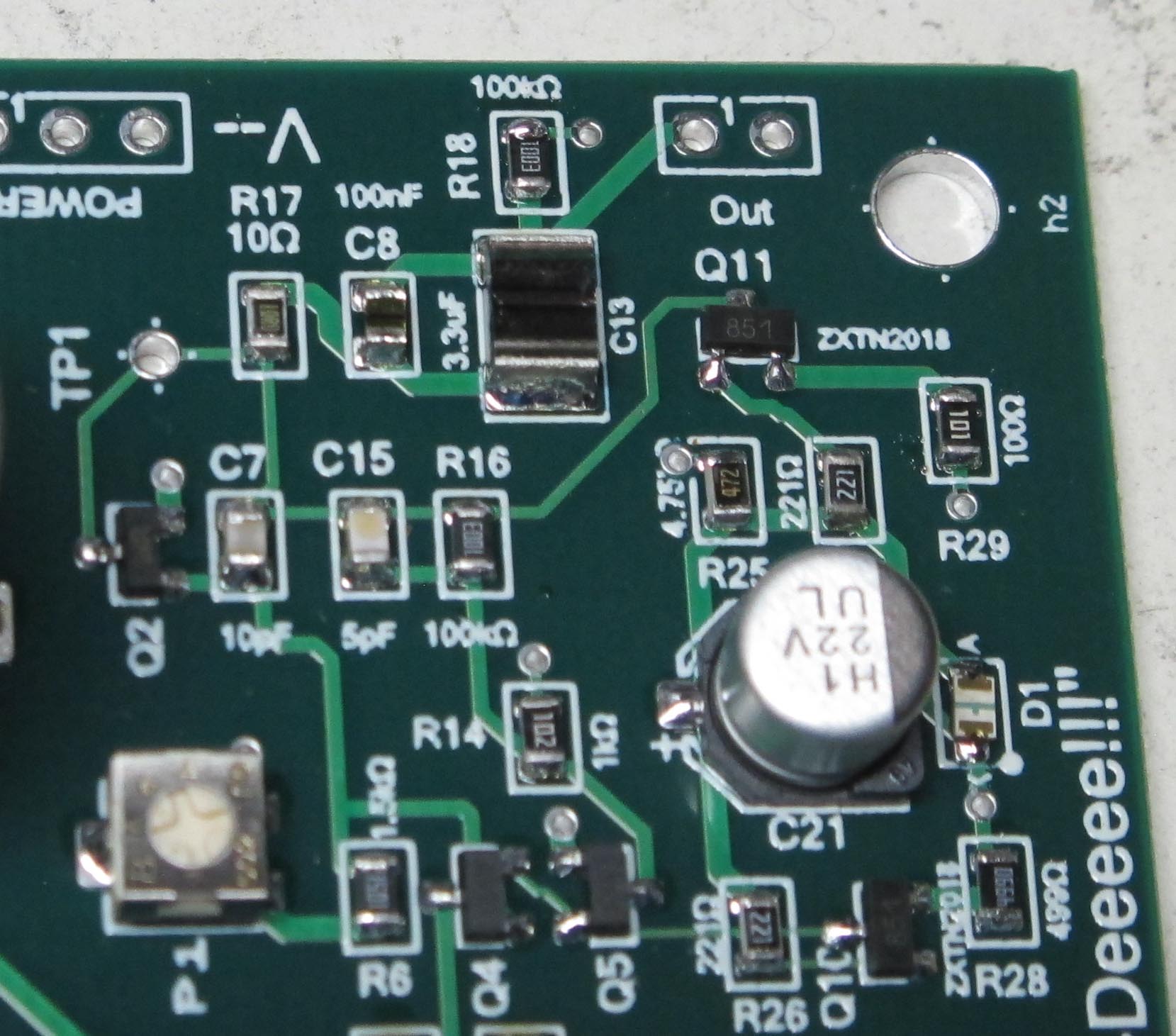

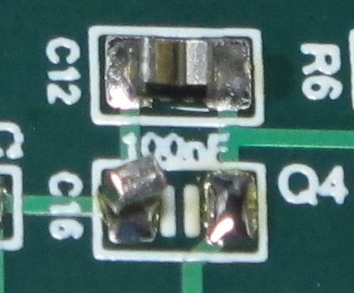

Looks like the capacitors for C16 & C12 are too small for the pad size. The causation is typically the thermal mass interactions by the component pads and track geometry pulling the capacitor to one end as the solder paste starts to flow. It can be fixed by either using the correct size capacitors or by changing the pad sizes. You can get the same effect with inadequate thermal reliefs for components that connect to a ground plane (aka Tombstoning). You can see Q11 is also slightly off centre due to dissimilar connecting track sizes.I have a "Toaster Reflow Oven" with the Controleo3 MCU. Whizoo.com Works great for SMT film capacitors most of the time, but I have found that the devices oftentimes don't like to remain seated.
