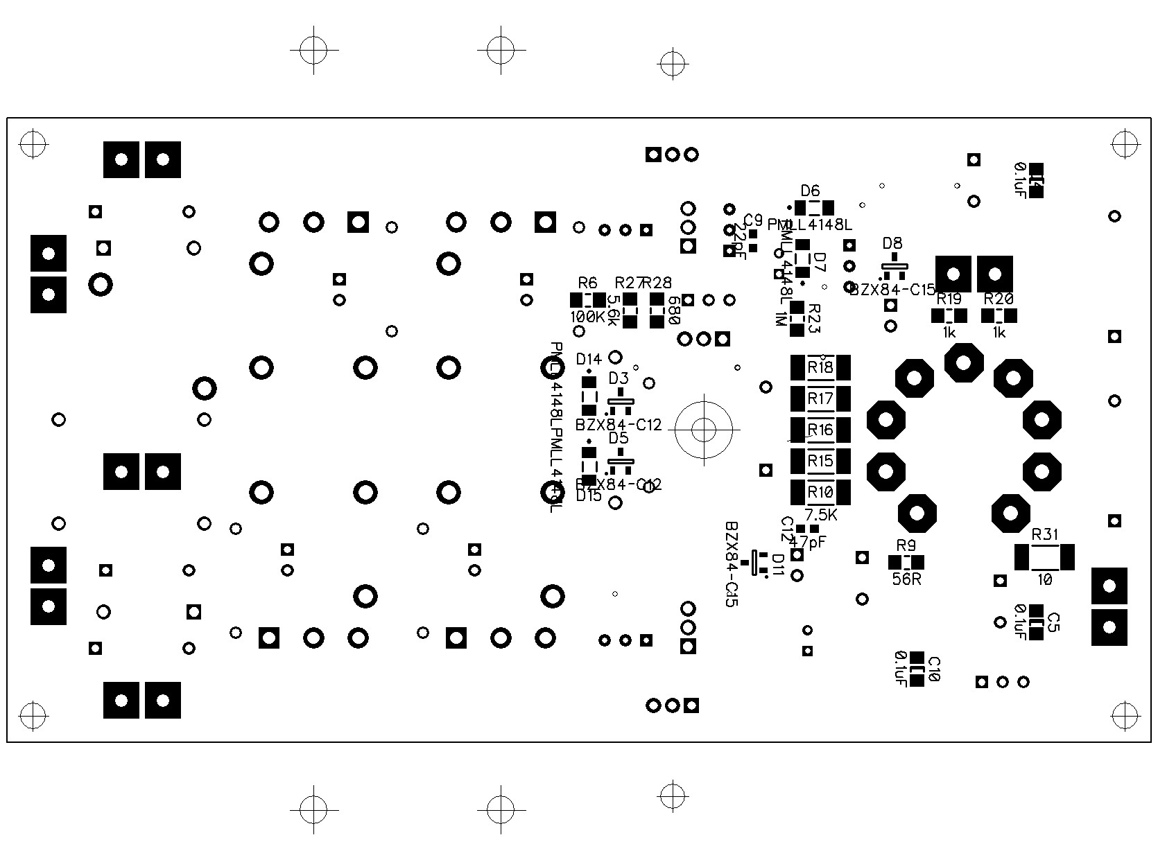

In order to fit the compact PCBs, I had to use SMD parts, placed on both sides of the board. VFAs also utilize SMD source resistors at the output pairs (5 x 1W resistors in parallel for each source).
Sorry, these PCBs are not etching-friendly, but rather easy to build as soon as they are manufactured at the workshop.

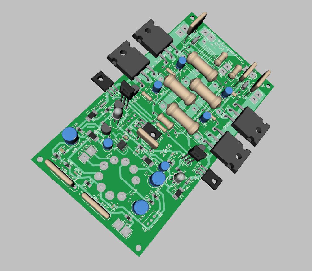

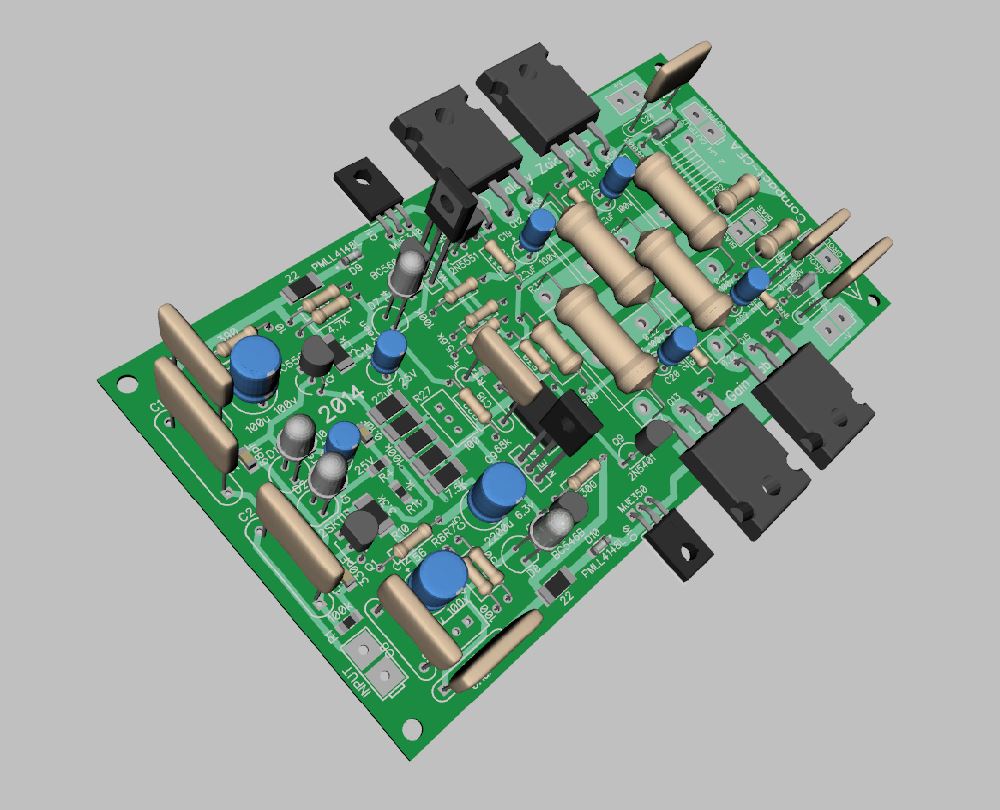

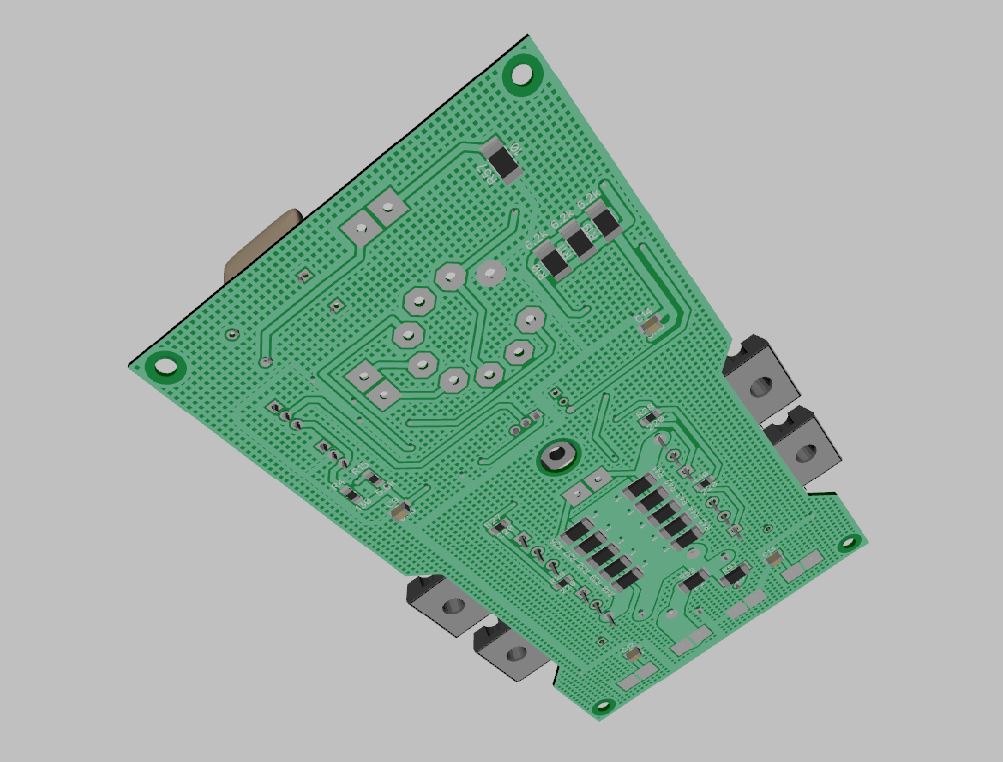

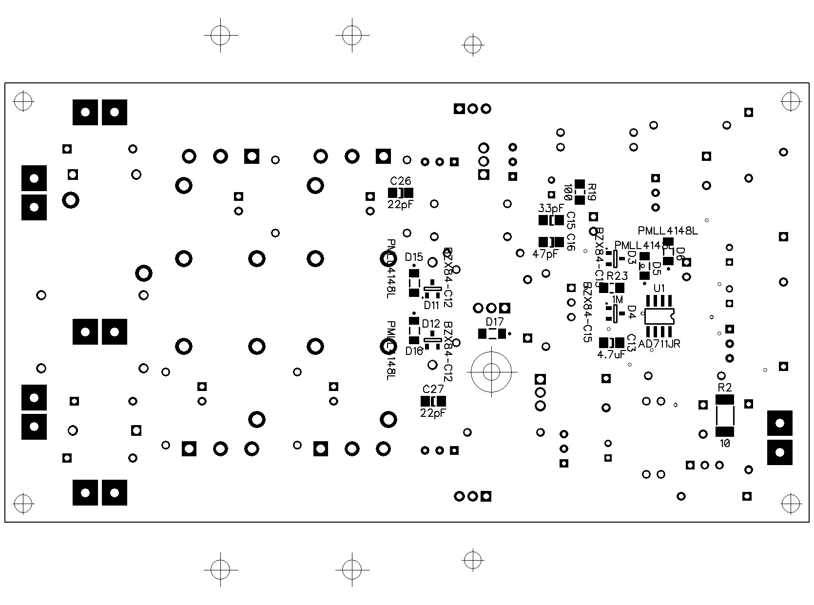

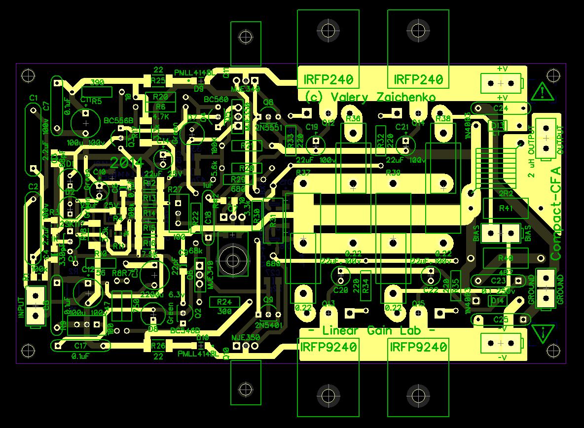

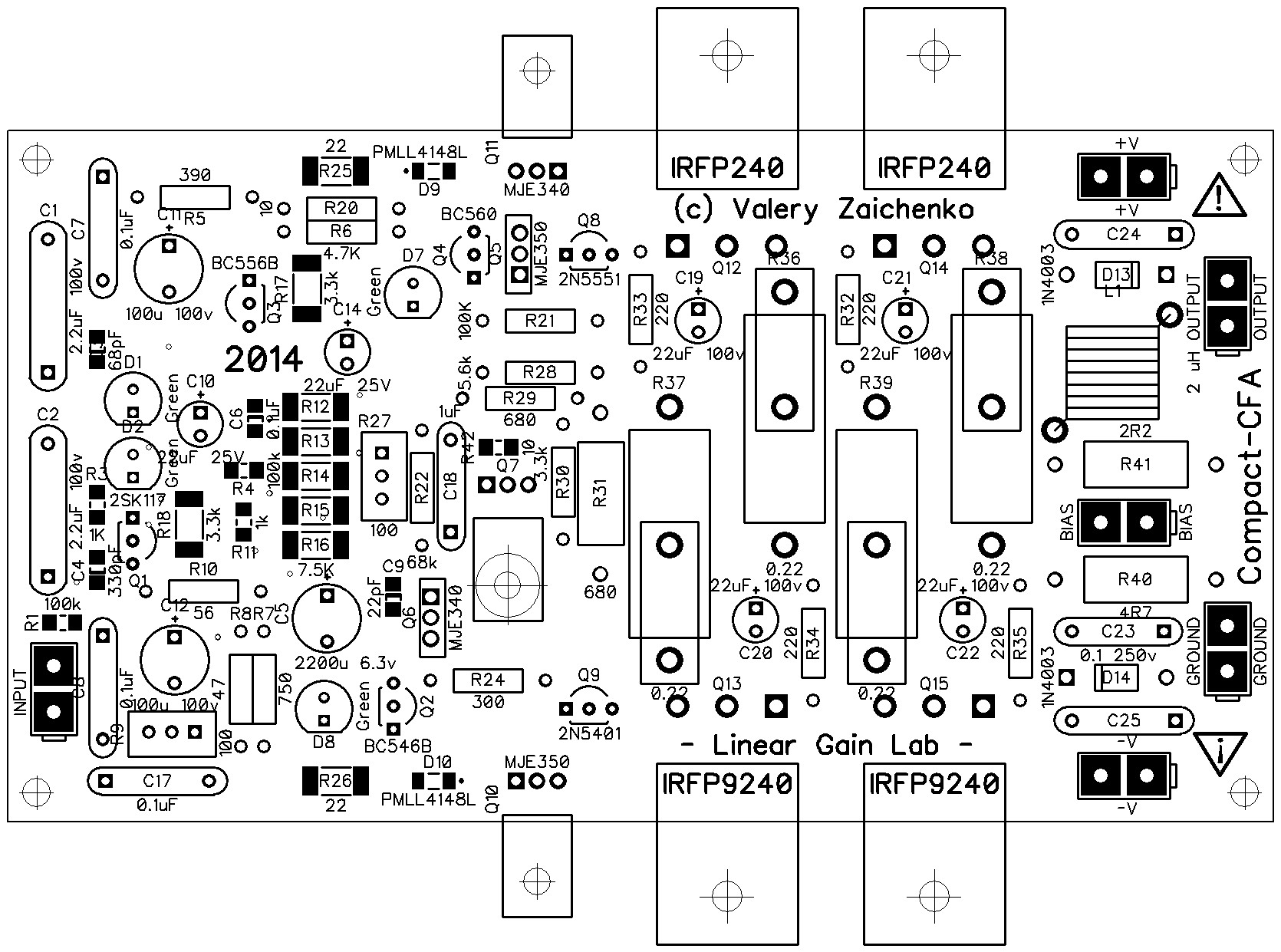

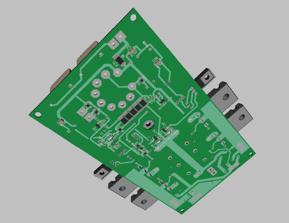

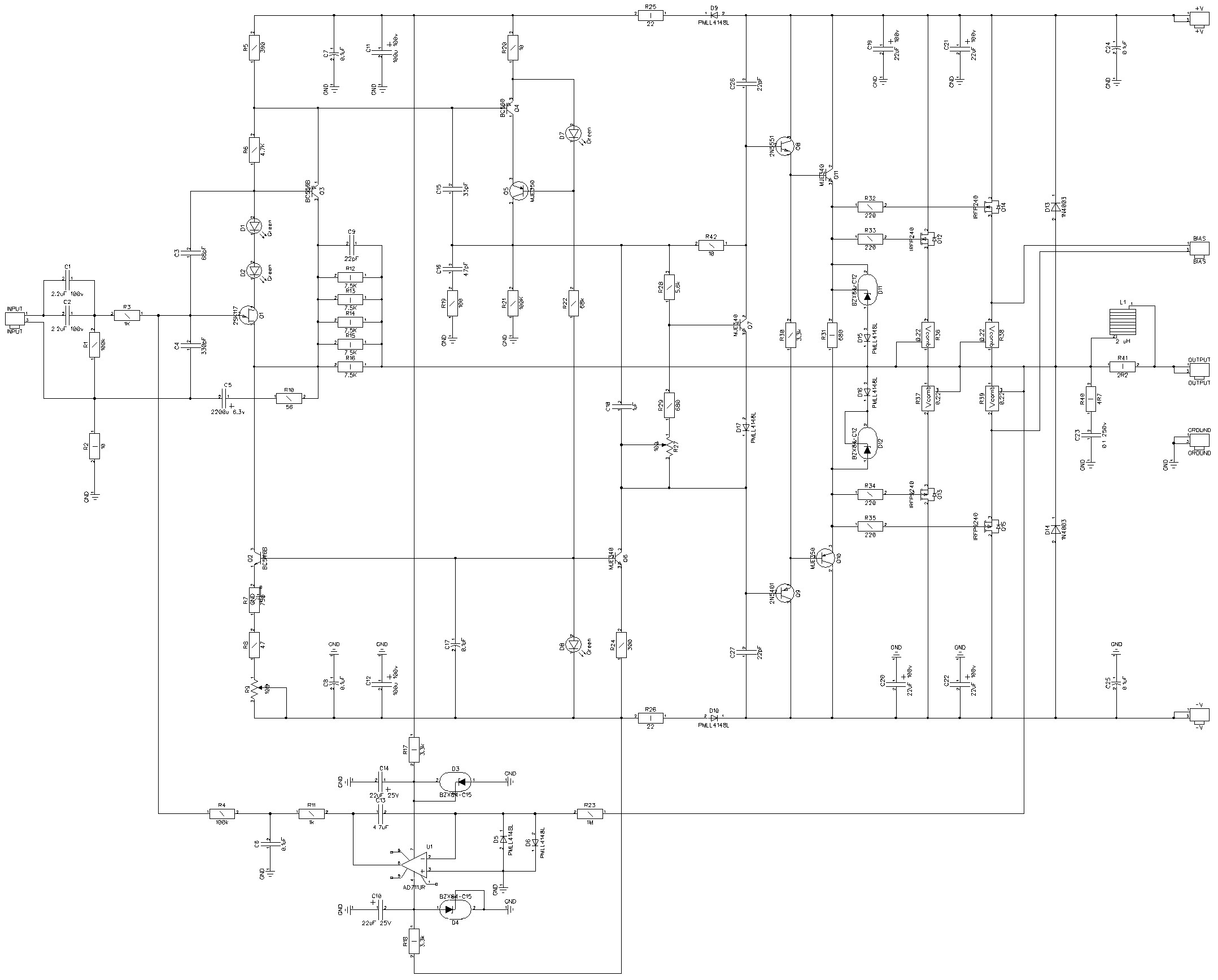

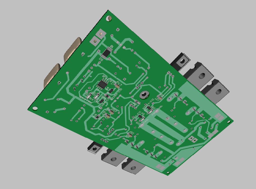

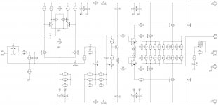

Compact CFA V1.2
Here we go.

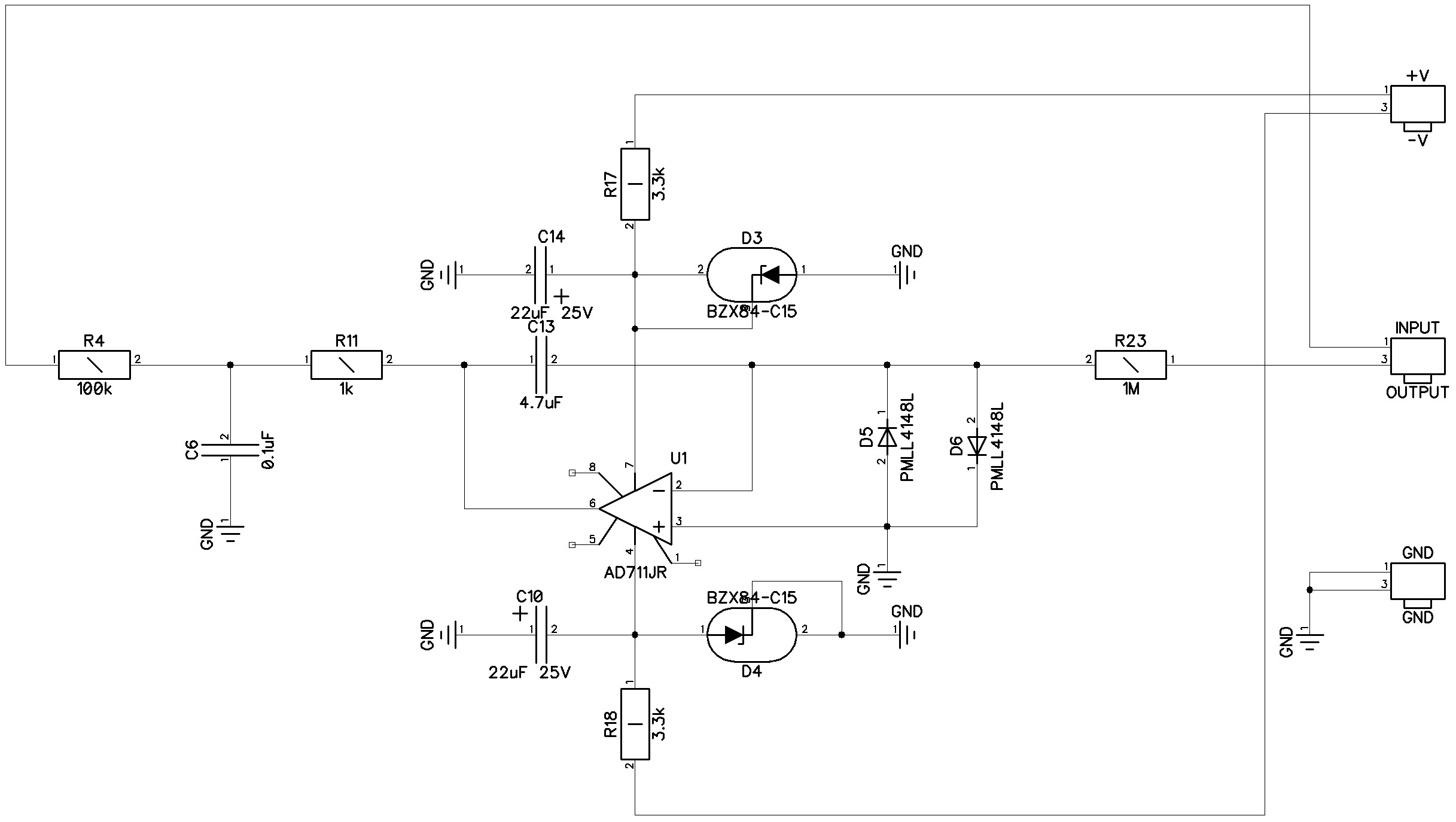

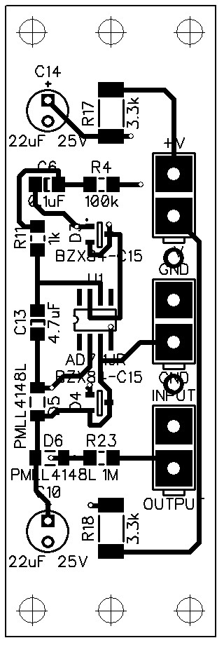

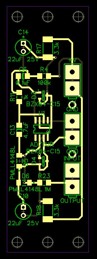

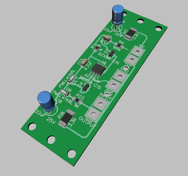

For those, who wants to add DC servo to the previously built initial version of the amp, I have designed a standalone servo that can be mounted on top of the PCB and connected to the main PCB with 5 wires (including ground).
Here we go.

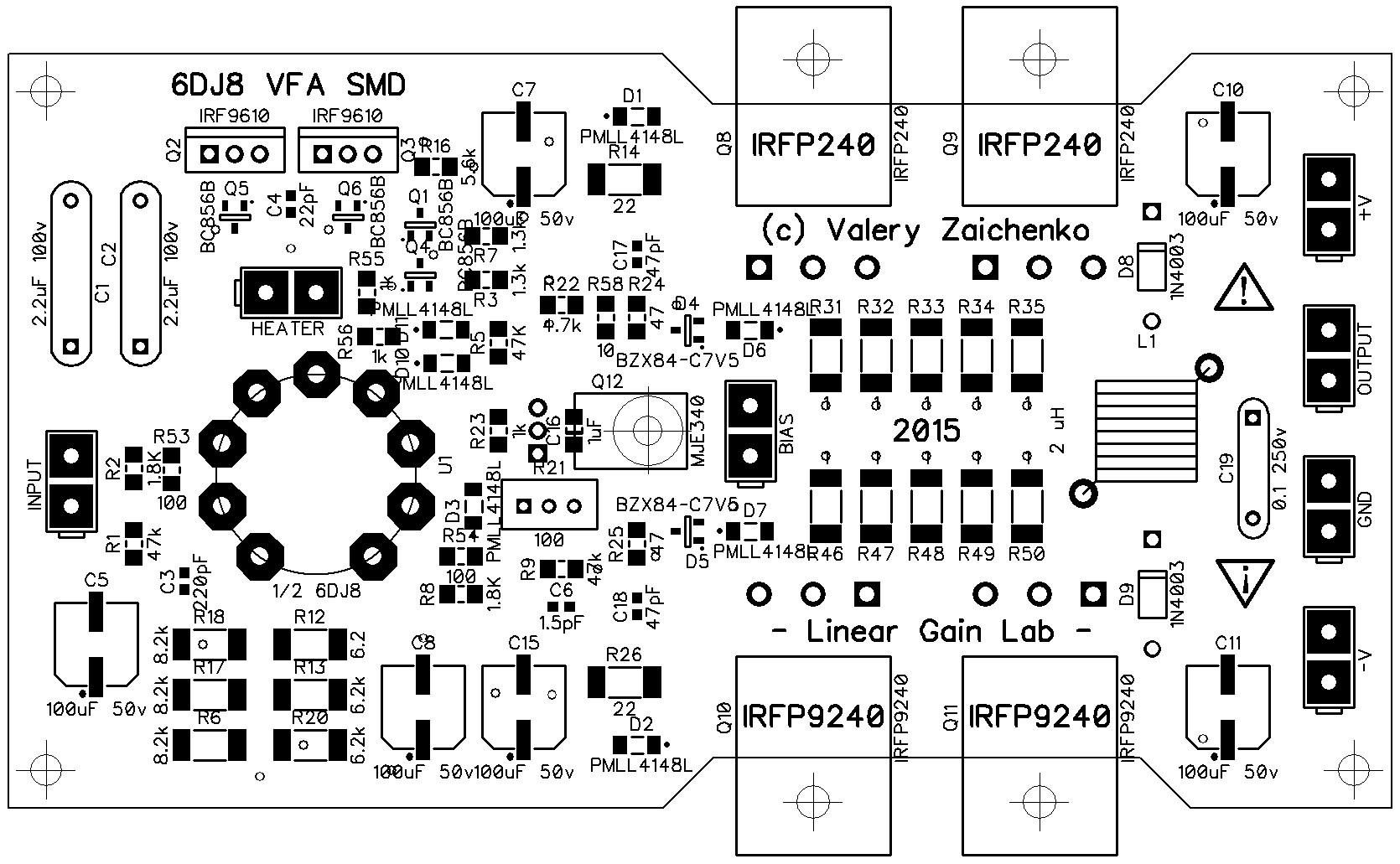

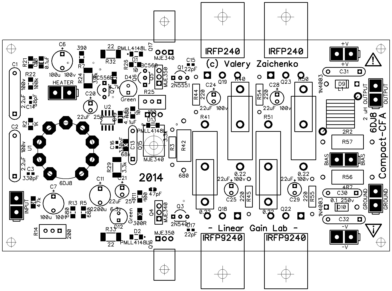

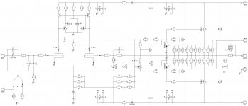

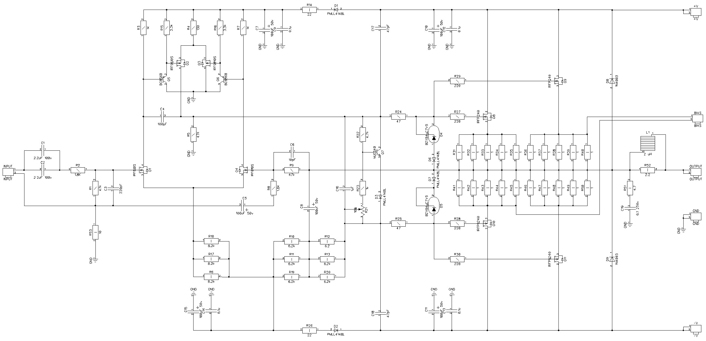

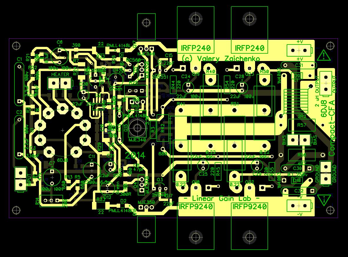

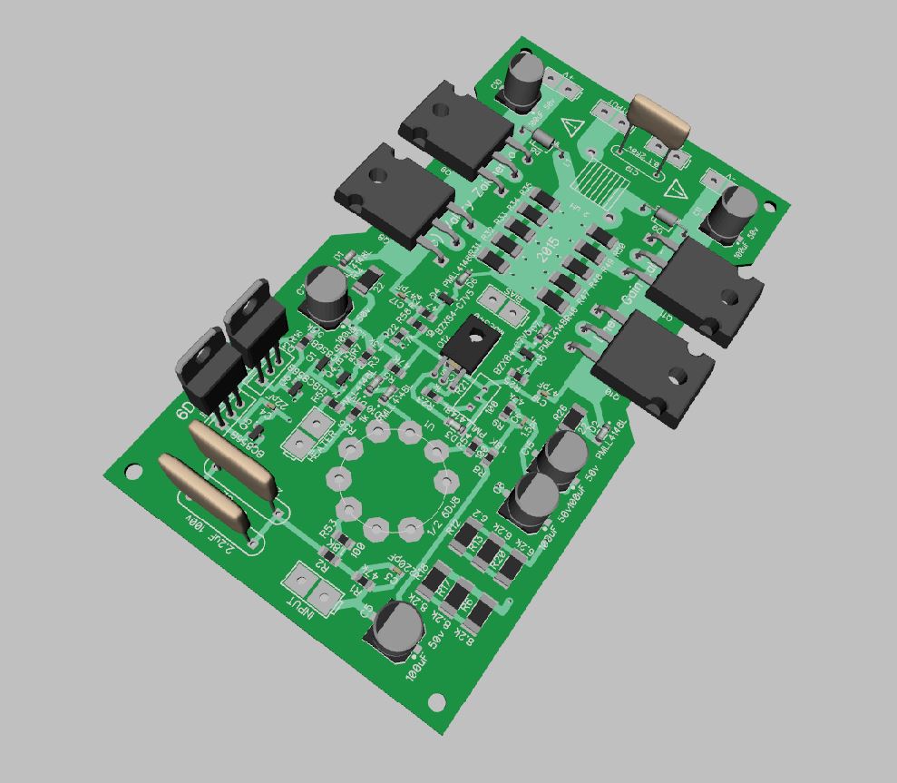

6DJ8 Compact CFA
This is a pretty interesting one. Tube-based CFA 🙄 I expect it sounding very cool 😉

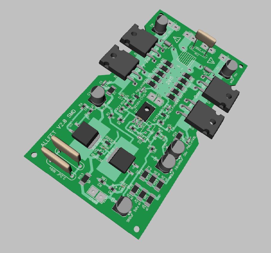

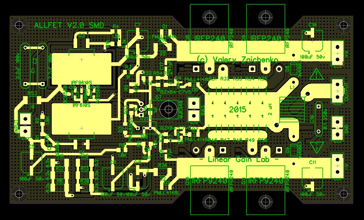

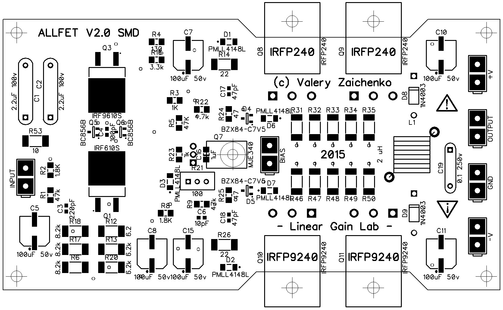

ALLFET V2.0
Initial version of the front-end was tested by me and Terry. This one is significantly improved with EFs in front of the VAS mosfets - my tests have shown dramatic linearity improvement.
Now it comes bundled with OPS, however it is easy to use just the front-end - in this case it will fit the "standard" 3 x 4 inch board, same as any other front-end in this series.
It's got 2 BJTs now, but I still call it ALLFET... well, it's FET enough 😀

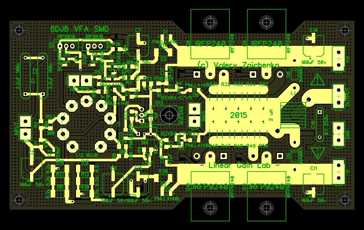

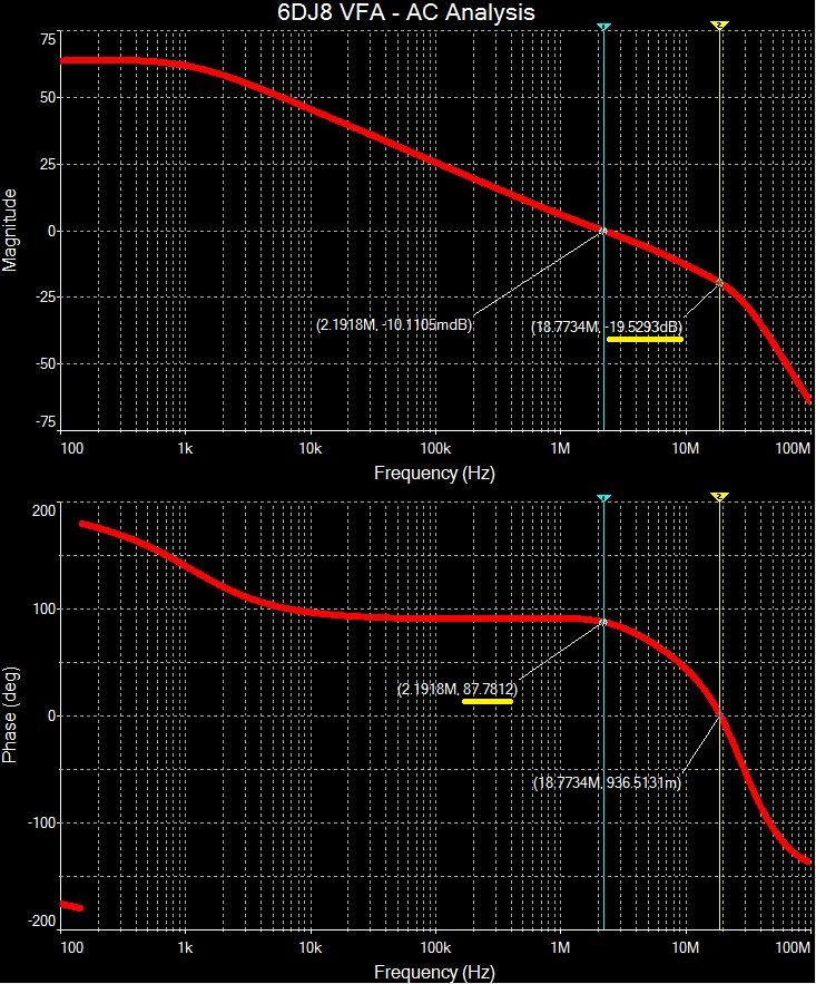

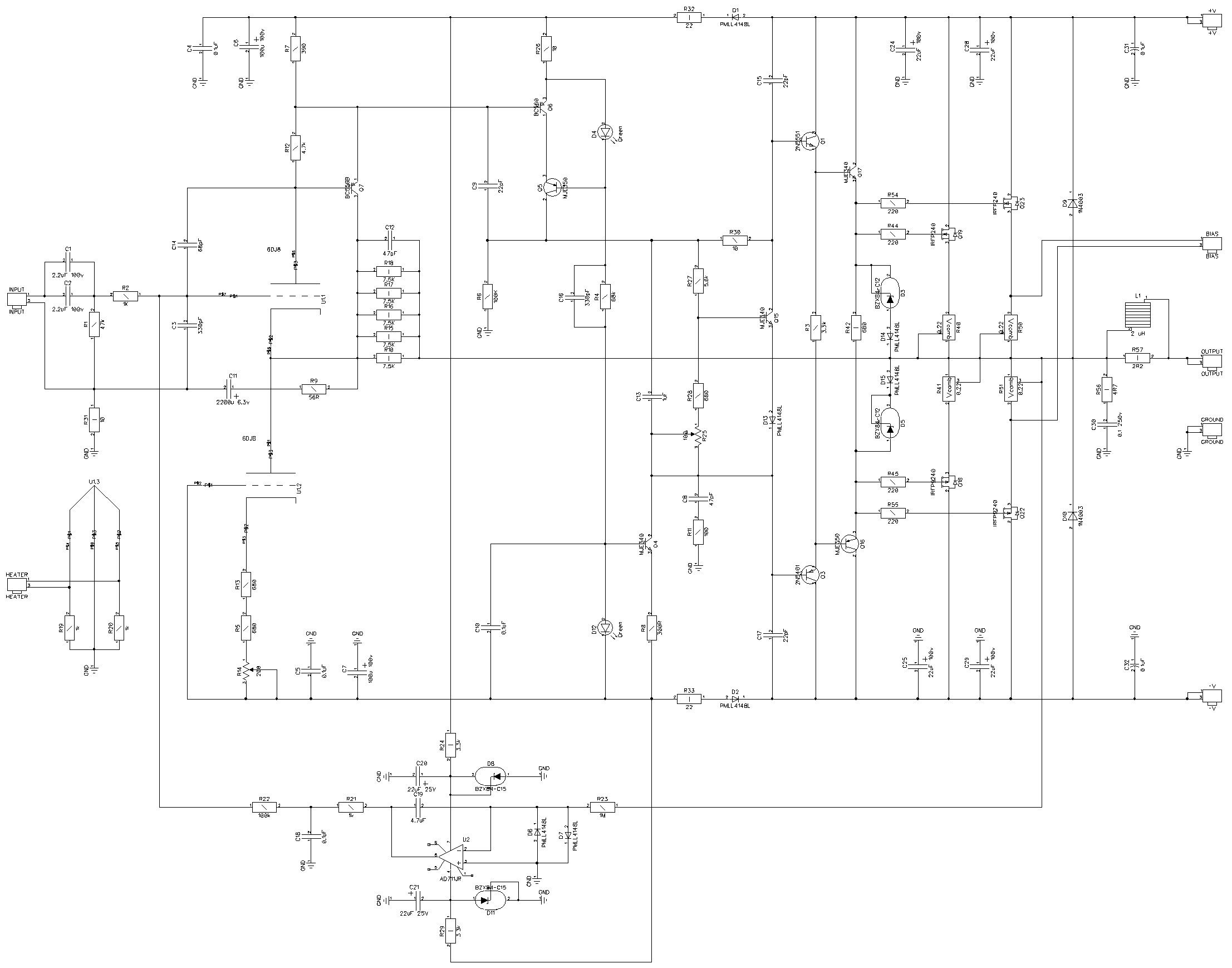

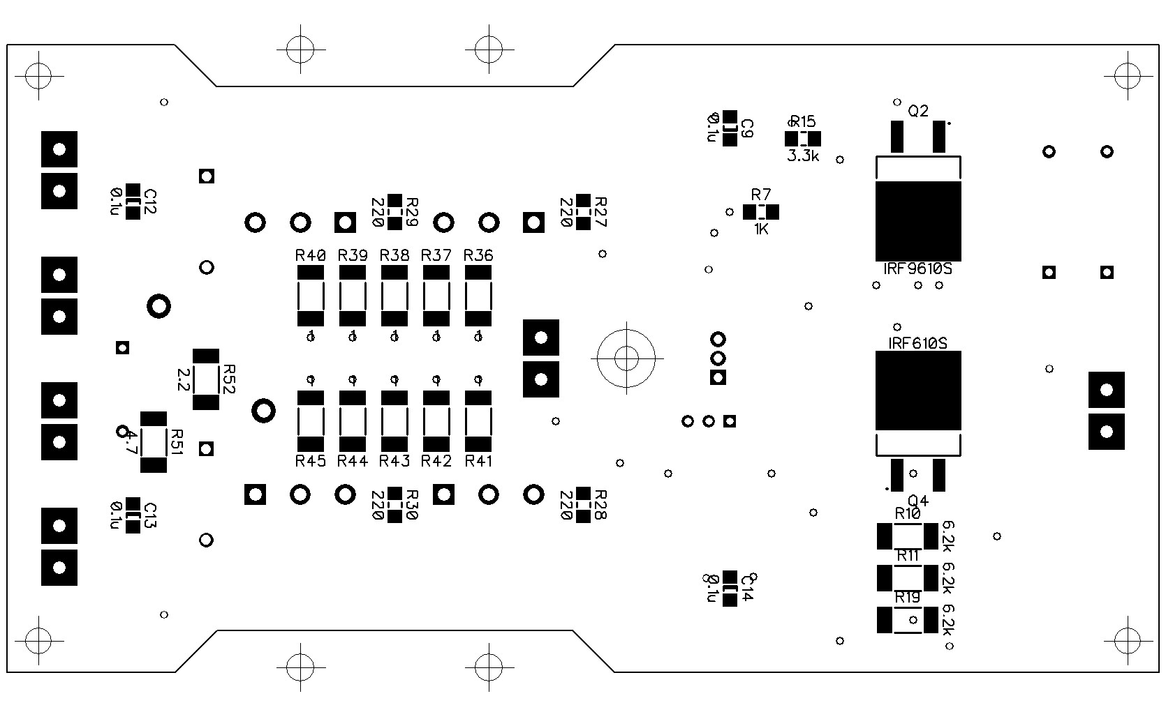

6DJ8 Compact VFA
Pretty cool balanced front-end with 6DJ8 at the input and high-current bootstrapped mosfet VAS.
I try to keep the compensation as simple and light as possible, which is especially true with this particular design.

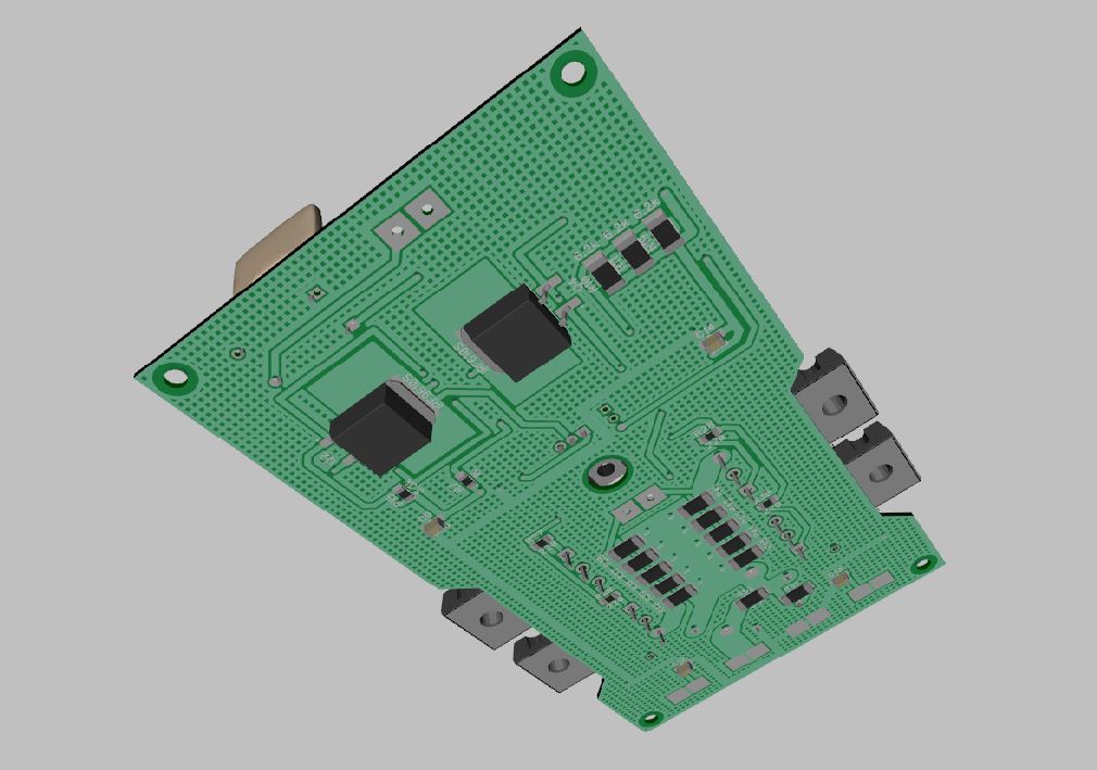

Output pairs and Vbe multiplier are shown on top of the PCB instead of hanging underneath - that's just because Diptrace cannot draw them the right way 🙂 Use your imagination 😉

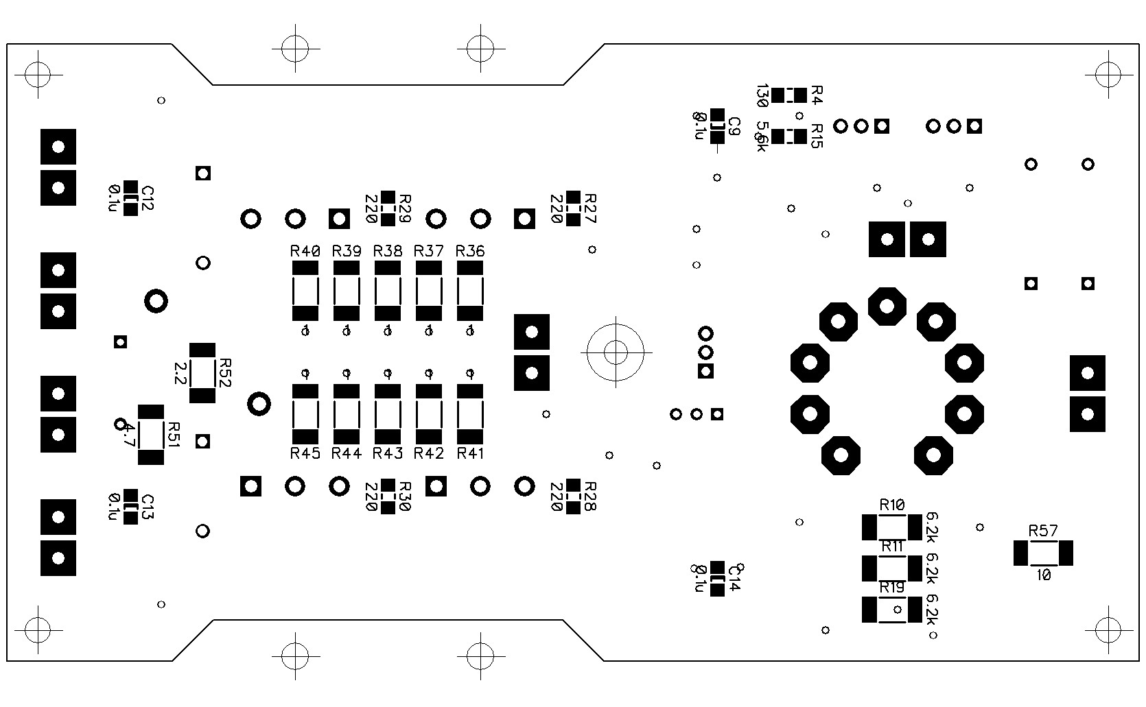

All of them are 5.5 x 3 inch = 139.7 x 76.2 mm. VFAs have got those cutouts on the sides 🙂
For 10 pieces cost is $44 except shipping cost.All of them are 5.5 x 3 inch = 139.7 x 76.2 mm. VFAs have got those cutouts on the sides 🙂
