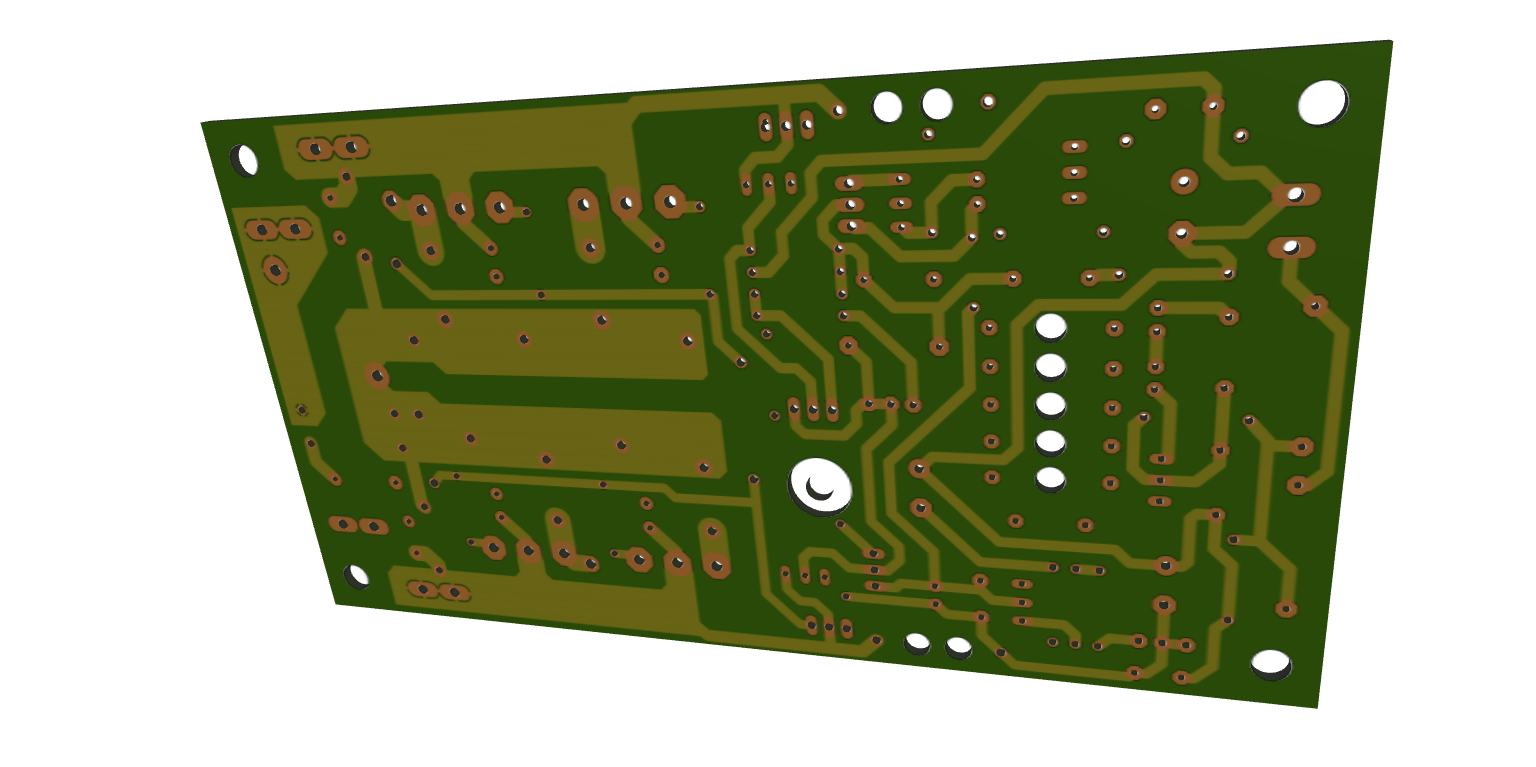

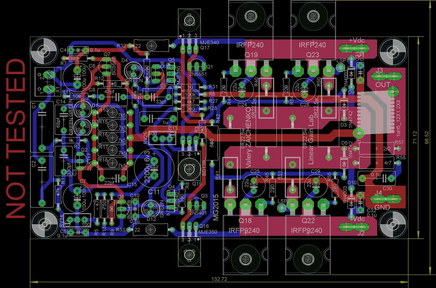

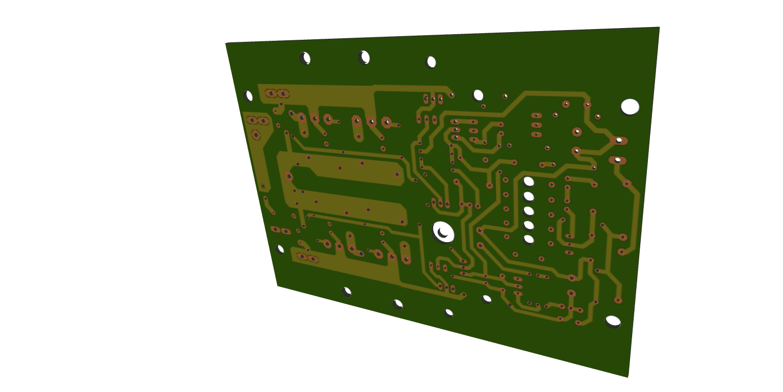

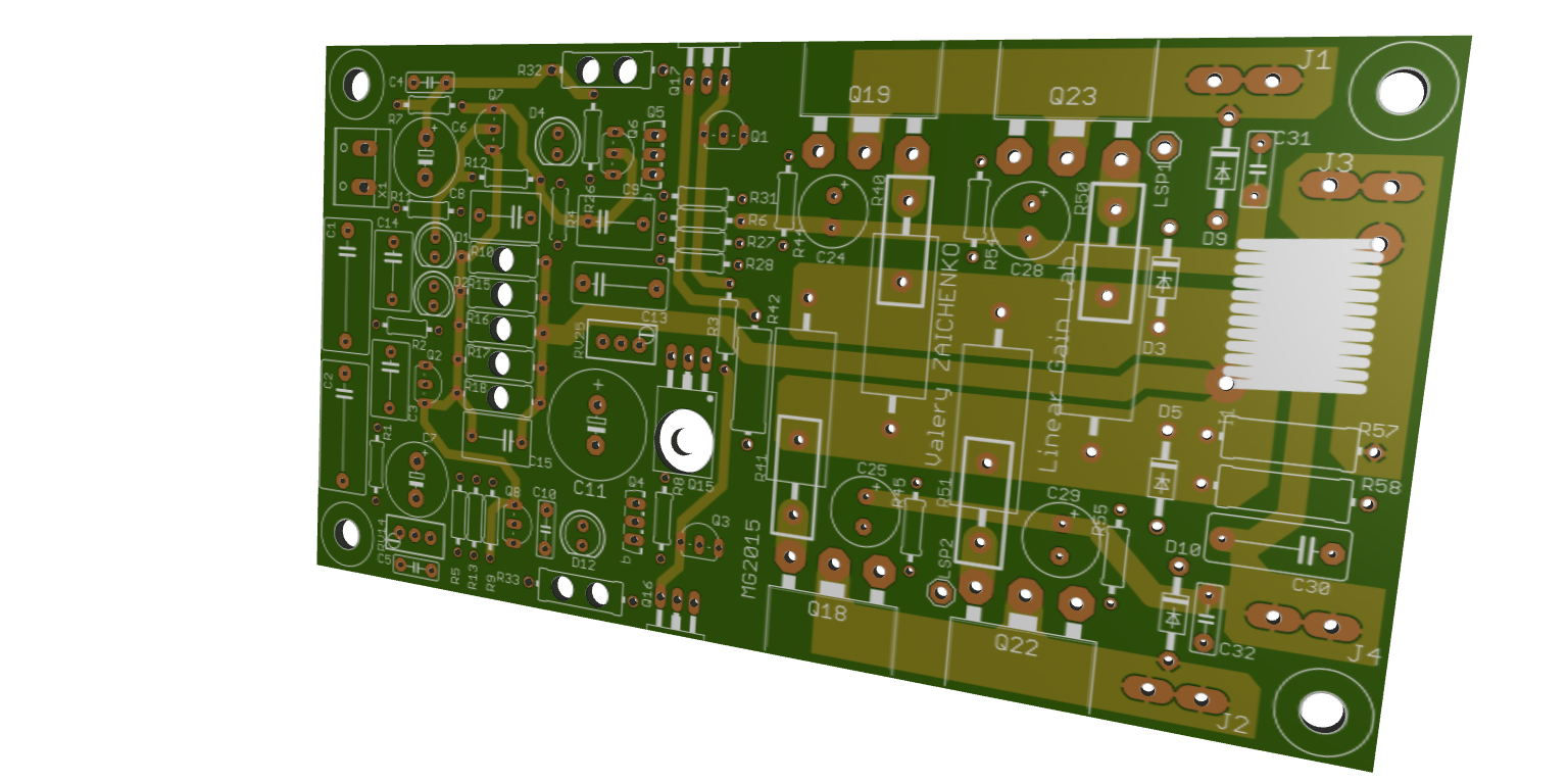

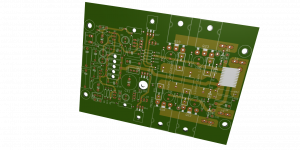

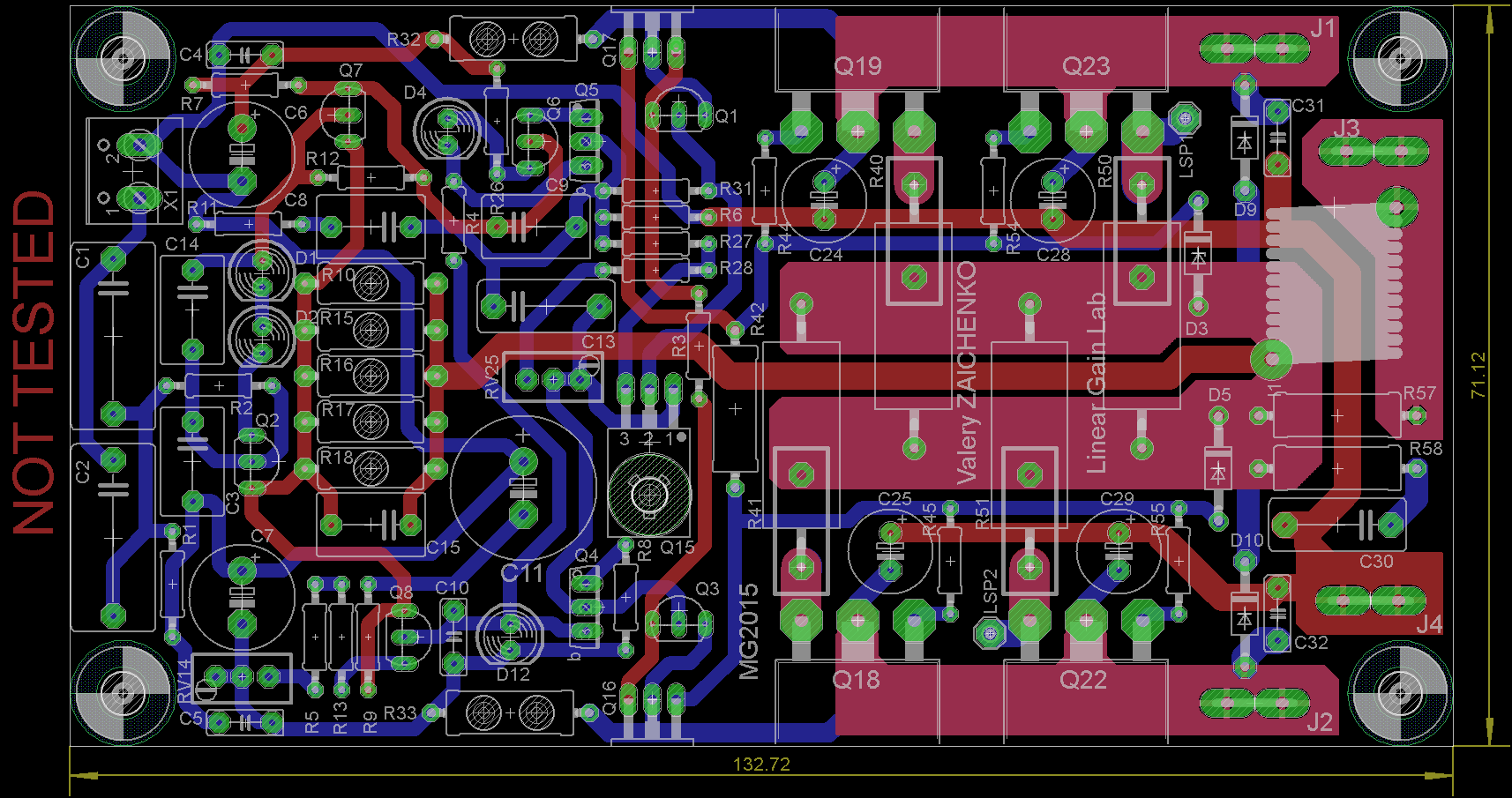

I spent a little more time for more cosmetics changes on board. These has lost 2 more mm in length but much effort has been spend to avoid layer swap on tracks

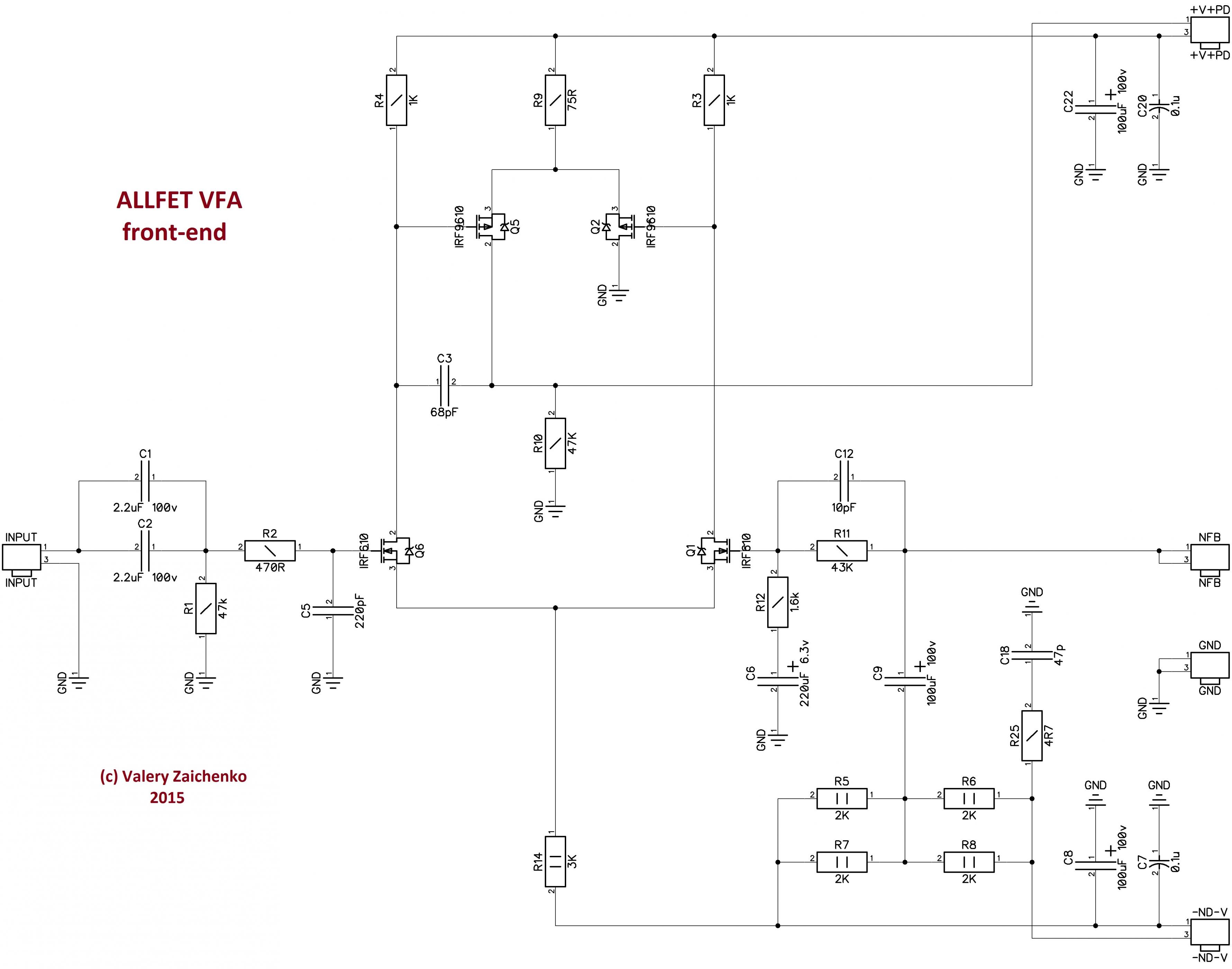

2N4338 will work here with the following adjustments (schematic from the POST#88):
R5 = 0 (jumpered);
C14 = 6.8pF
All the others from this series (4339-4341) have got too positive source potential (higher bias, especially 4341), that can be compensated by additional diode or LED in series with the source (the closer the feedback return point to zero - the better). So - possible, but requires additional testing.

So it is not Idss nor rds it is the pinch off voltage that is more important = go figure, goes to show how much I know, picked the wrong sub 🙂 thx
Well, this is a specialty of this particular "singleton" input stage arrangement 🙂
In symmetric design it wouldn't be that important...

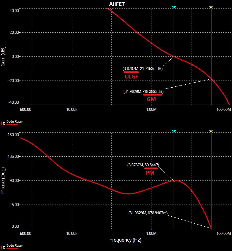

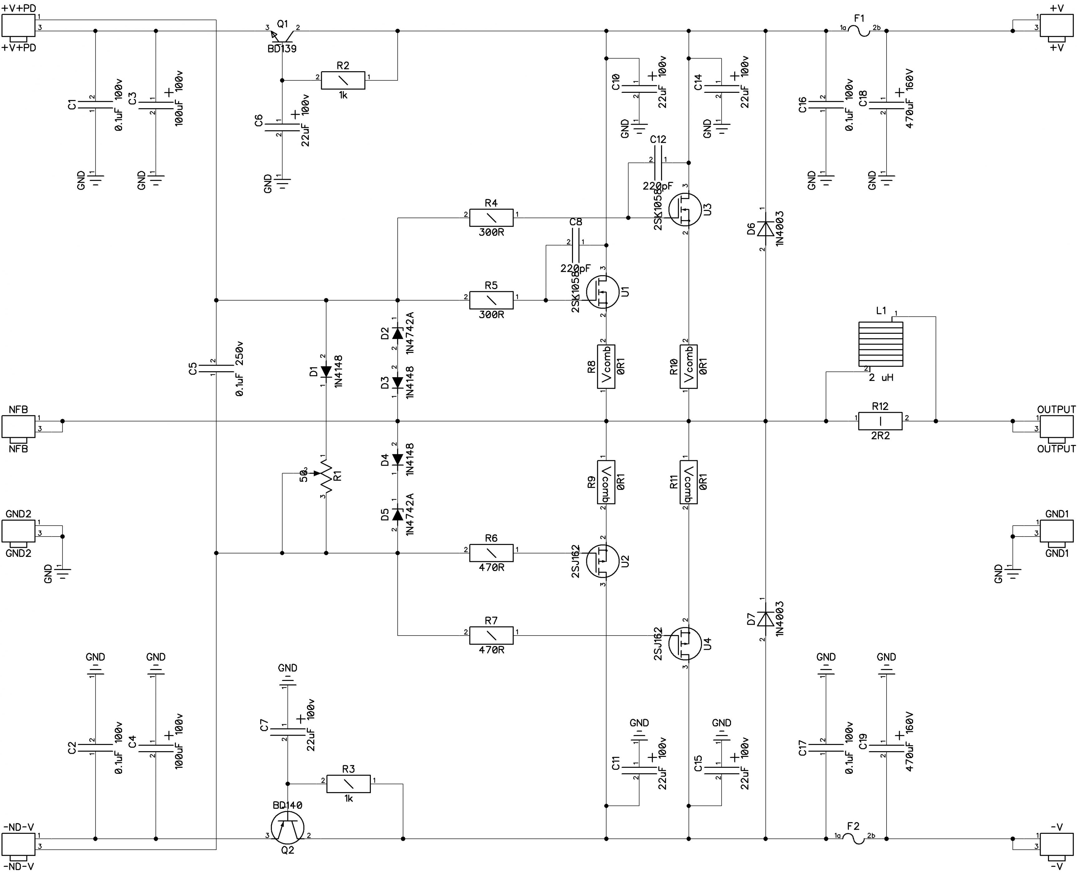

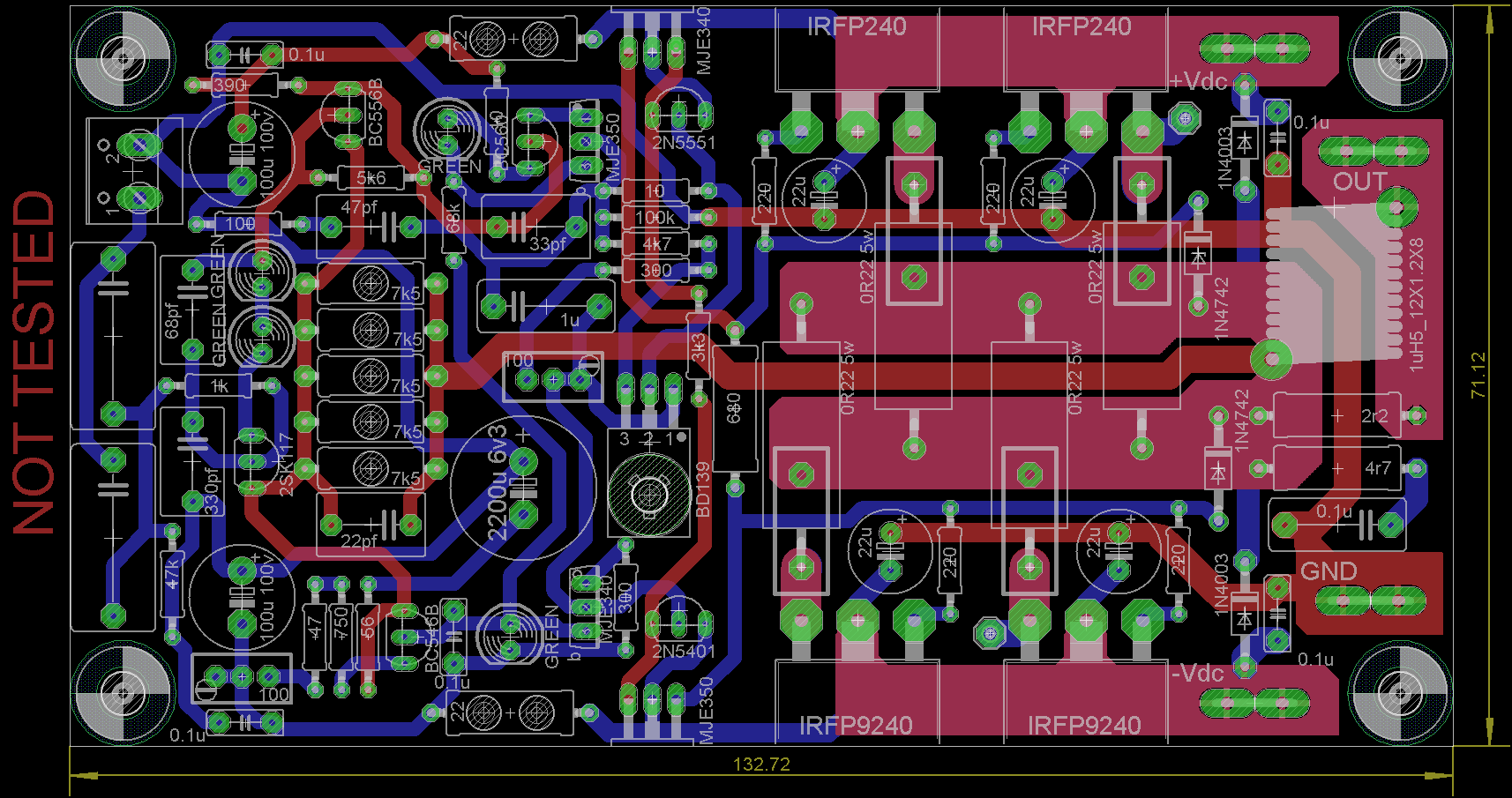

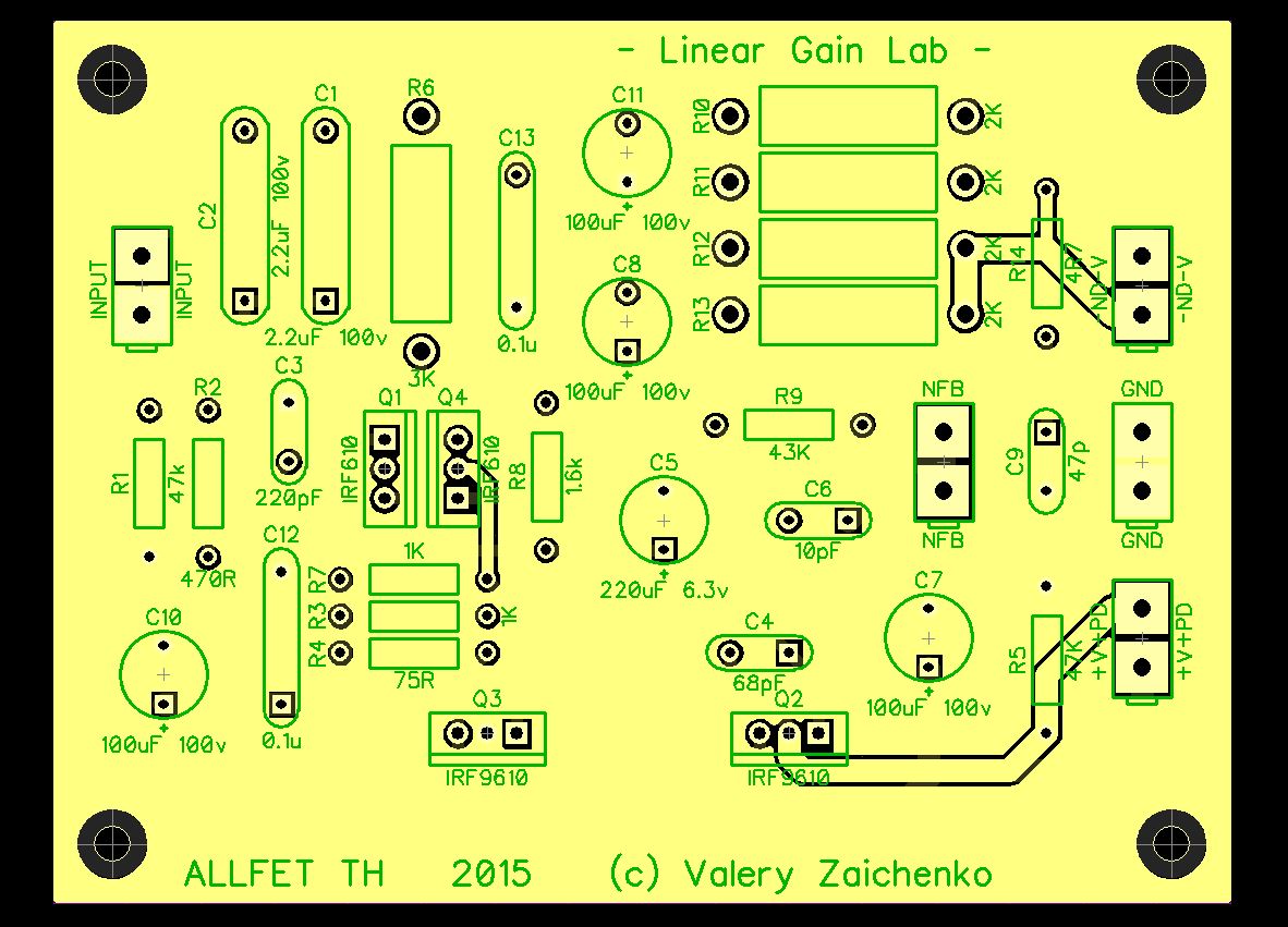

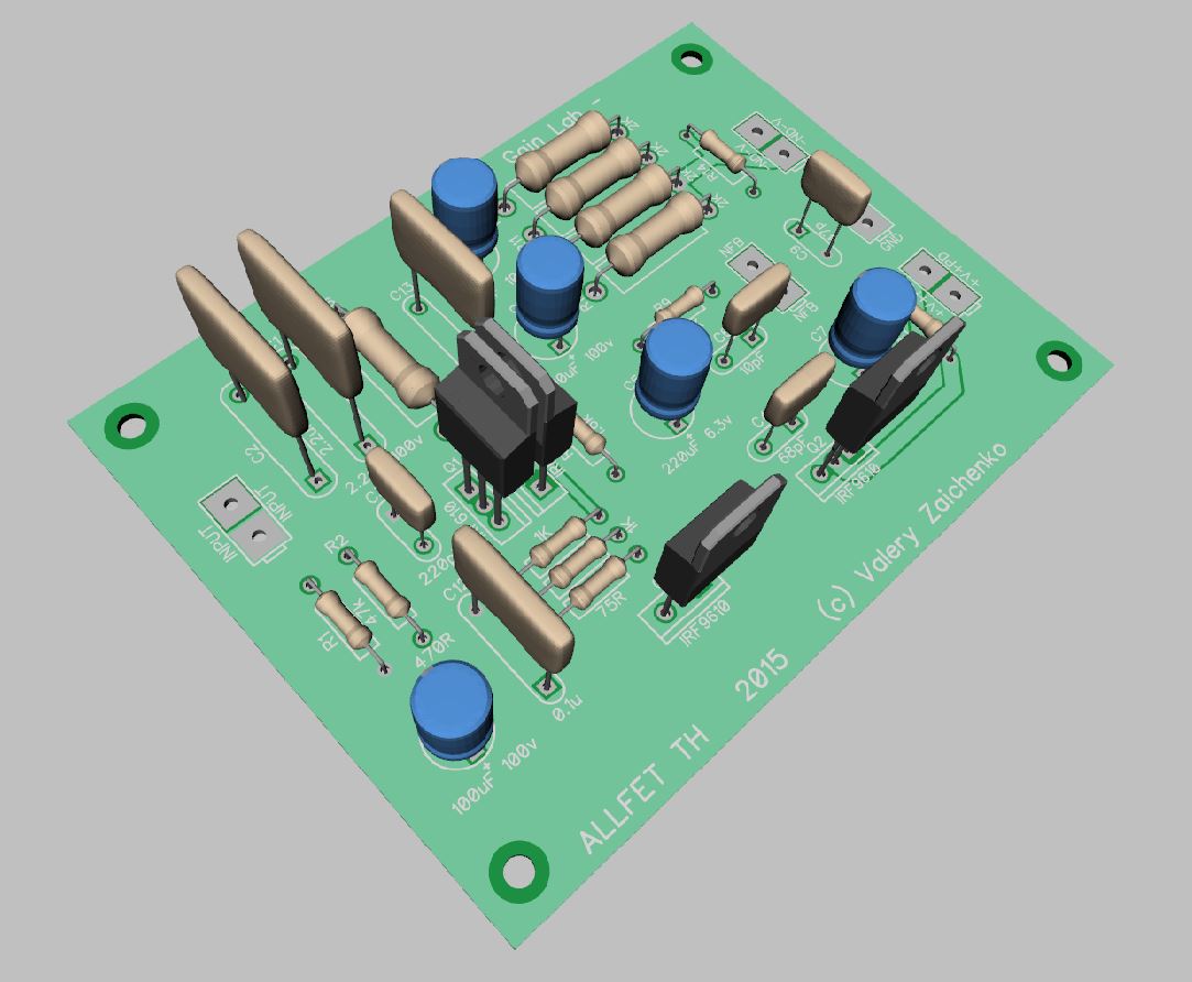

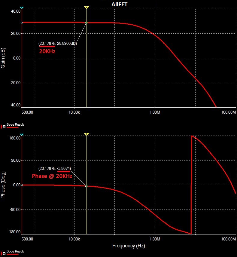

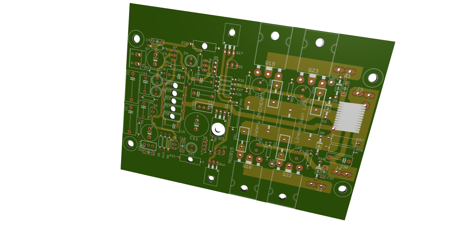

New project in the Compact VFA series. FET-o-mania 😛
4 MOSFETs, relatively high-current operation. High linearity, low distortion, good stability margins, rather simple though. Bootstrap.
Planned for using with TubSumo Lateral FET OPS (schematic is attached for your reference). Power supply voltage +/-50V.

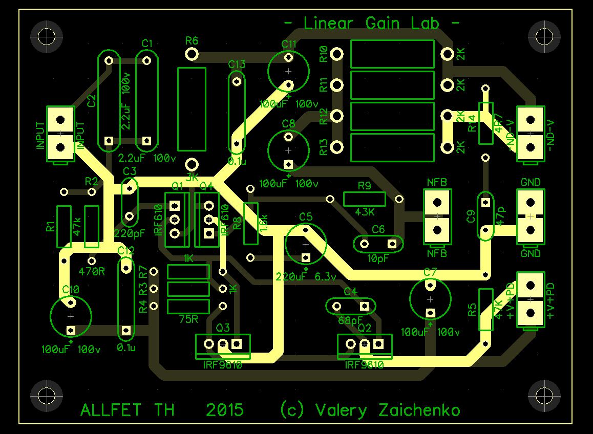

Developing a through-hole PCB for initial testing.
I am impressed, very elegant and simple. I want to build one! Please share once you have it running.
Hi Carl, yes - working on it, will let you know as soon as it's tested and measured 😉
