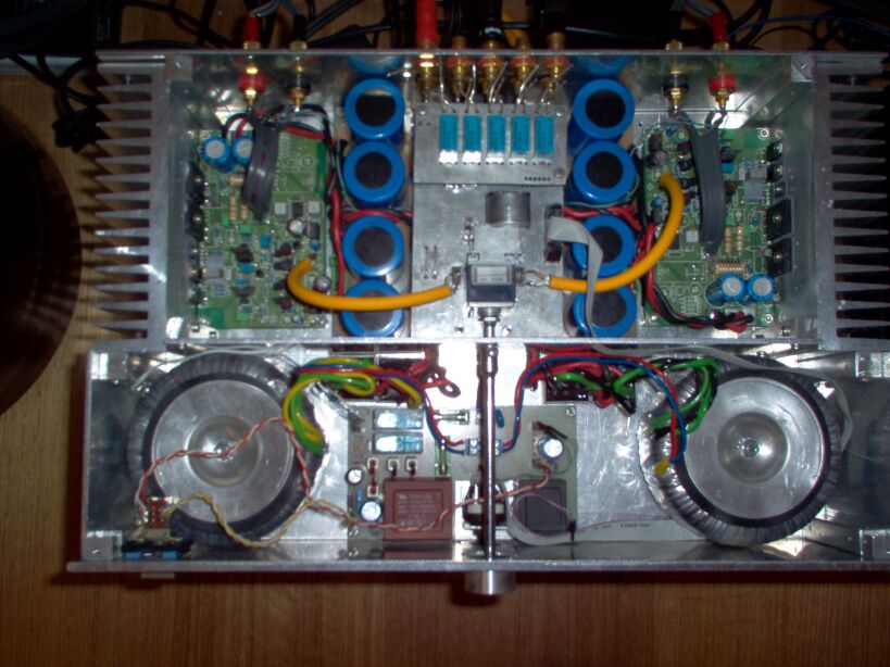

hollow_man said:
Just wanted to say that this amp, after a few mods, can trully sing - and never mind the theories...
Hollow man, please can you be a bit more specific about which modifications you made? Maybe you remember some suggestions made by Peter Jacobi in this thread , january 2004. Did you perform mods like his proposals, ore...?
Improving the thing
I will post the modifications I have done, but because they are quite a few, I will not go into detail or the reasoning behind them. Please note that I have sonically verified all of them.
OK, so here goes:
- Remove T8. Lift Gate and Source of T7 and return them shorted, via a 6K8 resistor, to the base of T4 (there is no connection to ground).
- Remove C3 and C4.
- I use a passive preamp so I have made C2 150p and shorted C1.
- R5=560R, R6=560R in series with a small resistor to equalise T3&T4 collector currents.
- Use a small breadboard design to successively match T1 to T2 and then T5 to T6. This will have the current sources and the associated components around the transistors to be matched. You can then reduce the DC servo loop gain by making R42=27K.
- Remove phase-lead networks R12/C8 and R15/C10 and replace by a short.
- Remove C12 and C13.
- C14=47n MMK
- Cut pcb tracks between R19/R20 and R22/R23 and insert ferrite beads.
- Remove R28 and C17. Insert 20K resistors from the collectors of T12 and T13 to ground.
- C15=C16=330uF/25V audio grade.
- R32=R36=150R.
- Use dual bridge rectifiers at the power supply lines, one for each polarity.
- Omit the on-board power-on delay circuitry and short the relay. Use a crowbar DC protection circuit (details are available).
- I avoid turn-on noises by a mains soft-start circuit.
Note that the phase margin is actually increased a bit.
I am attaching a picture too.
Hollow_man
