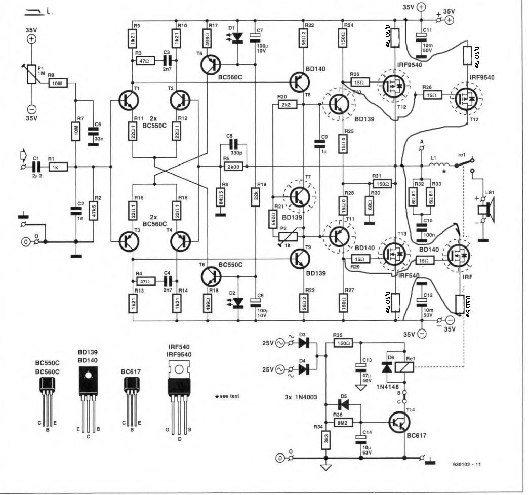

hello,
I am new on this forum and I feel completely shocked, discovering that some people simply do not understand the foundations of this compact power amplifier published by Elektor.
There is a vast litterature, including patents taken by Comlinear (National Semi), clearly showing what makes a CFB amplifier, and the associated advantages and features.
No doubt the compact power amplifier published by Elektor is a CFB one. The CFB concept is something one should learn and understand before publicly writing "this Elektor design takes a sample of the output voltage, then returns it to the inverting input, so describing a voltage feedback amplifier". This is not semantic. This is plain ignorance.
More acceptable arguments would be : "Come on, all those old preamplifiers and amplifiers dating back from before the advent of the long tailed input pair, with the global feedback applied on the emitter of the input transistor, can we say they all were CFB designs ?" "Is symmetry mandatory ?"
Apart from the CFB feature, the use of IGBTs in a complementary feedback pair (CFP) providing some voltage gain is quite unusual. However it is not the first time Elektor is publishing IGBTs in a complementary feedback pair (CFP) :
- article number #950077 (June 1995) - 90 Watt IGBT power amp (+ and -43V supply, voltage feedback, differential input, fully symmetric, no cascodes), plus an interesting appendix about IGBTs in general (June 1995 also)
- article number #960049 (March 1996) - subwoofer amplifier (+ and -49V supply, voltage feedback using an AD847 op-amp as input, two IGBTs in parallel, 245W on a 4 Ohm load)

This amplifier uses current feedback amplifier as opposed to voltage feedback.
People are confusing 'current sense feedback' (which of course is perfectly acheivable with a voltage feedback topology amplifier) with 'current feedback topology'. Two totally different things.
Having said that, I believe this amplifier is a risky design - you need to be experienced and competent to build one and sort it out.
I hate to dig up old posts again but I didn't do it this time. It is interesting to read the debate between voltage and current feedback and I don't think my input here will change anything but this is my take.
As reference I will use E.H. Nordholt's book 'Design of high performance negative feedback amplifiers'. As Jan and Marcel already alluded to, the way how the active part of the amplifier is built had no relation on the naming of the feedback (except to the marketing department of cause). When a 'current mode feedback amplifier' (purposely between quotes) is used to built a voltage amplifier, the resulting amplifier is still a voltage amplifier. The output voltage is sampled and fed back to the input thereby creating in the asymptote an amplifier with an infinite input impedance and a zero output impedance: the definition of a voltage amplifier. The so called 'open loop' (technically a wrong term) impedances of any of the in- and output ports is of no consequence, with sufficient loopgain it will create a high input and low output impedance.
Does a different kind of input stage have advantages with to respect to frequency response and compensation characteristic? Of cause it does, but that does not justify renaming a feedback topology that has been named since Blackman.

Read again Elektor schematic.
A low impedance inverting input imply a low impedance feedback
network as well, so there s MORE current running through the feedback path
than in a classical differential s FB path, leading some to deduct that
this is a current controlled amp.
If we were to follow this definition to determine what is a CFB, none of the
differentials op amp using Bjts at the input would qualify as VFB.
This latter defintion would then be restricted to the ones having fet s inputs.

For anyone still playing about with this design, here is another worthwhile improvement:
The resistors from the collectors of T12 and T13 to ground are reduced to 2K2 each, so that the feedback is reduced to 24dB (from 42dB in the original design).
This makes for a very natural, effortlessly reproduced sound with a huge soundstage. Genuine hi-end material.
For some reason I got a sudden urge to tweak my amp and I thought I could try something like this.
I have the schematic but I'd like it if someone could confirm if this reduced resistor is the R28 (10k) on the board? I can't see any others on the way to ground, but I might not be that good in reading schematics...
AND: Could I first try to reduce the value to 5k with just adding another 10k on top of the other? Would that affect the feedback some bit that I might notice? If I do this, do I also need to rebias? That is the most painful task with this amp!

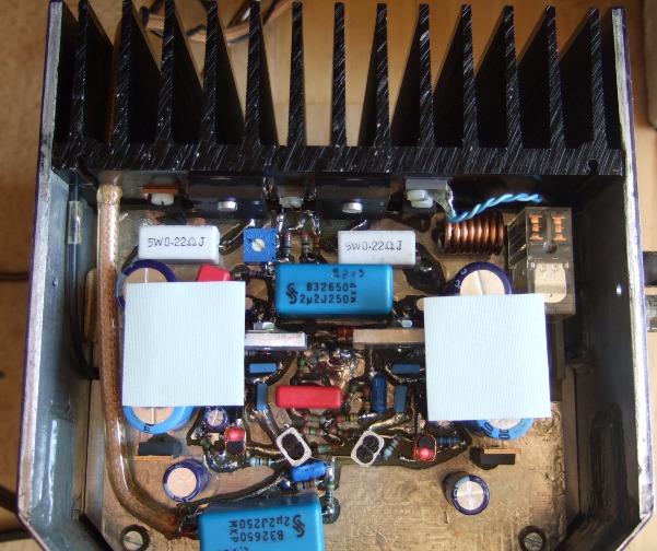

Hello , my first time here . I wanted a log-in to see the pictures people post here . 🙂
In 2001 , I made Elektor's "Compact Amp" , with no problems . I paired the transistors and made some minor changes in resistor values to keep it symetrical . The two GT20D101-201 haven't given me any problems , I keep the current at 300 mA , the output offset after all these years still at 0,1 mV like the OP177 . Remarkable noise free ! When I go listen in hifi store to some of the expensive high end amps , I hear some hissing near the tweeters .... the compact amp is dead silent . Designed the print myself . Didn't like the Elektor one . My freq counter doesn't show oscillation , so all good . One thing I don't like is , like many (Elektor) amps , the gain is far to high . Digital audio gives such a high signal that the volume on the buffer preamp is at its low end , so you clobber the audio signal down to tens of mV , just to amplify it again , which doesn't make sense. I don't know how to make the gain of the Compact Amp less WITHOUT compromising the specs. All in all , very happy with it.
:cop: Edit. Bad URL removed by moderation.
^ the two blue things are isolation pads to cool the LM's .
