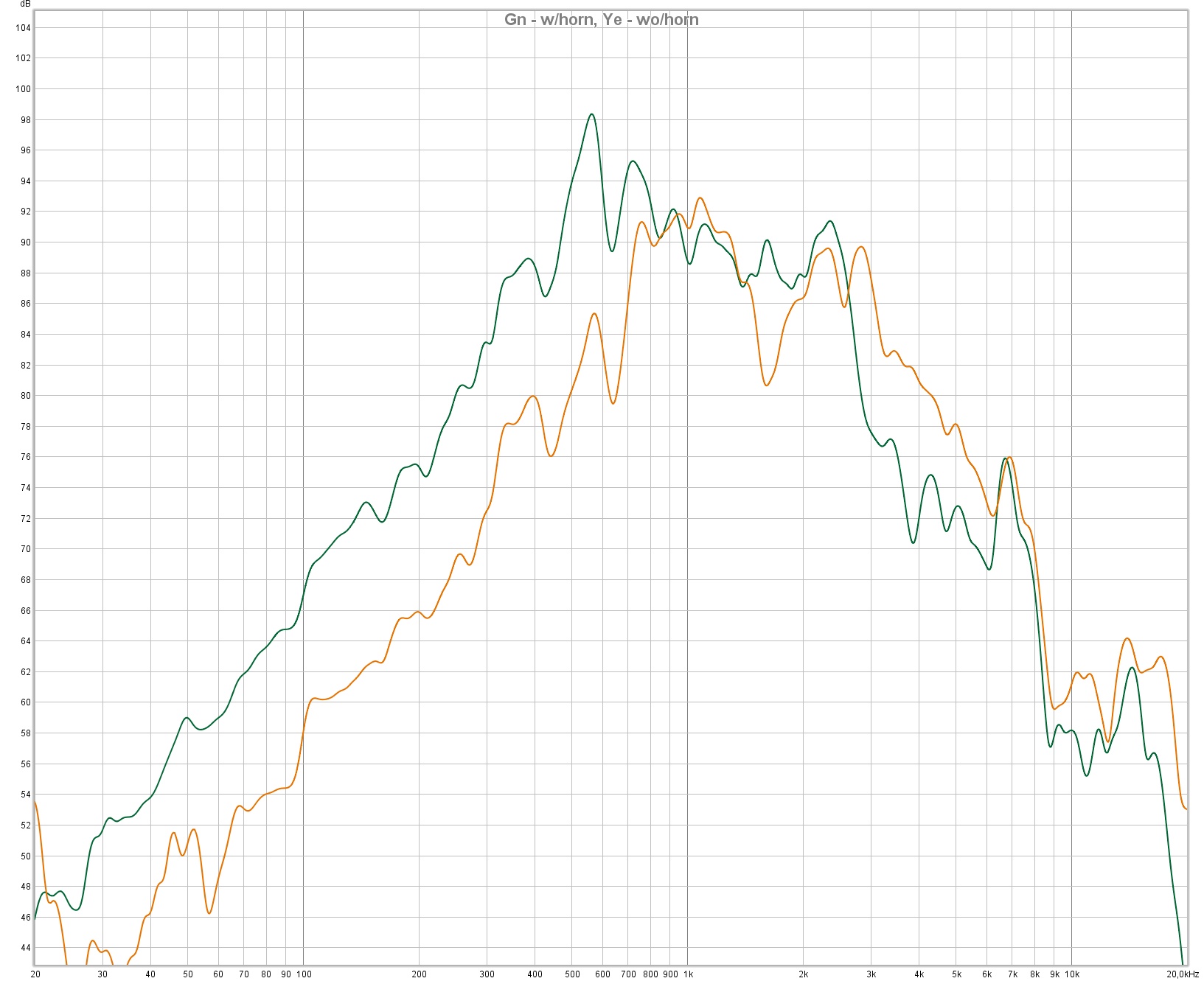

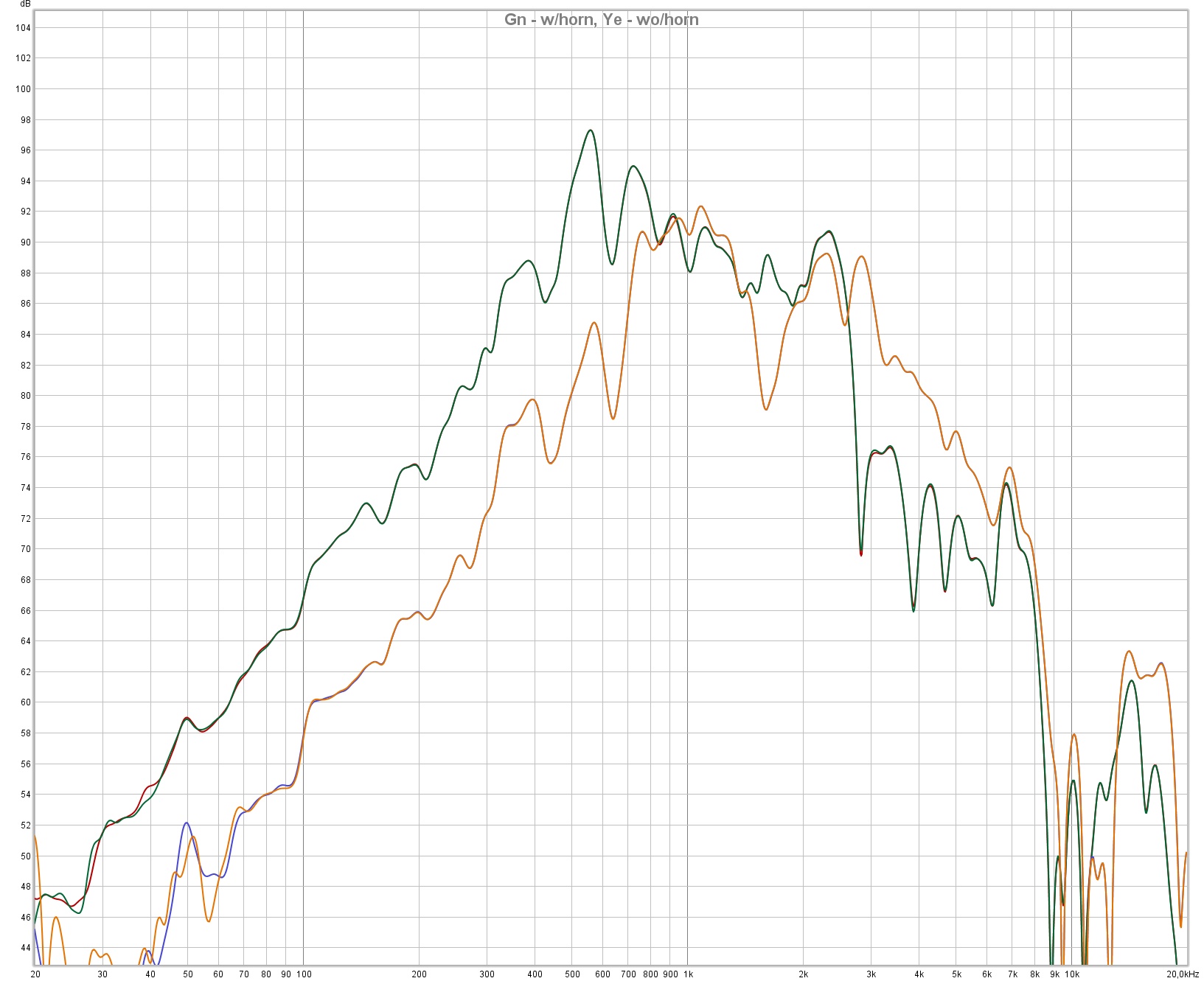

I got my hands on a pair of aluminium H6000 horns by RCF and here is some quick measurement with 8PE21 I have for another project. It is bare driver and bare driver with horn. It makes me wonder if, with a dedicated midrange driver by RCF or BC and a matching 1" horn would make a very compact "top" for the subs, sort of a split RCF 4PRO 6001.
The thing about that idea is that the 8"/H6000 combo can only be used above about 400Hz.
Your sub's will not necessarily sound very good played up that high, and there will be an obvious and unsatisfying dislocation in where the sounds of things like voices are coming from. That is, it sounds odd when the low parts of a voice are coming from down on the ground and the rest of the voice coming from up in the air, where your mid-high's should be.
So, you would still need a decent low mid section to go with the H6000+ HF, making a bigger and heavier top cabinet.
