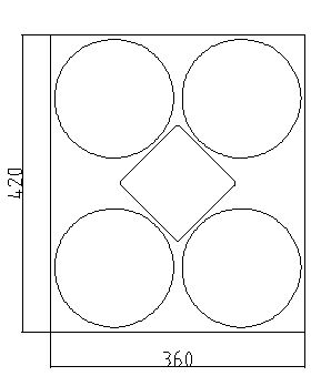

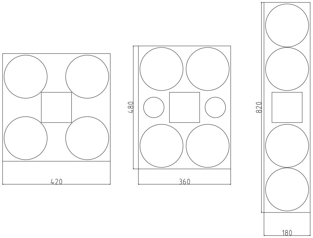

Below is a sketch of the front baffle options with a small 70*70 waveguide mentioned before, it is usable down to 2 kHz (if I interpret the linked measurements correctly) and better be crossed over at 2.5 kHz. Visually, I like the middle one the most.
Narrowing starts where the wavelength is less then the (effective) width of a driver. Wavelength calculator

Edit: The waveguide is round, so if rotated, it can be squeezed a little bit more.
I found out I need to use the 4 ohm version anyway. It has a Qts of 0.41 while the 8 ohm has 0.67. I should get away with a 20 - 30 l closed box crossed over at 150 Hz to the RCF sub(s).
I had a play with the edge baffle designer and this arrangement. In the horizontal plane @2kHz you get around 53 degrees and at 2.5kHz 40 degrees. For 70 degrees match to the horn the crossover would have to be about 1.4 kHz which this horn isn't loading down to which wouldn't be possible with this horn. Everything is a compromise though so perhaps a 2kHz crossover with steep filters would work OK?
To get the drivers closer together is one of the reasons that asymmetric coverage pattern horns and a vertical arrangement are normally used 🙂
